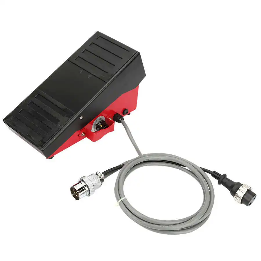

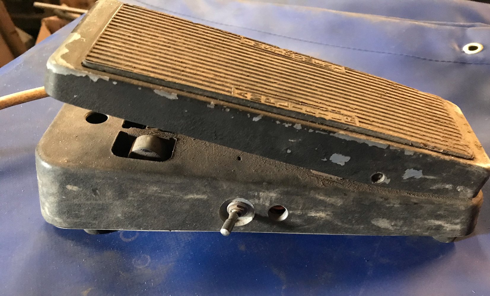

^ this!SSC there’s no point wasting time on anything rlse
They're really well made, super smooth, and sold at a decent price by the UK importer R-tech.

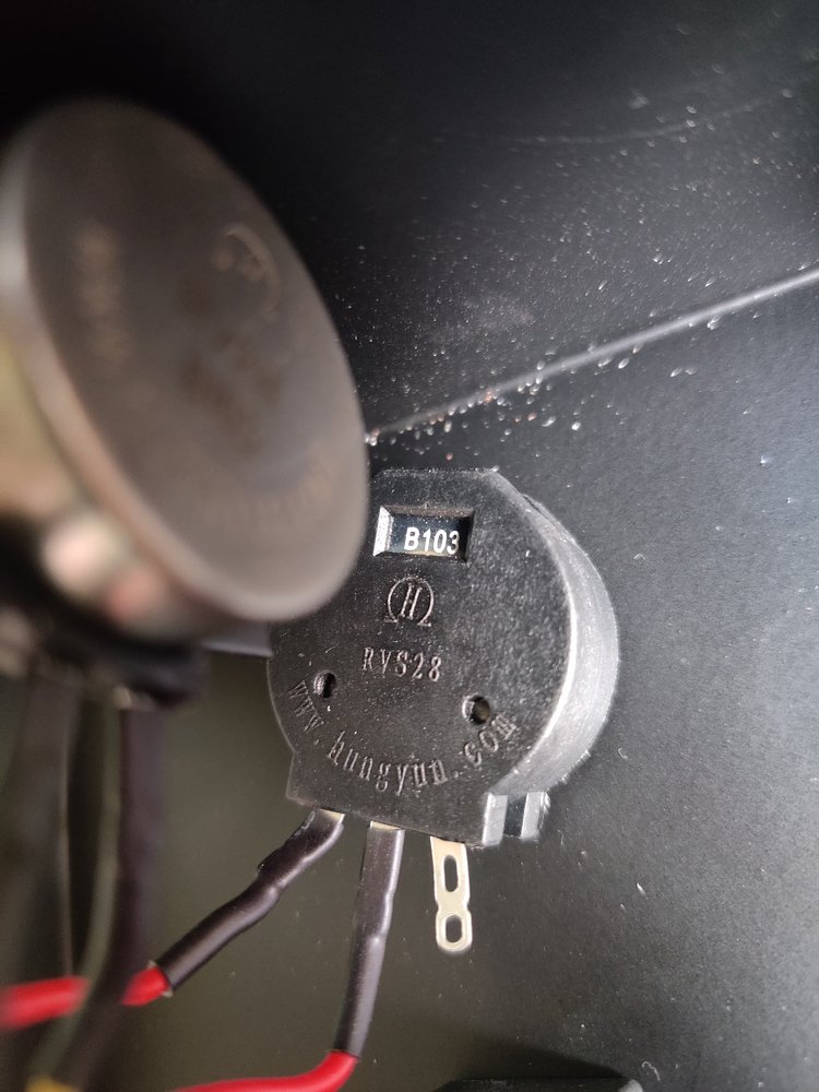

They're all very similar with different value pots and plugs, usually 5 wires (2 for a switch and 3 for a pot). if you asked SCC USA about what you need, they might be able to point you to an existing stock model where you cut the plug off and re-plug it for your own machine.
Not sure if they do models with the 2nd pot on or not. But that's an easy thing to add in if needed.

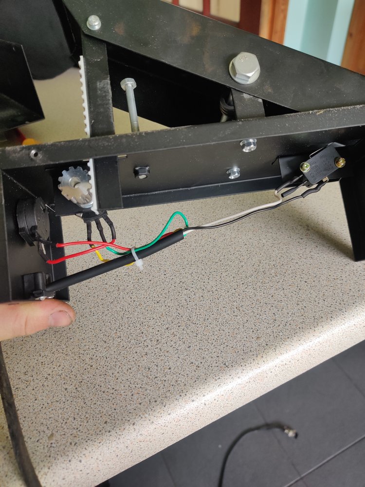

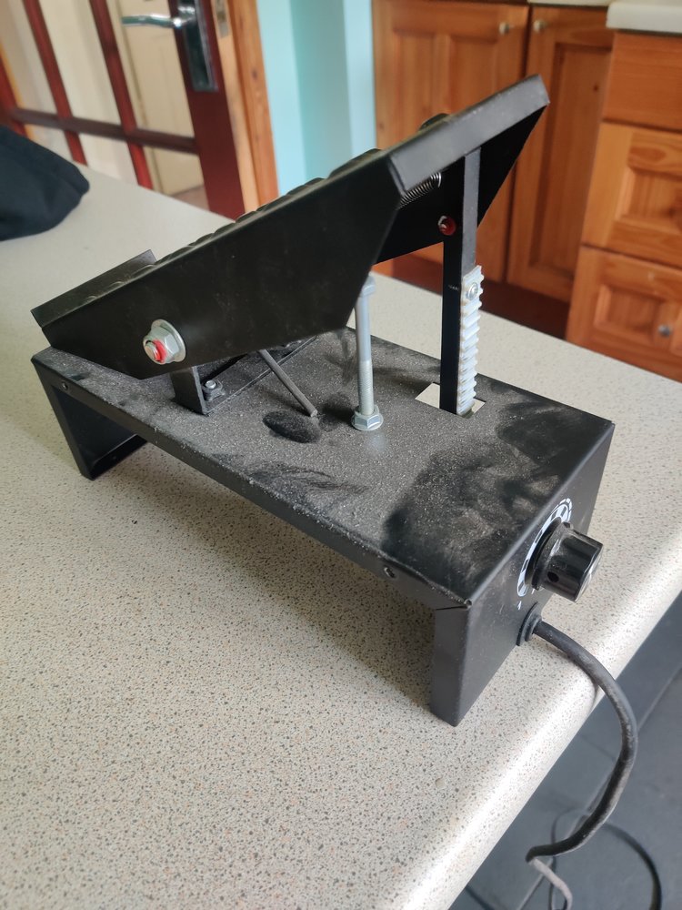

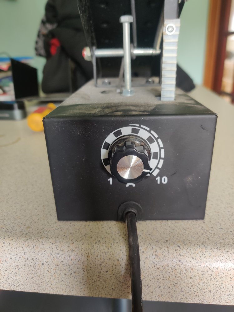

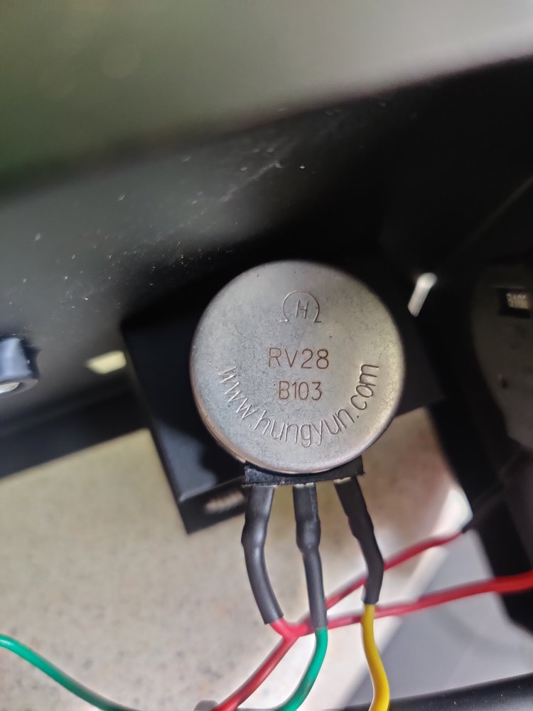

I made mine on the principle.
