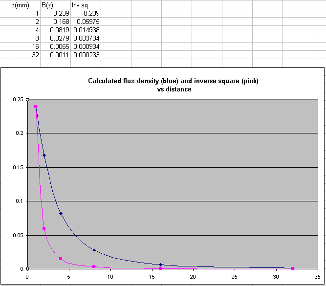

I will be embarking on a new design for the housing and attachment for my crane camera project that hit a bit of a pause recently...
I was planning on attaching to the crane with a threaded bung through a spare rope anchor point, however that would required different bungs for each crane, so magnets are now the desired choice, plus also means I can attach it to the hook block as well if I find that is desirable
I am 3d printing the housing for camera now Instead of making an ally box, 3d printing just seems the more logical choice at this point as it will need to securely house the camera, transmitter, battery, power switch and control board plus have a charging socket for the 4s lipo battery I will be trialling, which also means design changes to accept a different sized battery would be easier with a printed housing as well. There will be a 608 bearing pressed into the printed housing and the plan is to then make an ally housing that takes the magent pressed in 1 side, and a spigot on the other for the bearing to slip over and secure with a likely plastic nut.
Question is, is the bearing going to be affected by the 20x5mm neodymium magnet? The ally housing will be maybe 5mm thick between the magnet and the bearing
Would it be wiser to print a plastic bearing? Total weight is estimated to be around 150 grams hanging off the magnetic mount, rotation speed is low.
Alternatively I could make a brass bush i suppose with a good sliding fit over the ally spigot but I would like to keep the manual machining to a minimum as there is scope for a few more of these to be made once I've got it working well.
