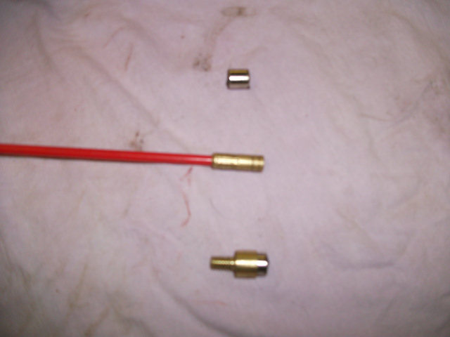

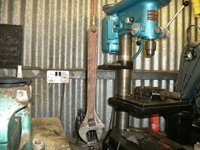

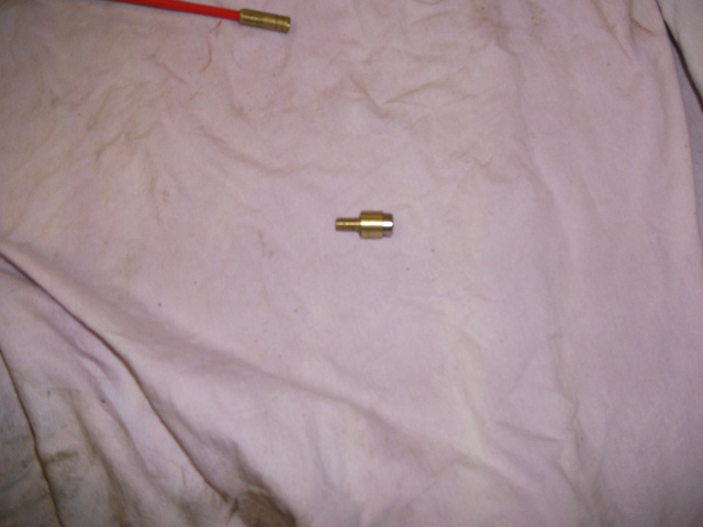

having lost tools down wall cavity s and hard to reach places i bought a few n d f b extra strong magnets on fleebay 12mm diameter and mounted it in a brass fitting turned down and threaded 1/4whit to suit the fibreglass rods i use at work. heres a large adjustable spanner held up with magnet
