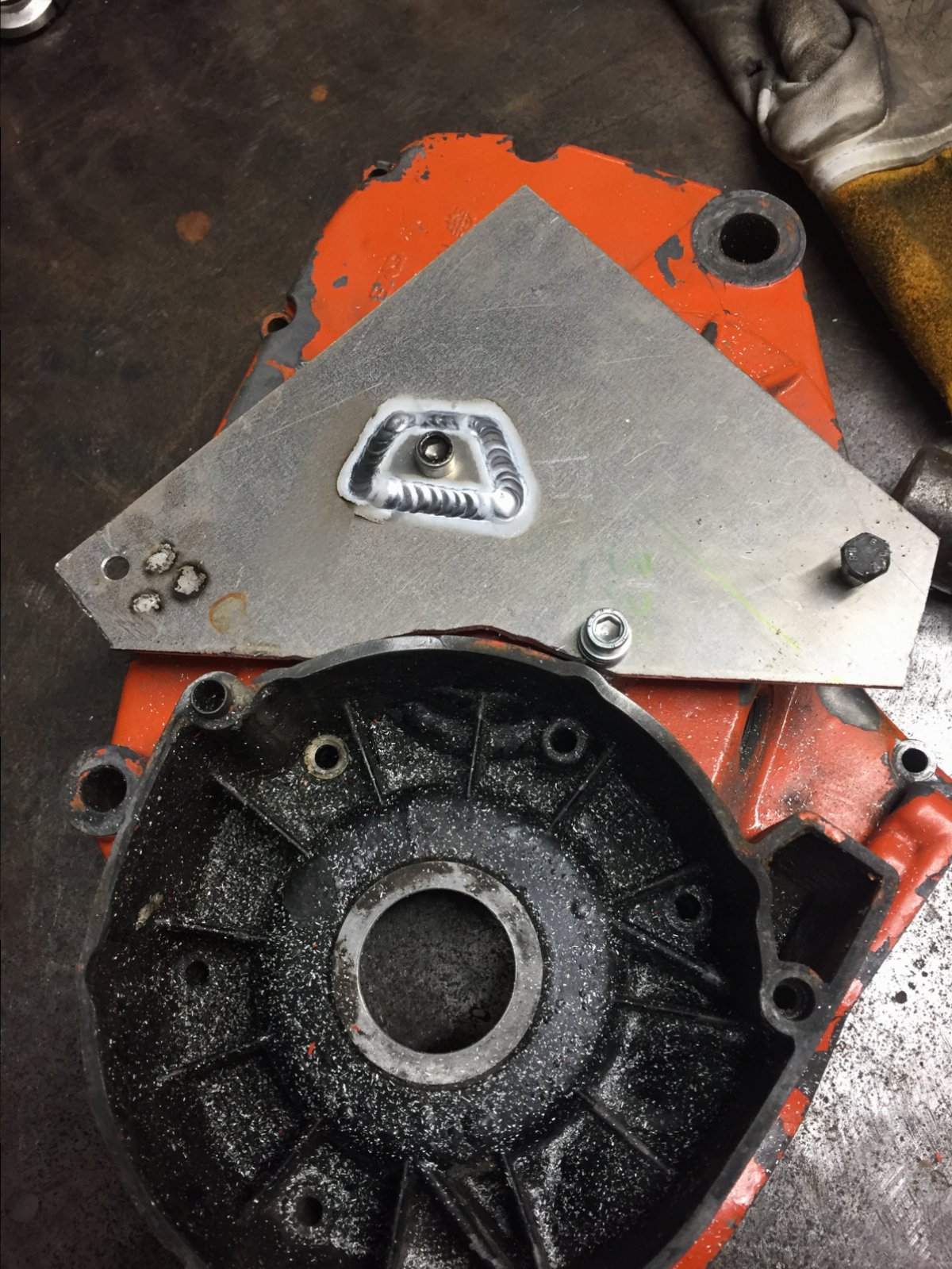

I'd steer clear of the monkey metal with mag personally... some of them state they shouldn't be used on magnesium parts and i've got a vague recollection it cause corrosion issues or something along those linesI'm gonna try building one of the lugs up as shown above today, I may buy some of them SIF 555 or HTS2000 rods instead, depending how it goes.
