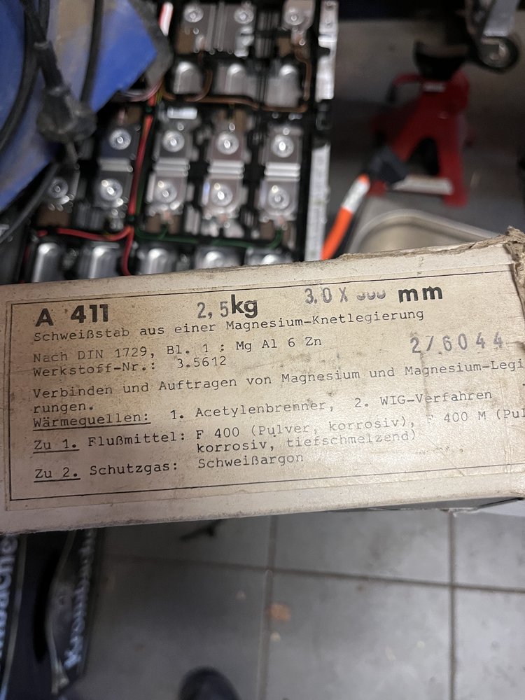

Looking at repairing some motorcycle clutch and ignition covers, however they are made of magnesium, I'm reasonably OK with Ali welding and it appears the technique is very similar.
Bit of research says that Az92a should be a good starter for 10, however it appears that magnesium filler rods are like hens teeth and when you do find them you can only buy them in packs.
Just wondering if any of you guys might have a couple of rods I could buy???
Otherwise I think the covers might end up in the bin....
