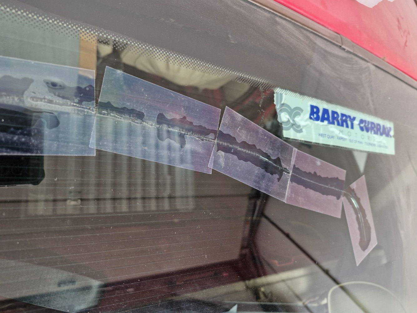

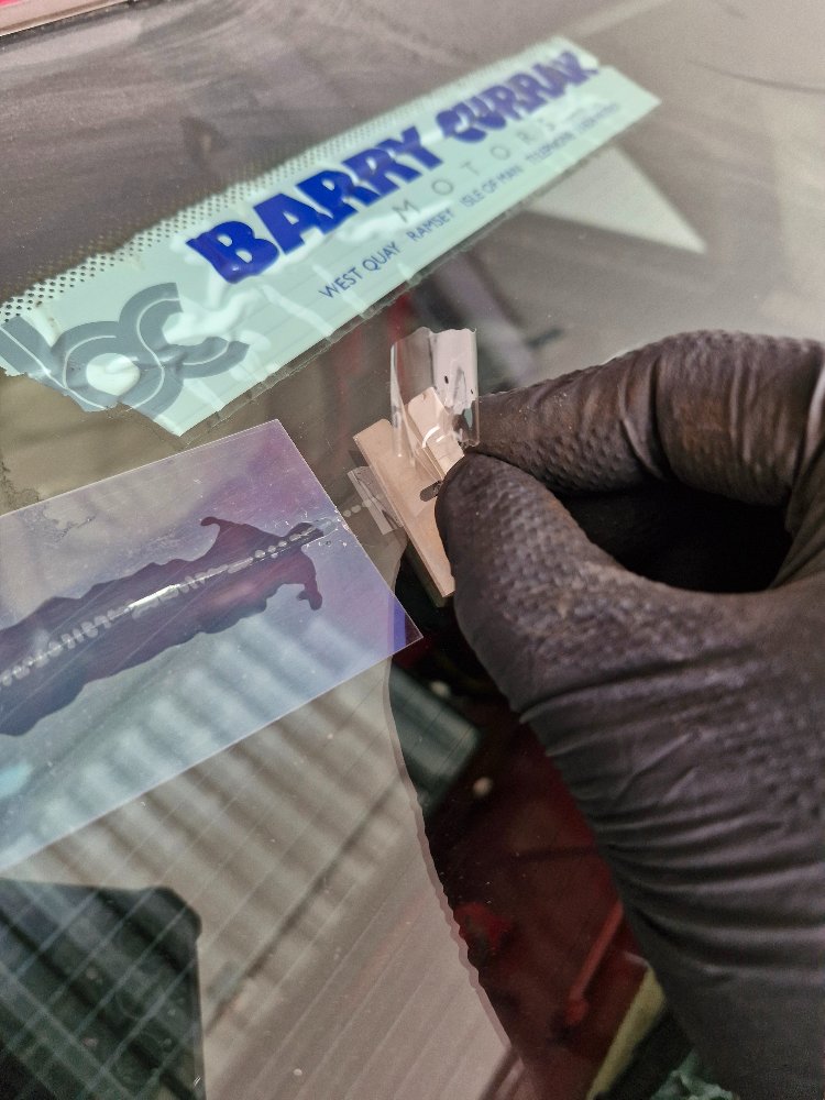

I got to using this stuff today. Cures fast with UV light. Scrapes off easily.

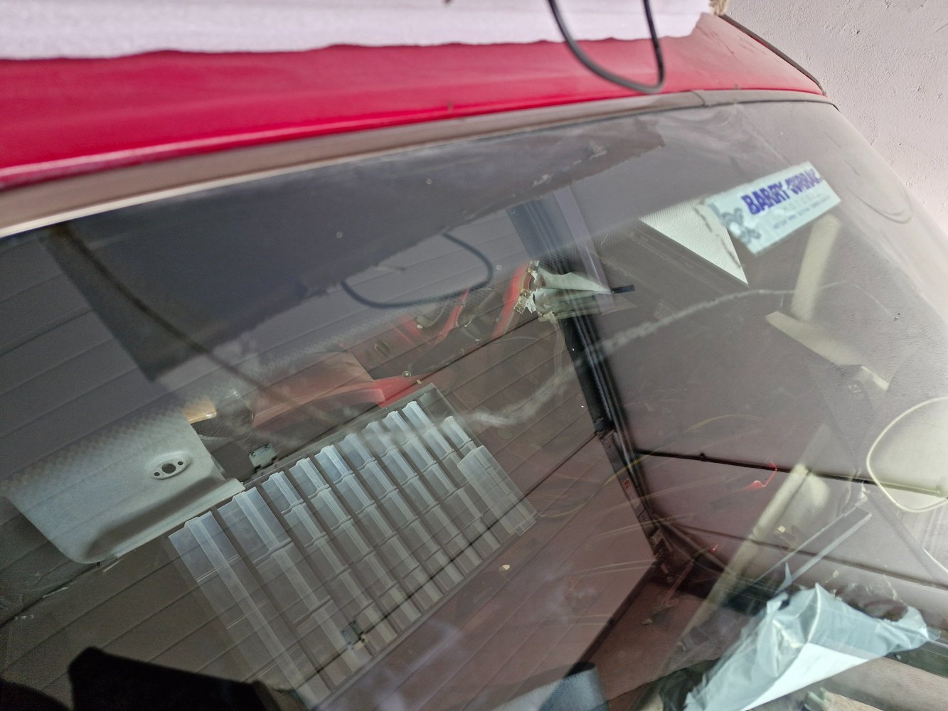

Note this car is NOT a great example as there is visible deterioration within the laminated glass as its been like this for years.
Before:
During:

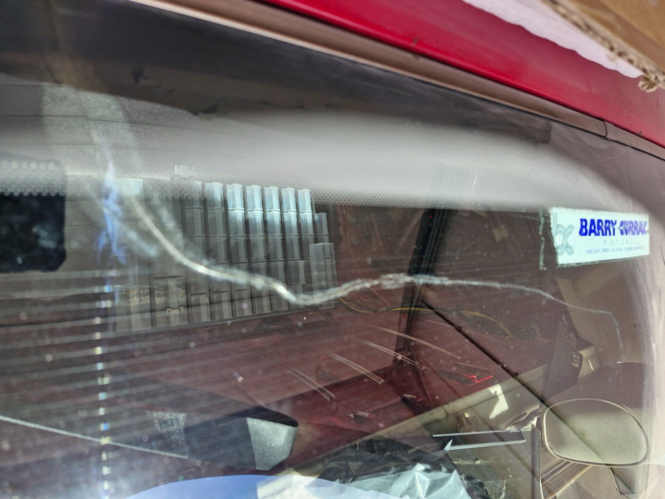

After:
Has it made a difference? I'd say yes a little bit of an improvement. More so - I hope it will help seal it from getting worse until I get a new screen for it.
