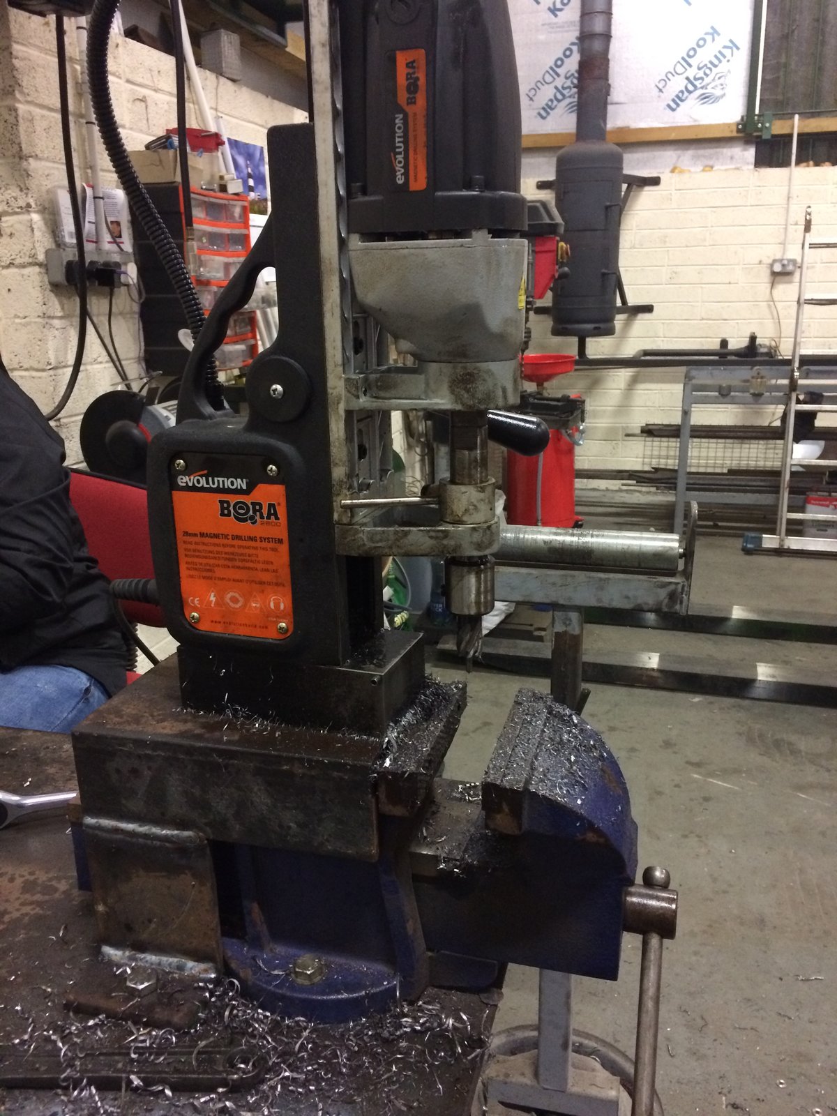

I was cursing constantly trying to drill mag holes in narrow but heavy plate and flat bar also in long lengths of box for gates and dog runs,I was just clamping to my bench edge and drilling through but it wasn’t brilliant and ruined many a good drill bit.
So I came up with this idea it’s 150x75mm rsc with 100x10 flat coming off the channel then bolted to the bench to aid removing it if ever needs be
