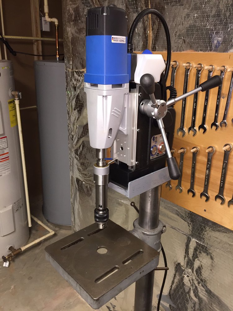

Besides portability, magnetic drills have a number of good features. They make the use of annular cutters easy, with through-the spindle cutting fluid. Many models provide electronic variable speed in fwd. & rev. and/or power down feed.

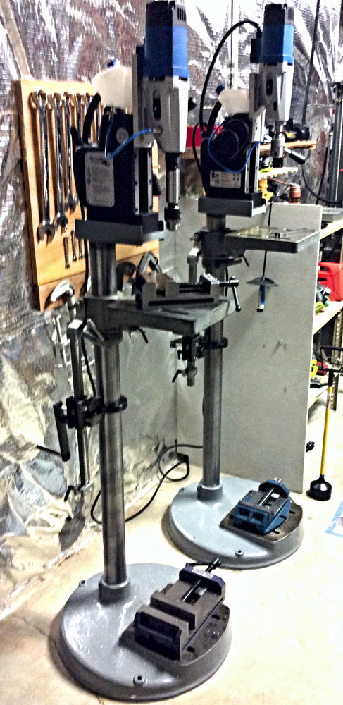

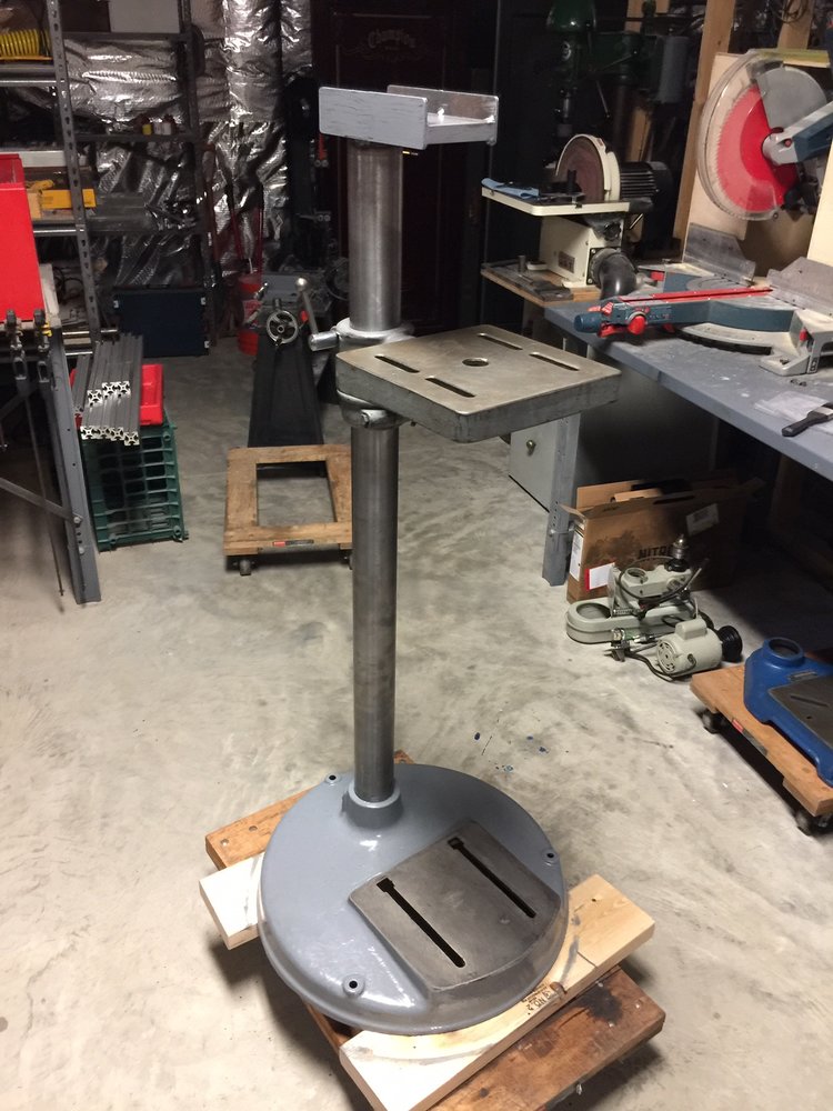

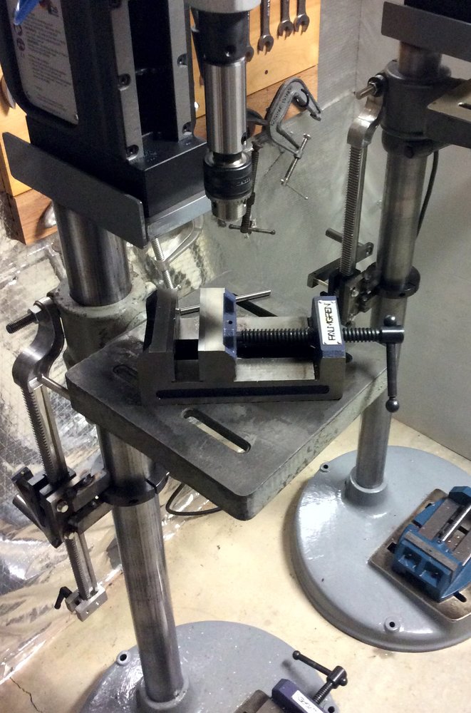

One big drawback is their lack of room between the spindle and the base. I fixed that with some old drill press bases and columns purchased on eBay. Table height adjustments are made from old machine torch mounting hardware.
