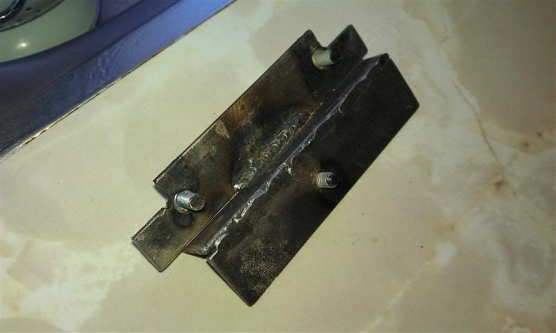

Here it is, it's just three bits of flat bar with a couple of holes drilled and some cut down M6 bolts that stick out a bit on the underside to attach to the router and to fit into a drilled hole at the centre of the required circle.
It bloody worked though

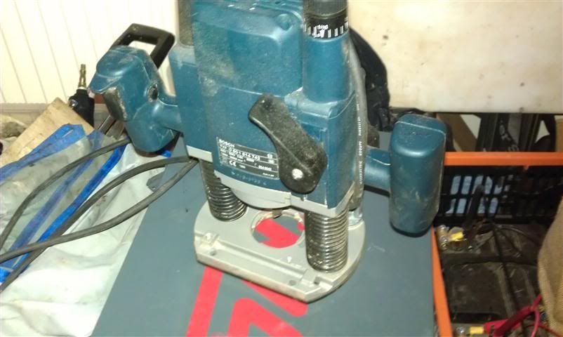

Here is the router it needs to fit on to. You can see the two holes I am going to use on the side closest to the camera
The bracket

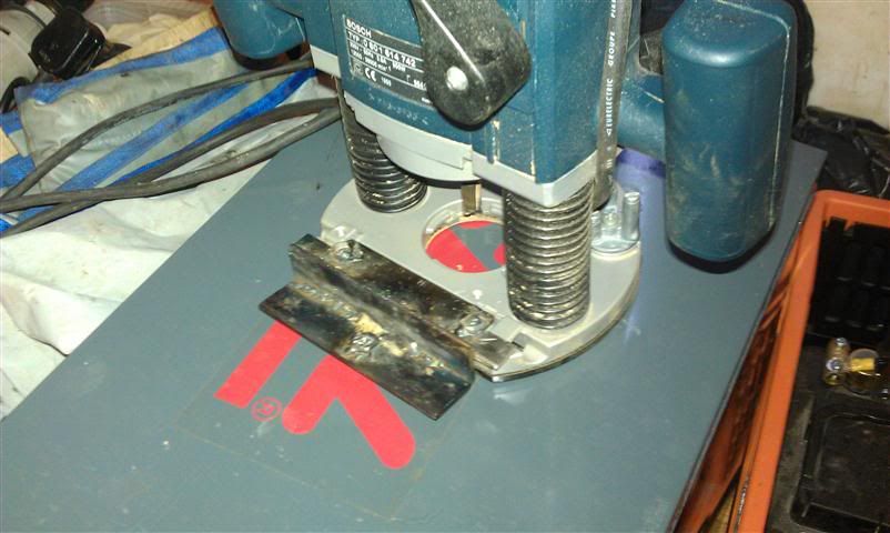

The two together
The two studs on the strip on the upper left slip in to the mounting holes on the router and the sungle stud is what sits in the centre hole you drill before you make the circle..
