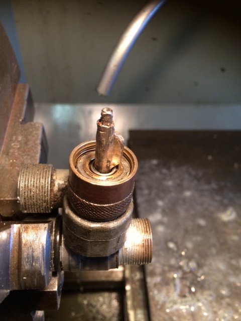

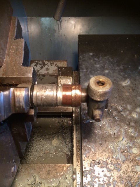

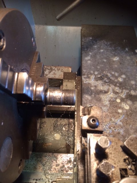

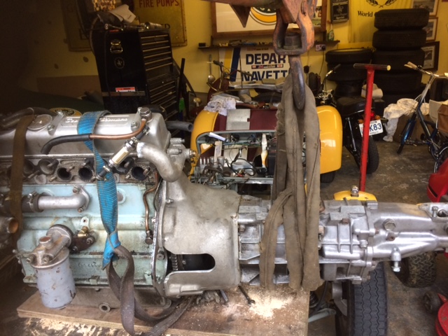

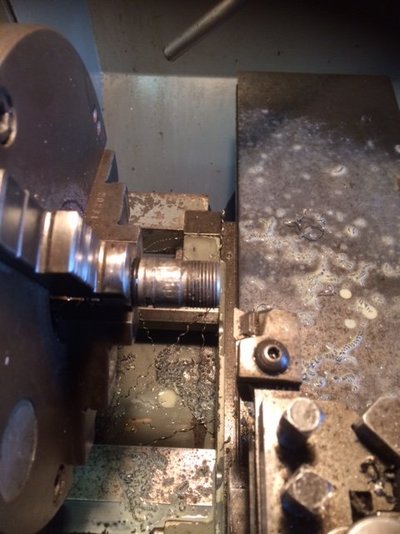

I have finished all the adaptions on the BMC bell housing to get it to fit the Toyota box. that involved a lot of machining on the miller. Next was getting a speedo to work. all to tight in a lotus seven so i machined down the original bodying cut a new 26 TPI thread on it so i could fit the right angle drive the only way to do it also had to make a new drive piece for the right angle drive to fit the drive outlet of the Toyota box. And it all works better to be lucky than good some times. LOL
