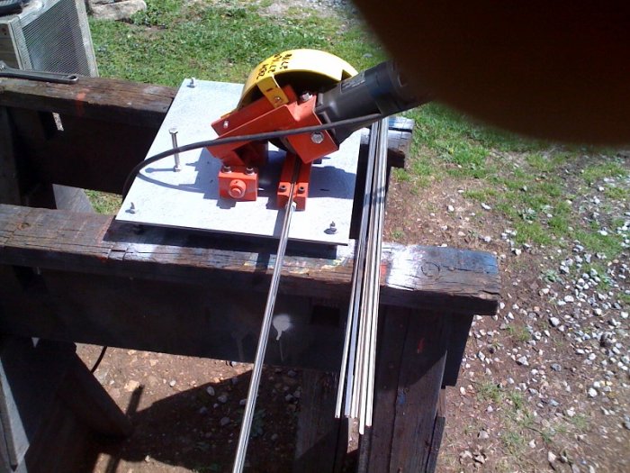

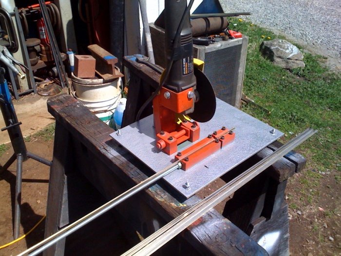

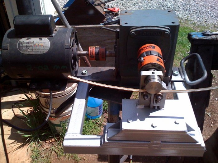

I needed a small saw to cut the stainless steel train track for my ceilingtrains.com bridges so i made one from a small angle grinder. Then i have to roll the track to the right radius for the curves so i made a little roller. I just added a gearbox/motor drive to power it. I got tired of it being hand powered...Bob
