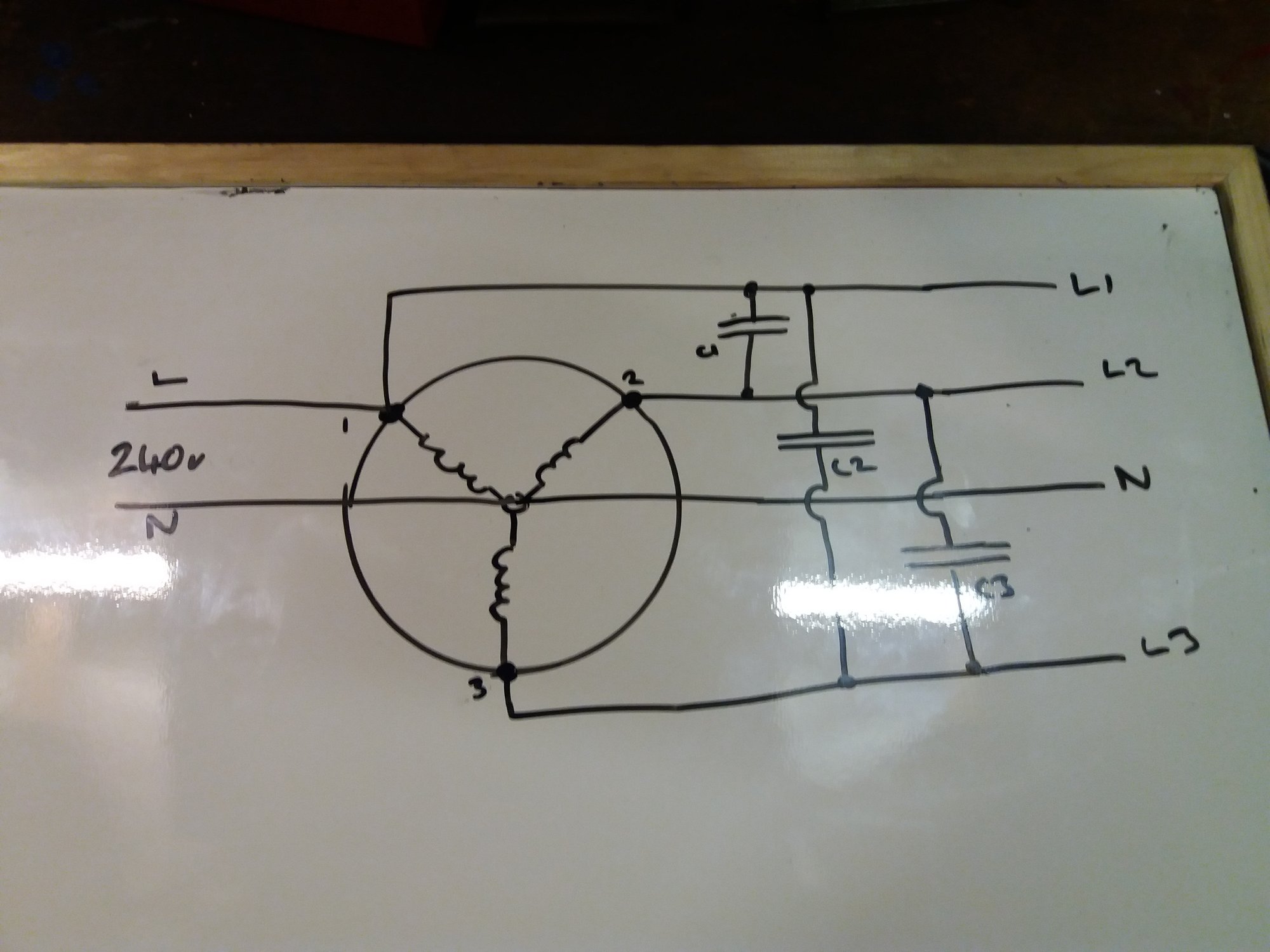

Quick estimate, while in the shedI make it 87% - pretty impressive...

I make it 87% - pretty impressive... Not up with VFDs though, they're usually in the high 90s!
They also don't draw most of a kw with no load :/
@Tilly819 - have you fitted power factor correction caps to the 240v input side?

I've got a rotary converter here a clever mate made up. Uses a re-jigged 110V trannie on these lines:
That's reconfigured to be an auto-transformer. I would have expected the output to be around 450v by simple addition.
Of course, it's 110 centre tapped and not 110-0-110![]()
They can make cracking power supplies for "experiments" though, 55-0-55 at a hundred amps goes a long way...
