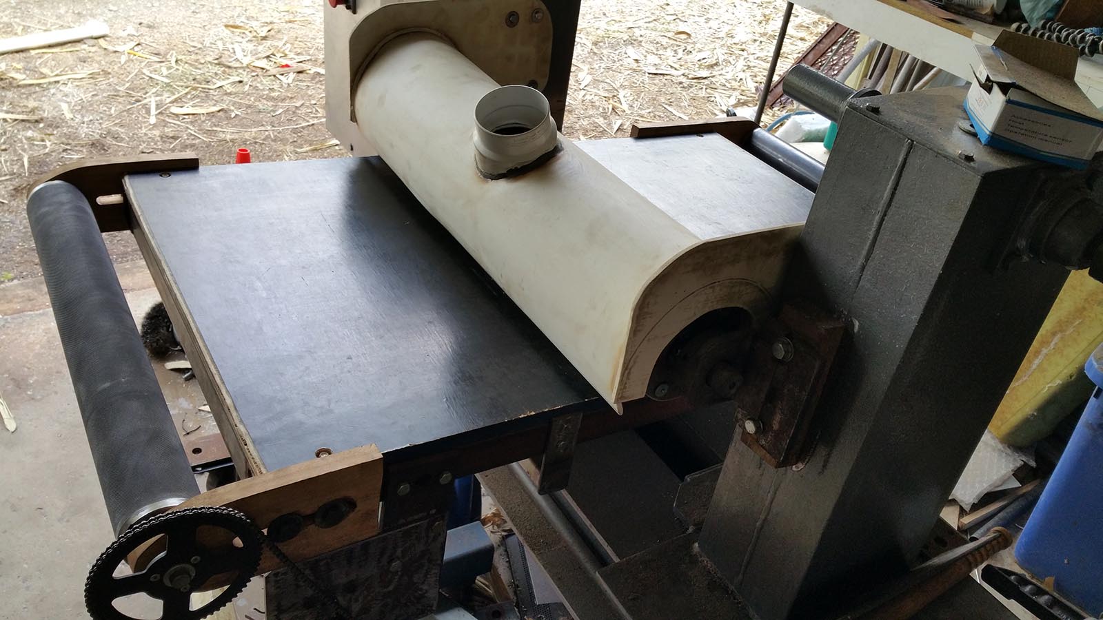

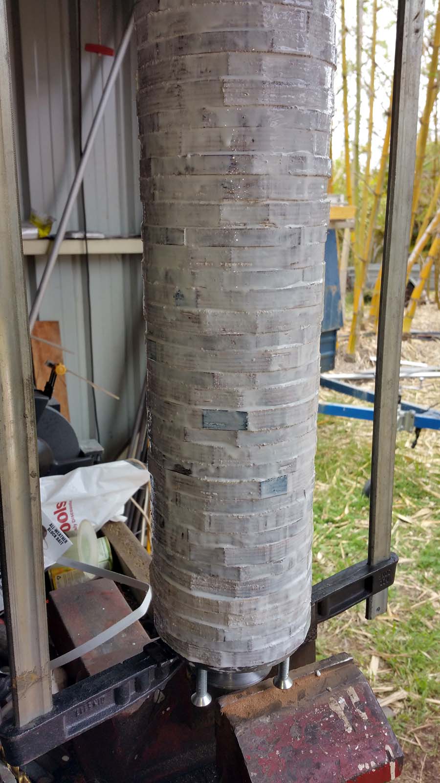

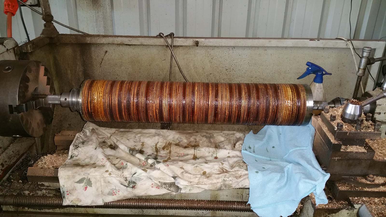

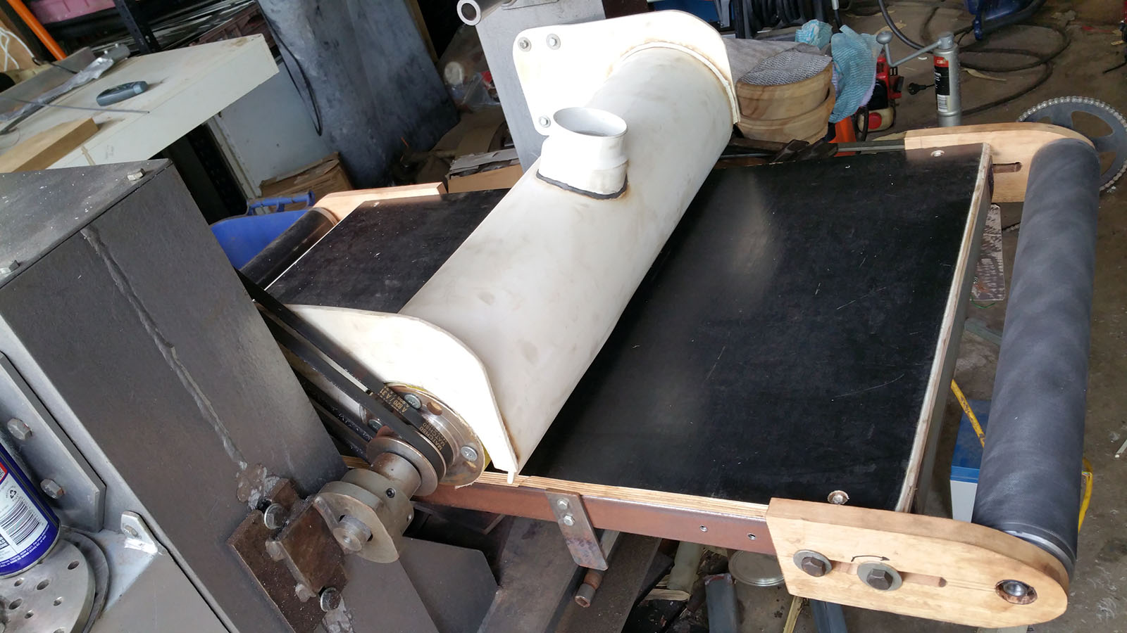

I made a large wood lathe several years ago and had always wanted to build a drum sander, but due to very limited space left in the shed, I decided that my best option would be to make one as an attachment to the lathe rather than having another separate piece of machinery that would take up even more room. It also meant that I could save on the cost of an electric motor and associated bits as the lathe had more than ample power to power it. I do have a 15” wood thicknesser but some of the hard woods I have, contain a knotted grain which ends up with a bit of tear out, so this attachment should reduce that nicely.

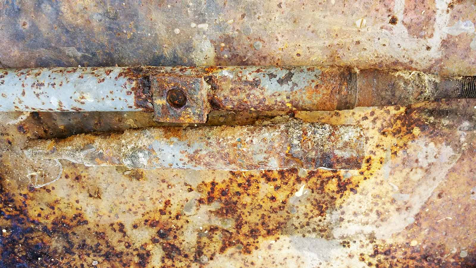

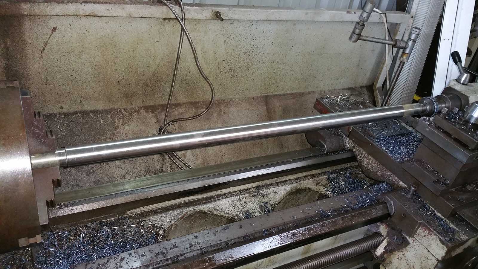

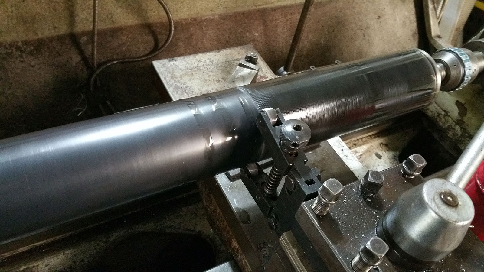

Pic 1. Found a very old and very rusted trailer axle, cut off the ends and put it in the metal lathe to clean it up.

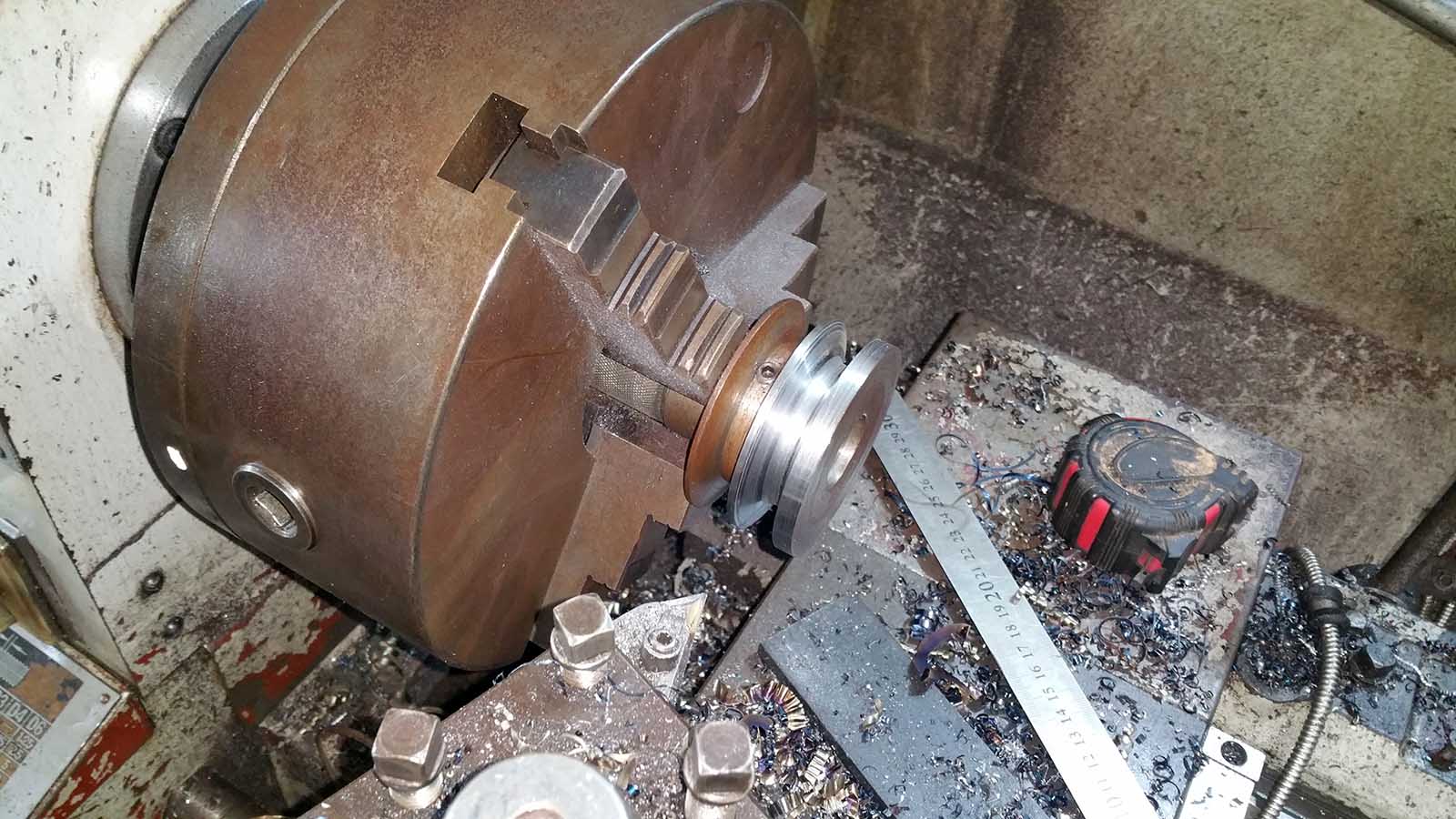

Pic 2. Machined the axle down to 35mm to clean it up.

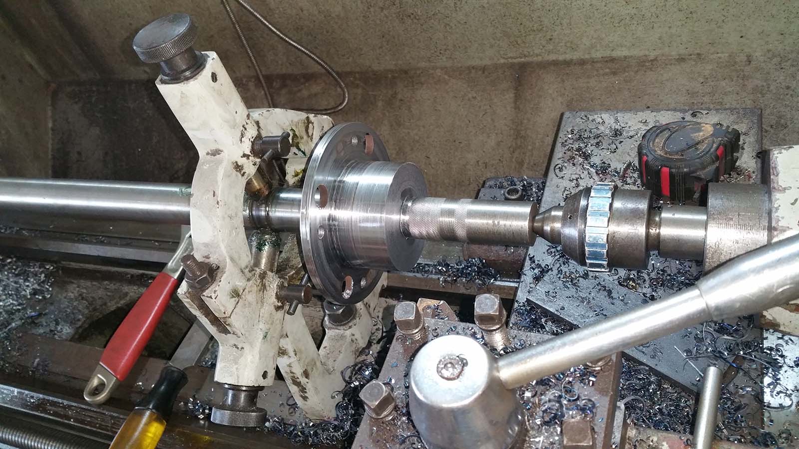

Pic 3. Found an old flange in my scrap pile that was not going to be used for anything else and welded it to the shaft.

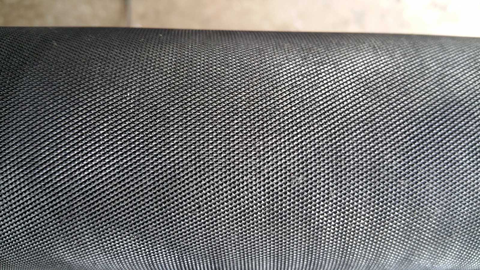

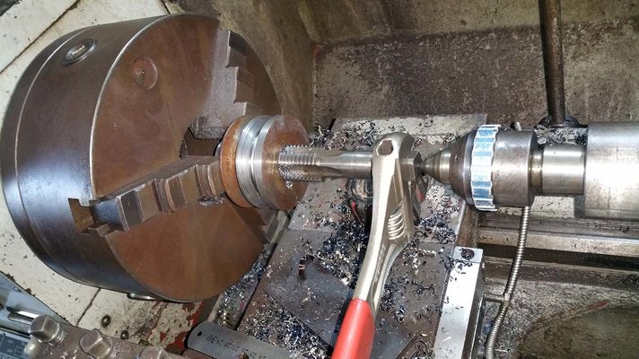

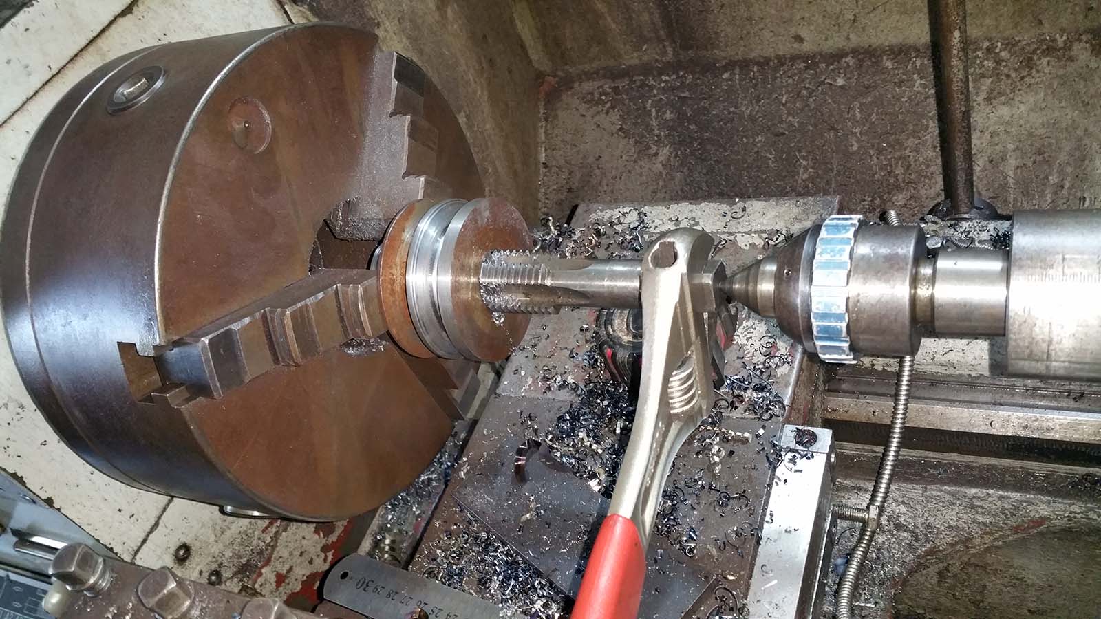

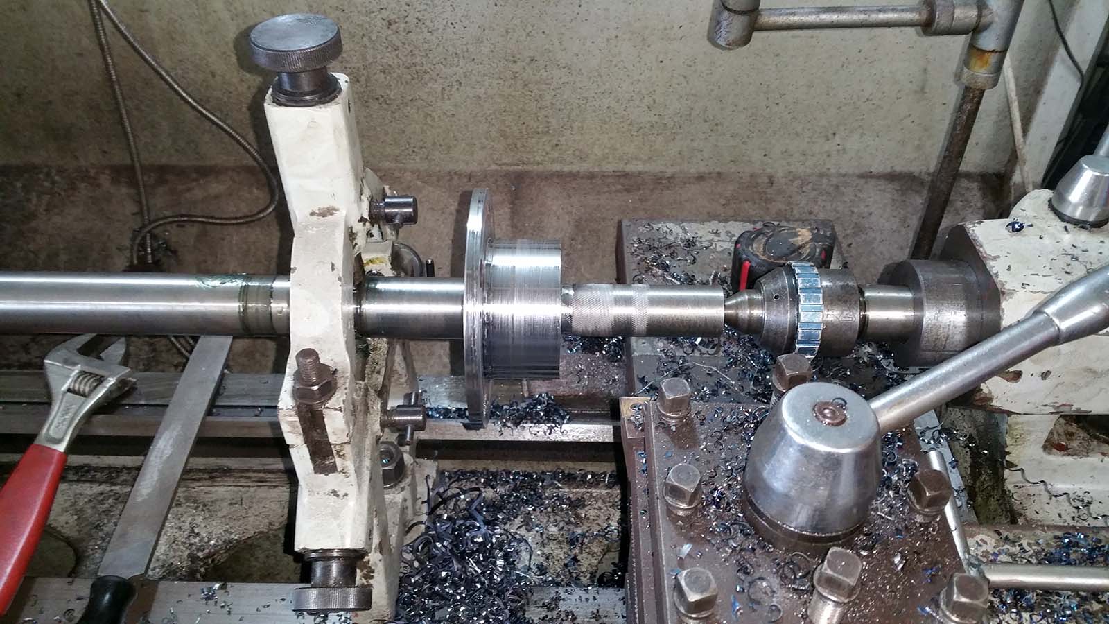

Pic 4. I stuffed up the machining and took off a smidge too much metal for the bearing so knurled the end to build up the difference.

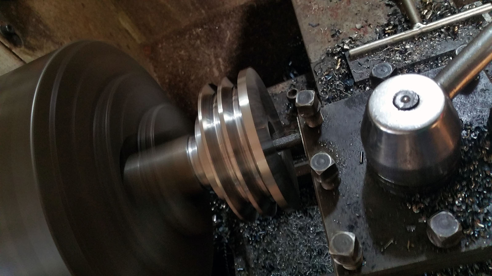

Pic 5. I had a 2 step pulley lying around so turned one step down to make it into a double pulley. Probably not necessary but at least now the belt definitely isn't going to slip under load.
