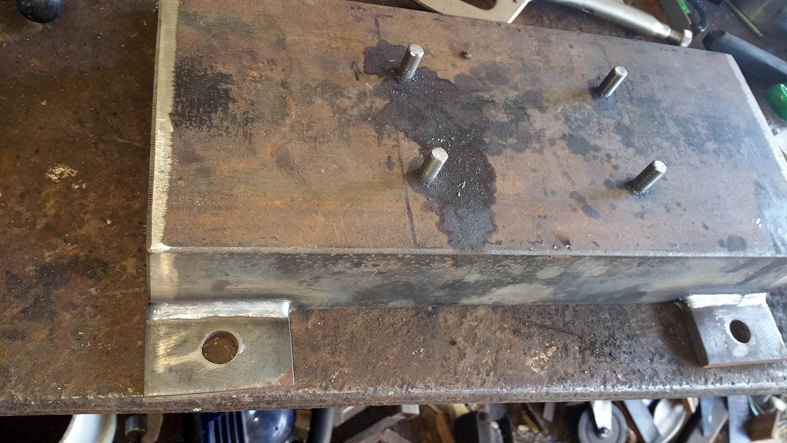

Pic 3. Had a piece of heavy channel steel lying around so welded on a couple of tabs so use those to clamp/bolt down to a table. Drilled and tapped 4 bolts to clamp the motor support base to it.

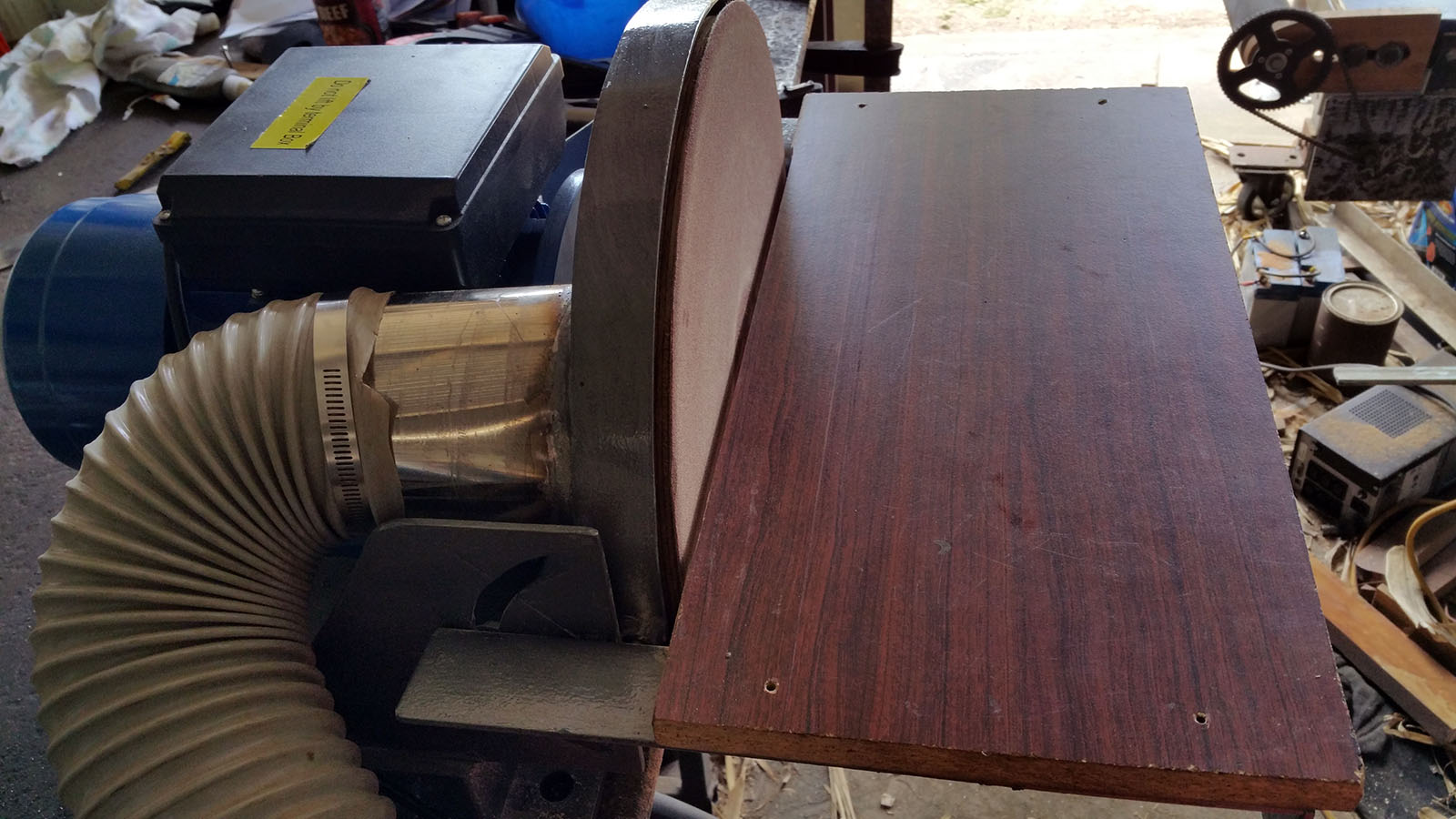

Pic 4. Made the front bottom dust cover the same way and this is screwed to the back cover by 4 tabs from the back, Cut out a 2 holes in the back cover, one for the disc hub support to fit through, and the second larger one for the 100mm dust extraction hose to fit to. There are also two nuts welded to the back cover, one on each side and these support the swivel table frame.
Pic 5. Welded a slotted piece of plate to the motor support channel, rough plasma cut it out and then filed it and also used a carbide burr to shape it into a semi circle. There is an adjustable bolt which sets the angle of the table and the bolt on the frame pivots the table frame. Although not shown I later added another piece of steel directly in front of the sanding area to support the front of the table

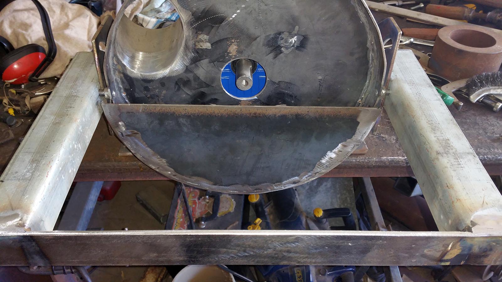

Pic 1. Made 4 supports out of 19mm rod, these are threaded one end and welded to the back of the dust frame, these bolt the rear dust cover to the front flange of the motor.

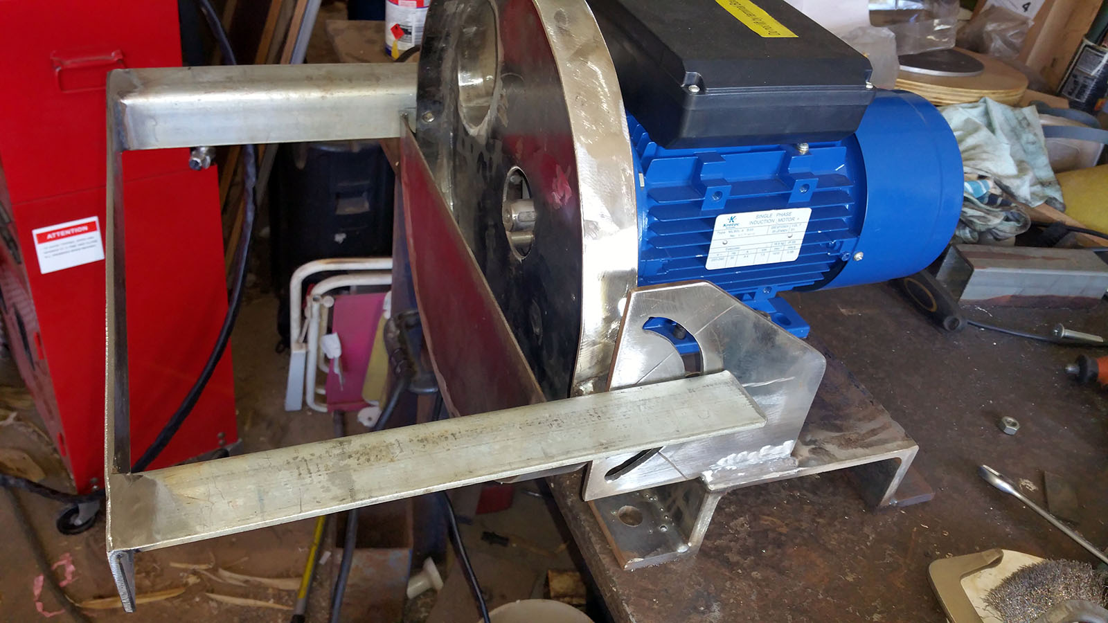

Pic 2. Bent a piece of flat bar 40mm x 3mm to a circular shape and welded it to the 3mm piece of metal sheet to make the back support cover. Cut off excess material and ground flush.

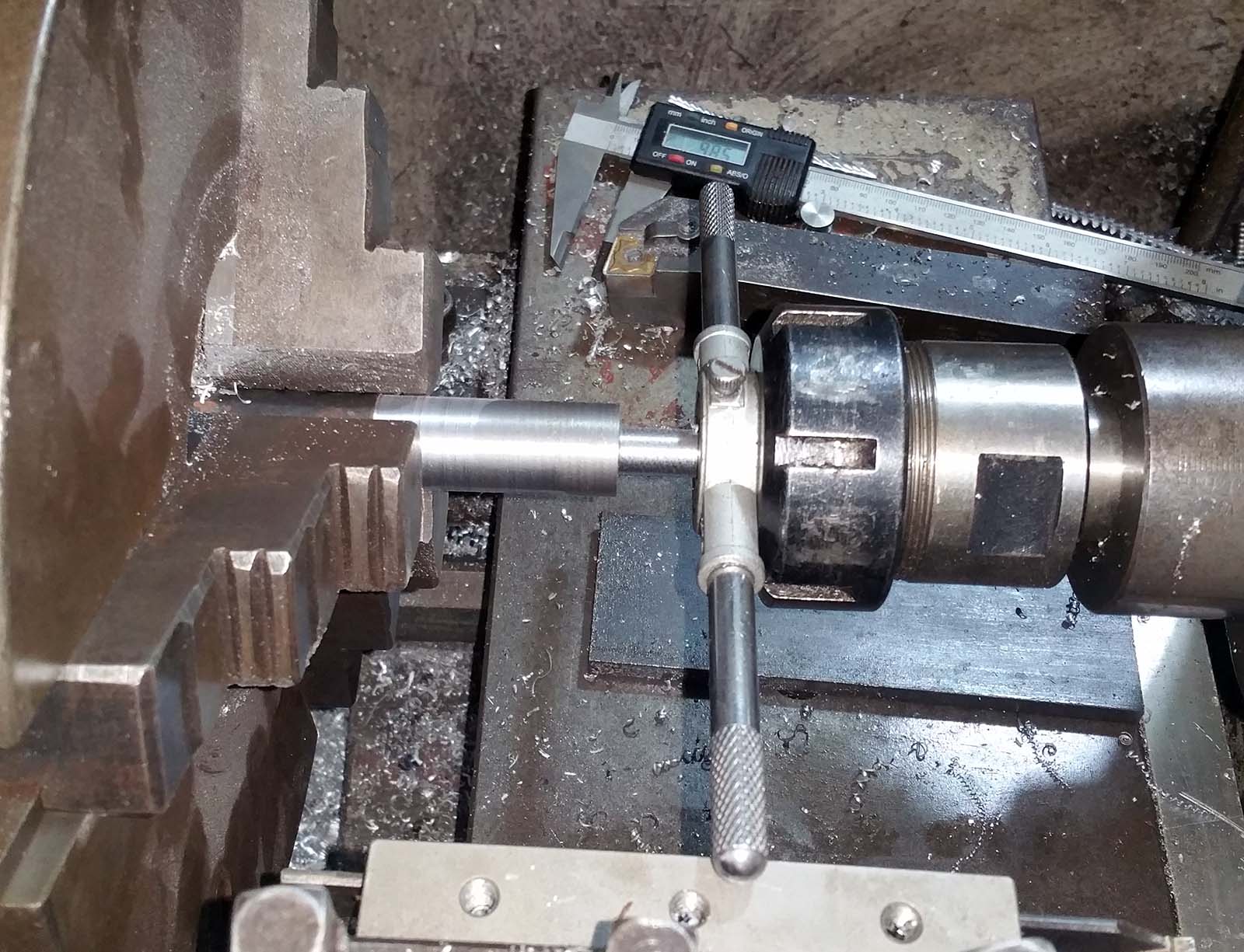

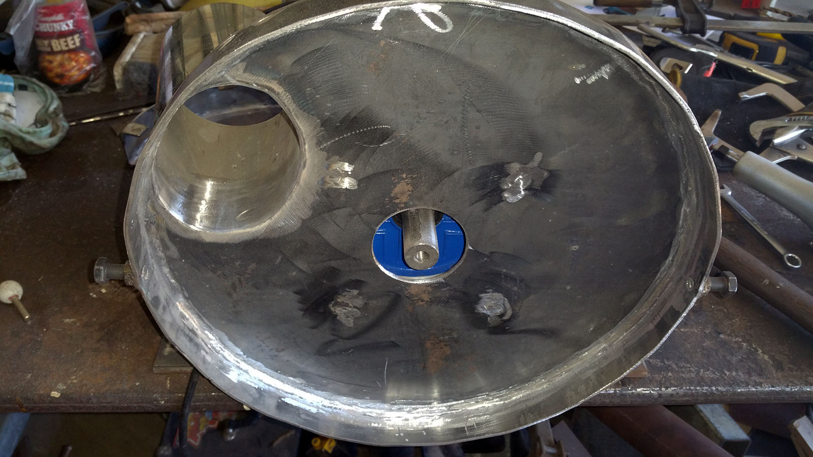

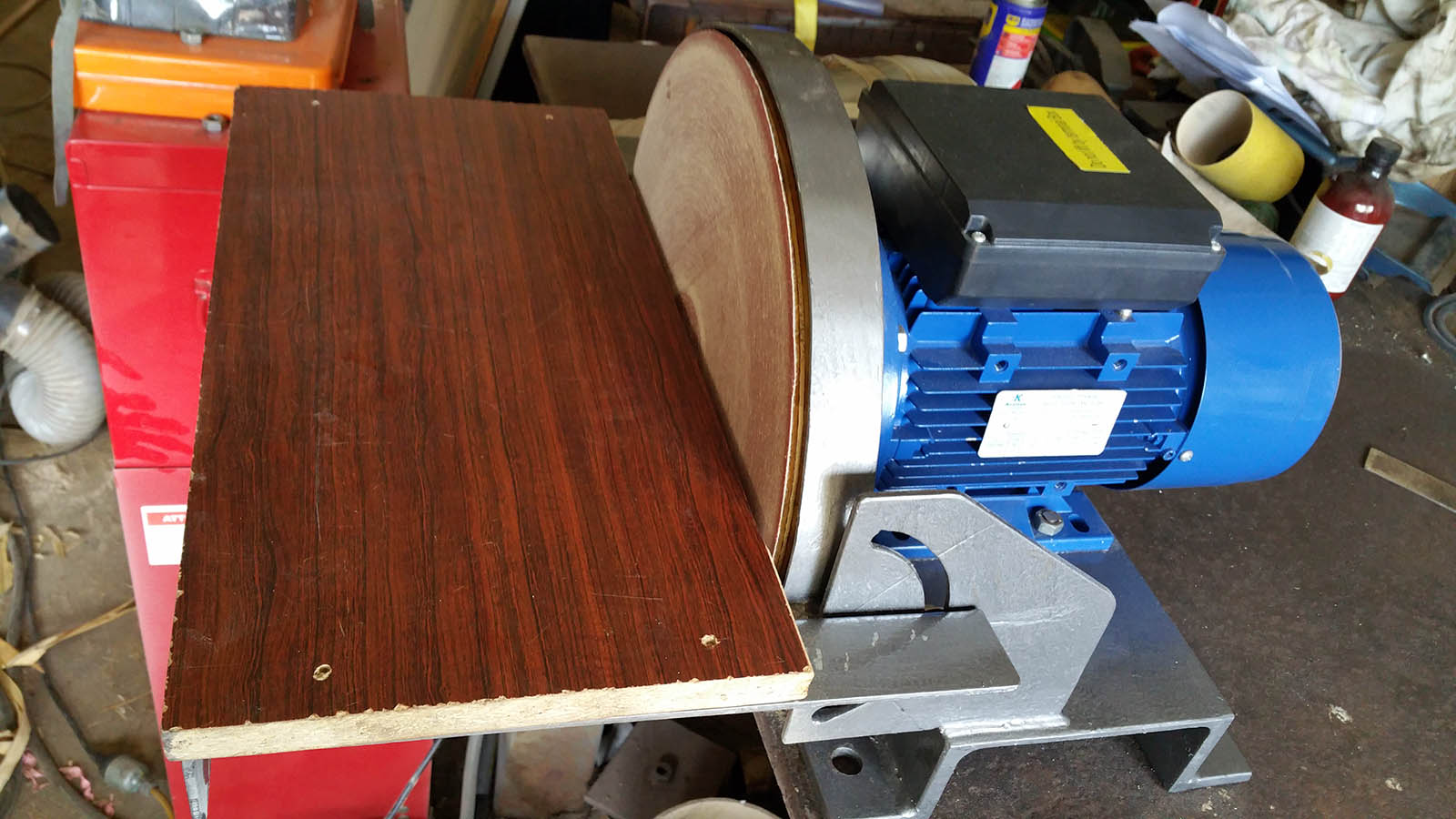

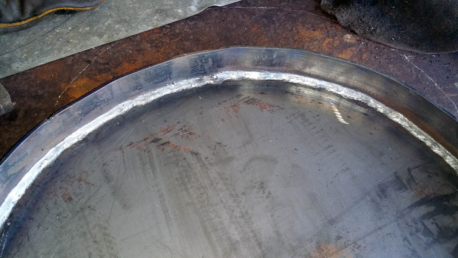

Pic 6. Back cover welded up.
