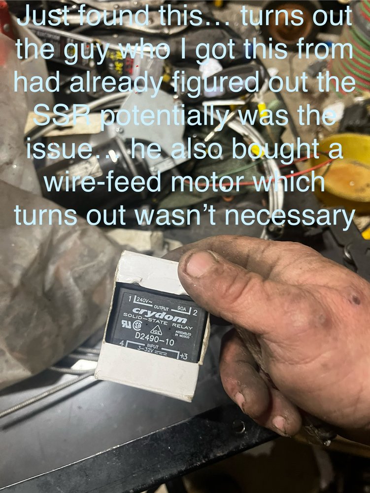

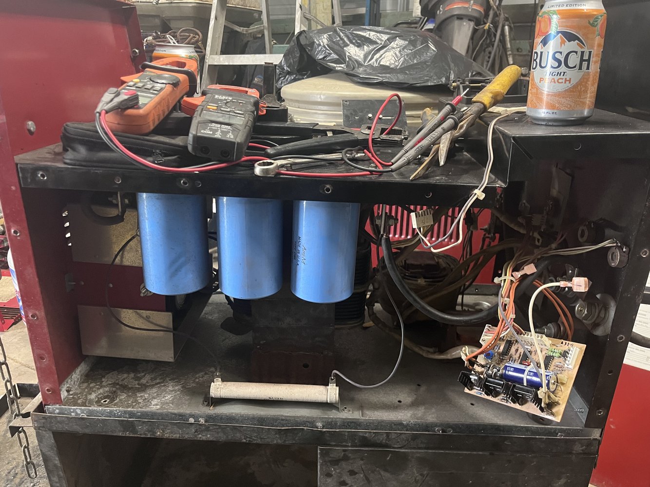

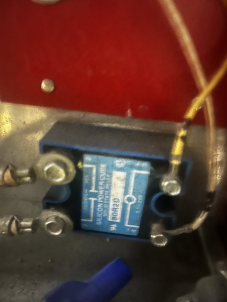

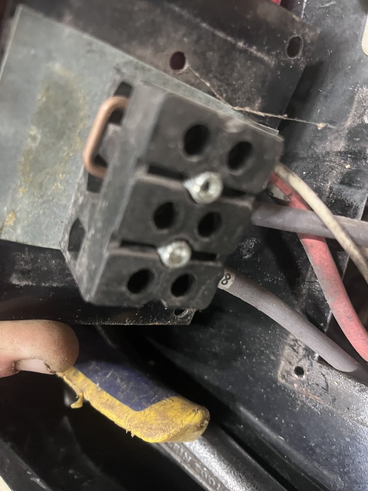

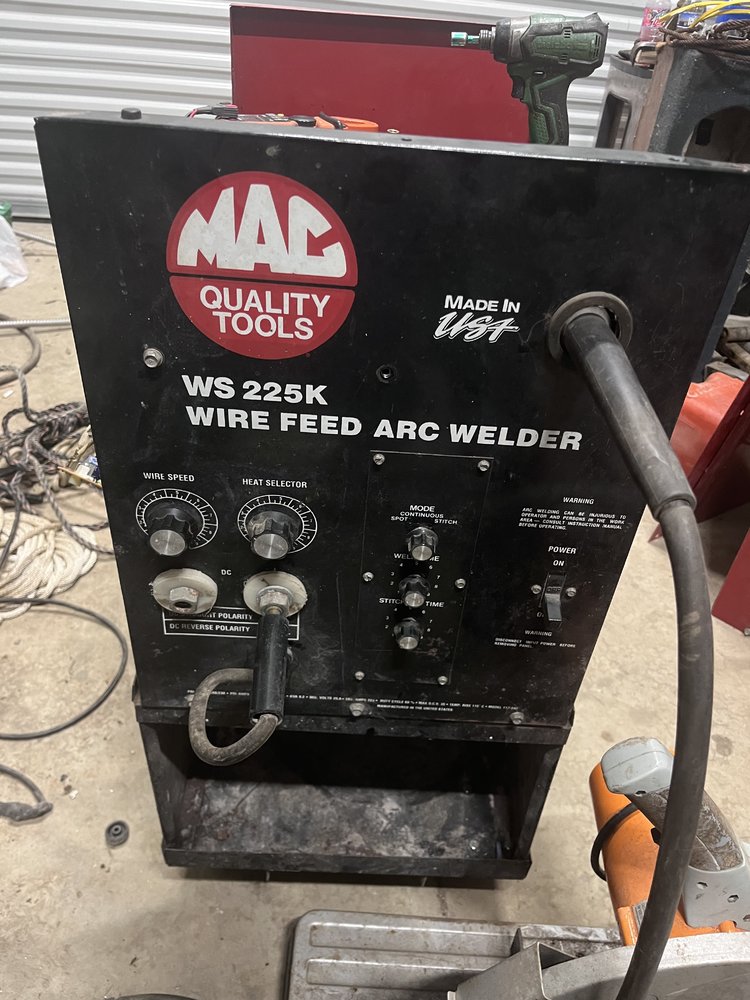

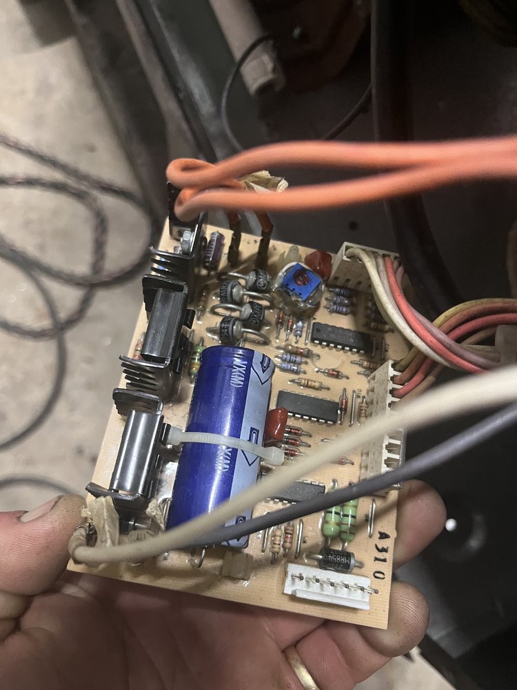

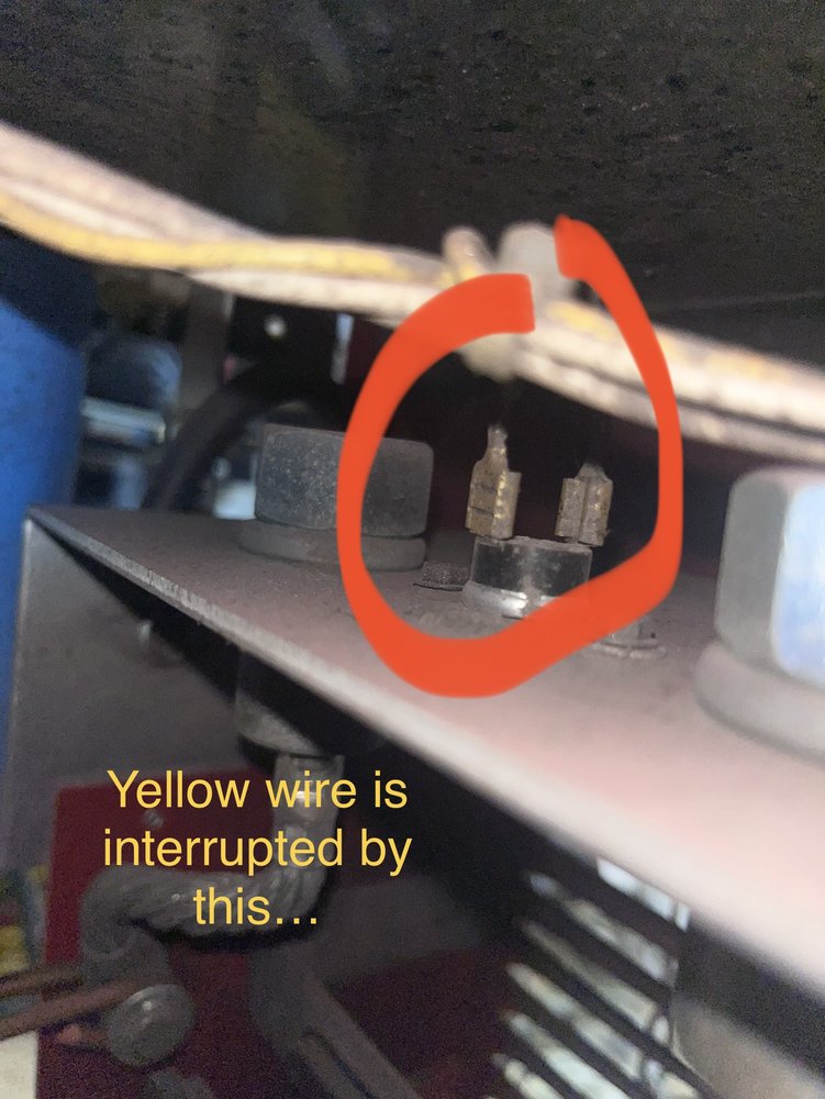

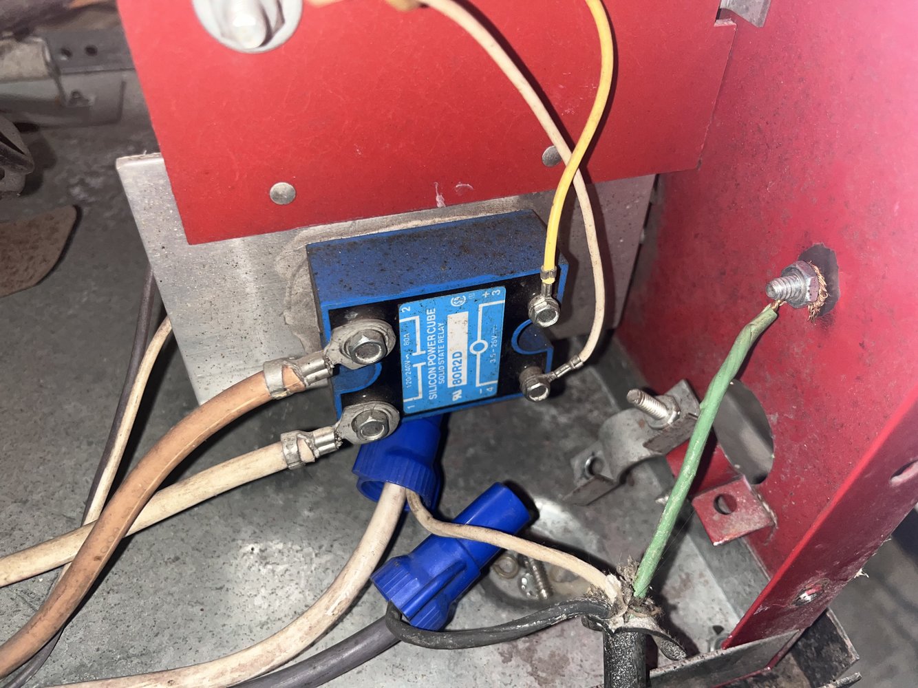

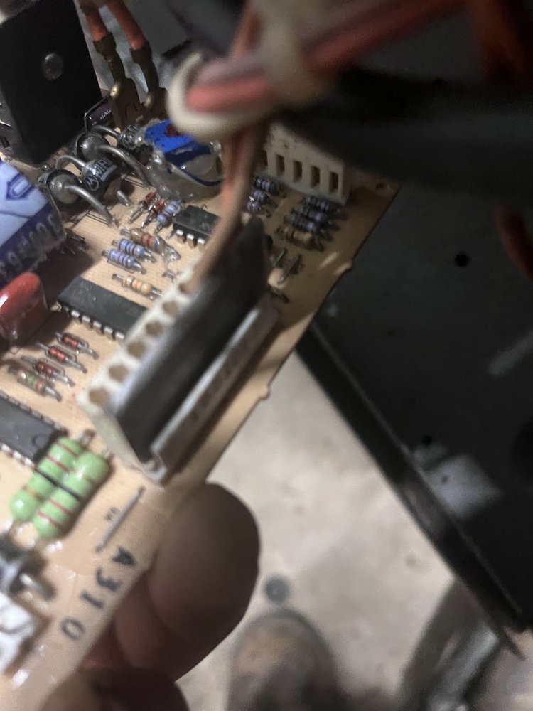

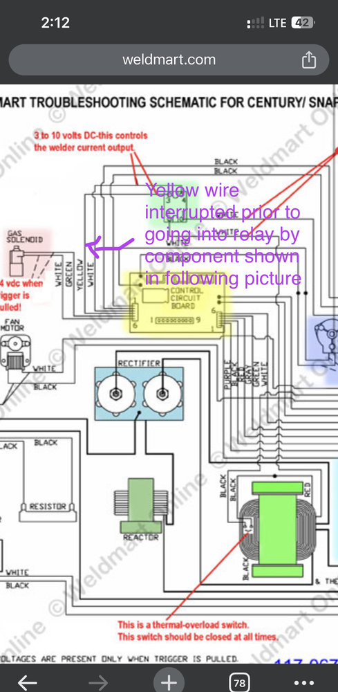

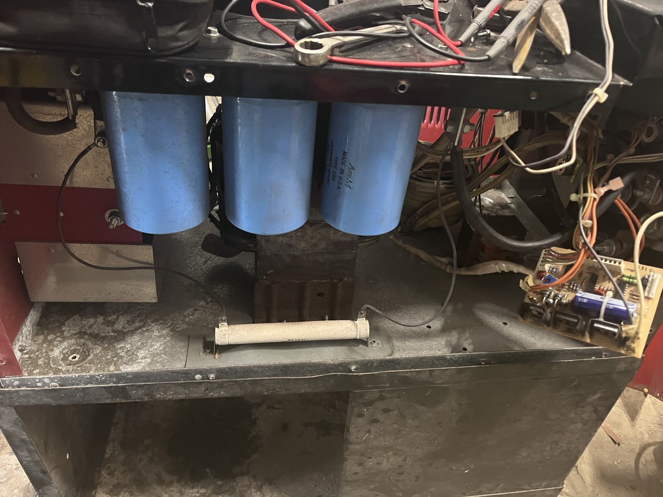

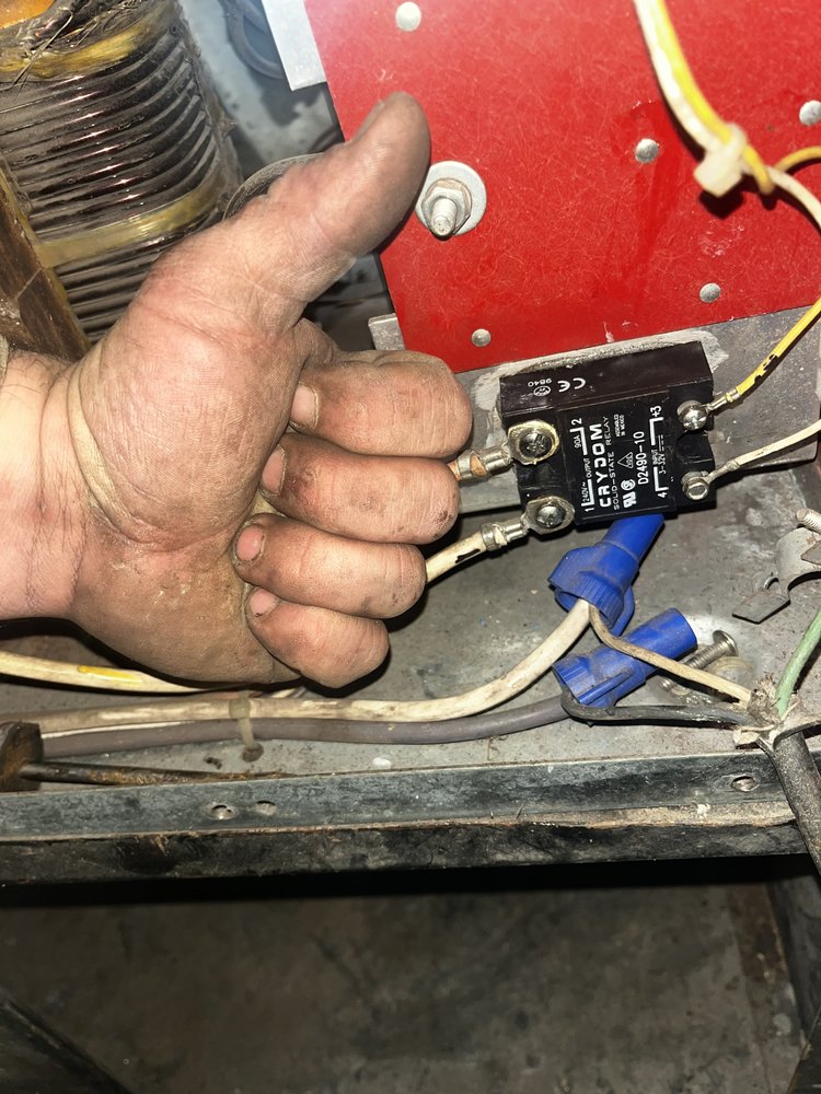

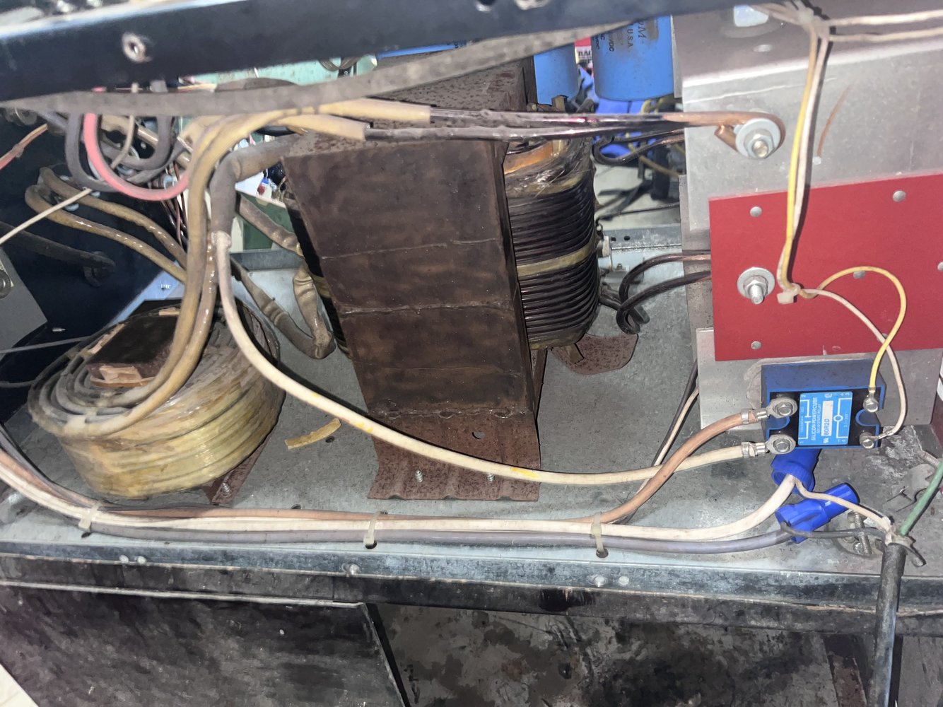

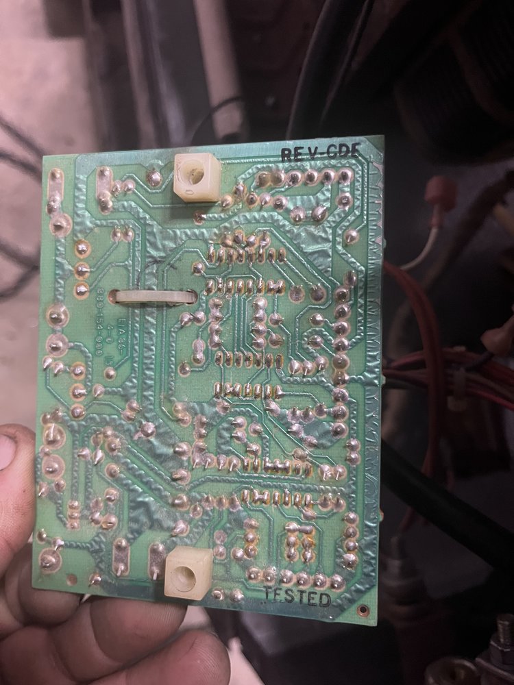

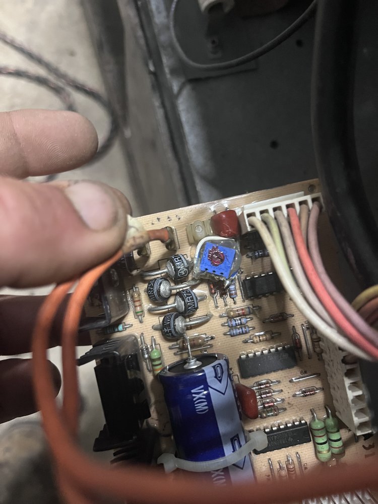

I have checked and confirmed to be functioning: the lead (continuity when trigger engaged), drive motor for wire feeder, contacts from guns trigger plug to the board all look perfect... and now i'm in the terroritory of troubleshooting the relay, and high voltage connector. is there anything i should try prior to moving into this next step? what does the buzzing indicate possibly and the click is quite pronounced when i hold trigger.
