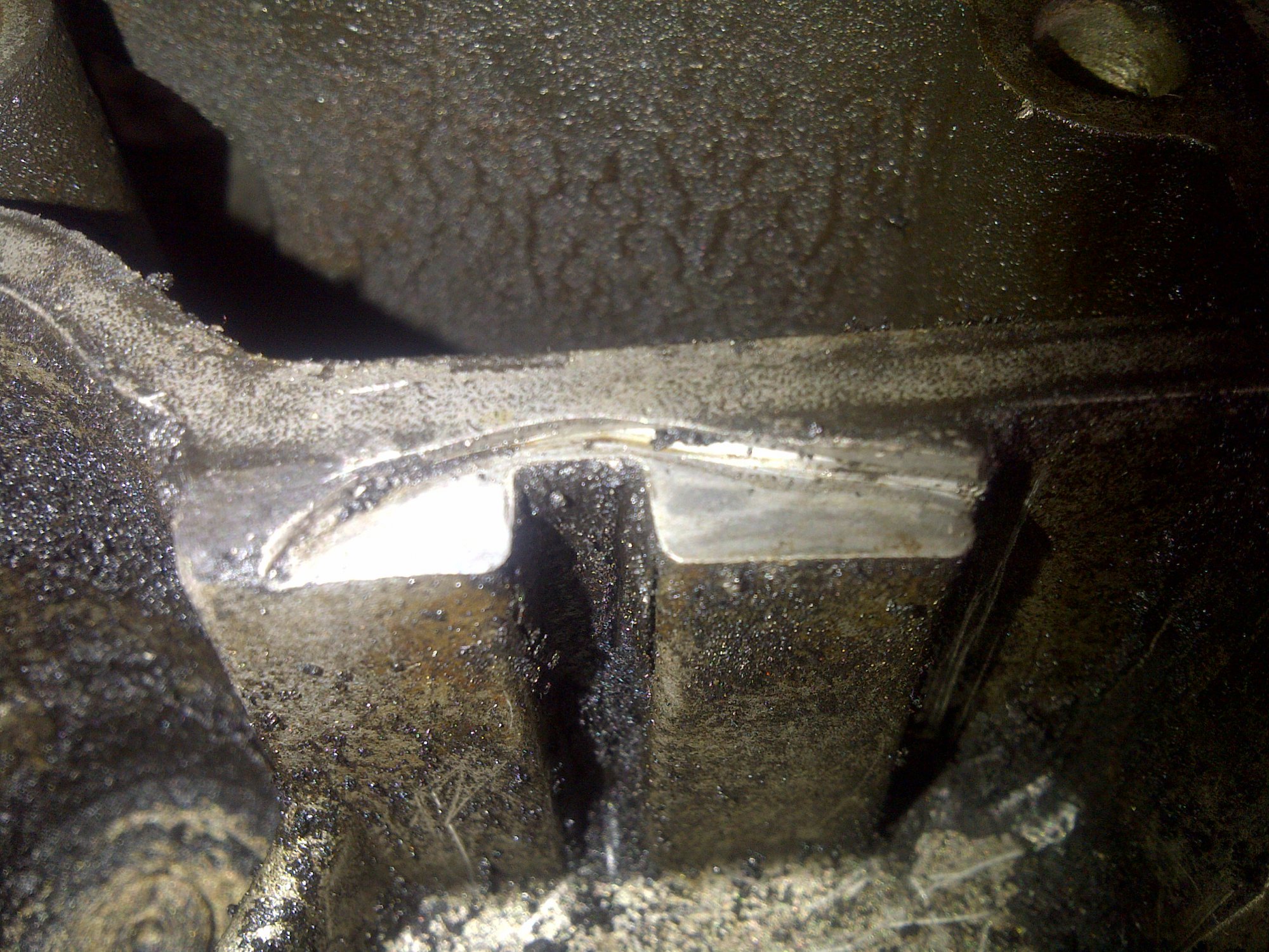

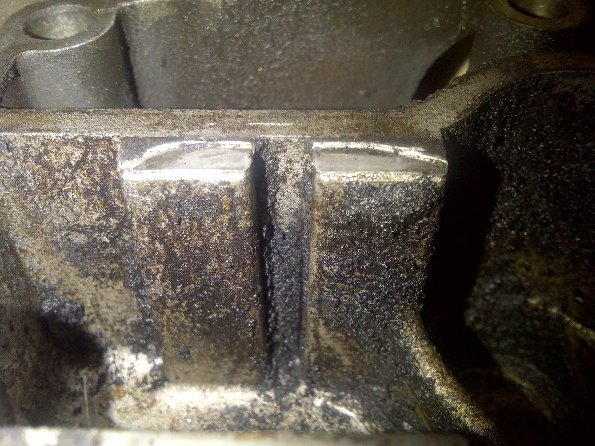

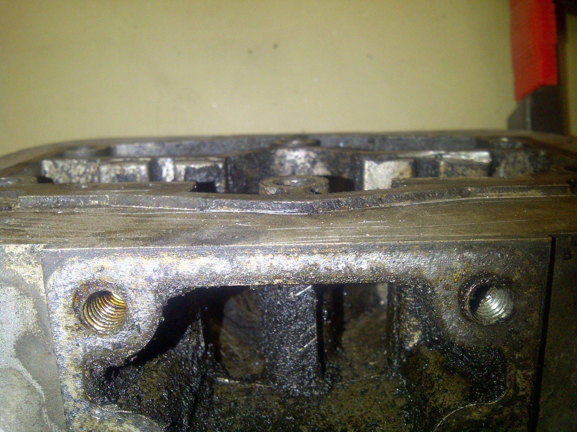

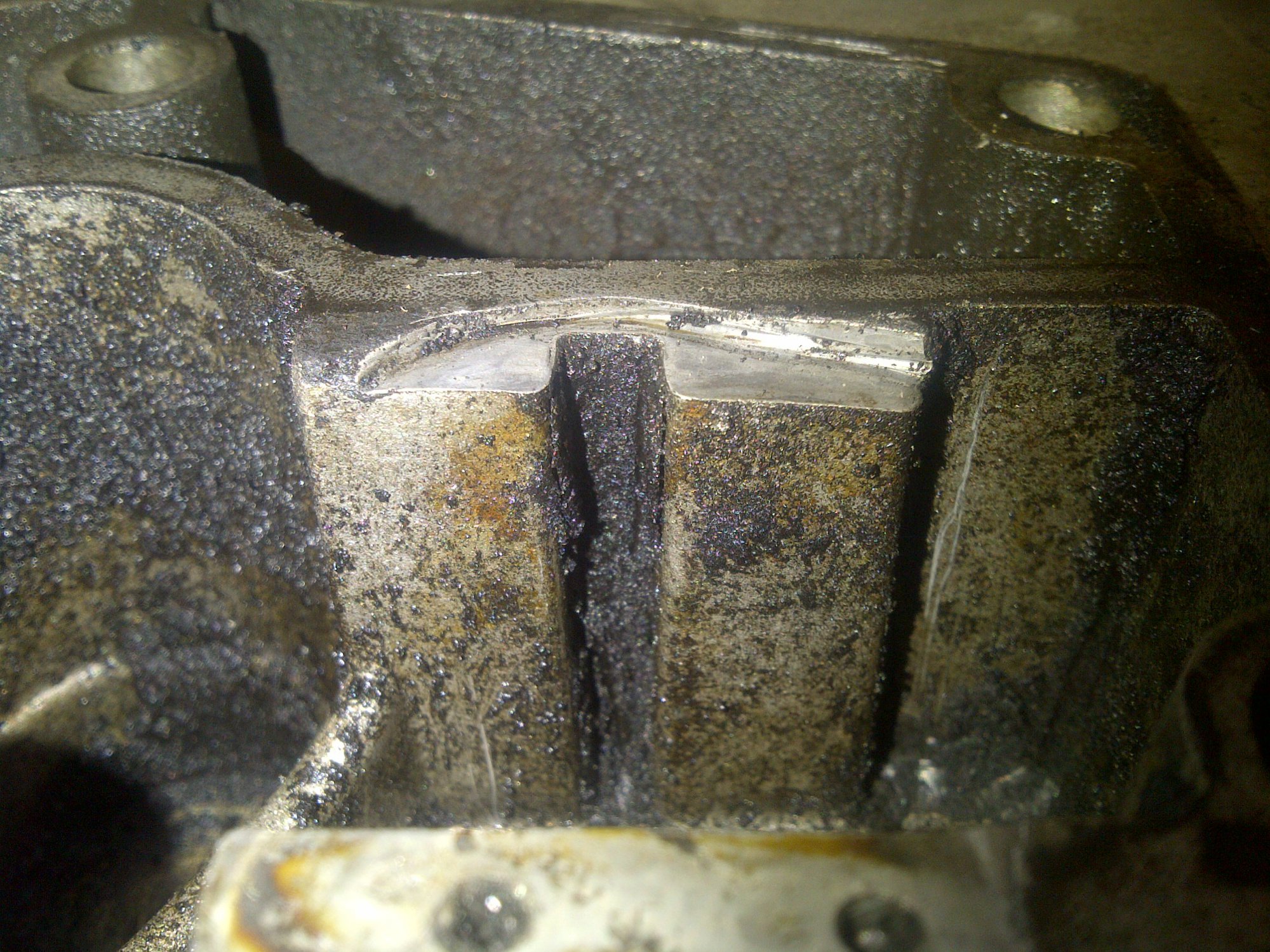

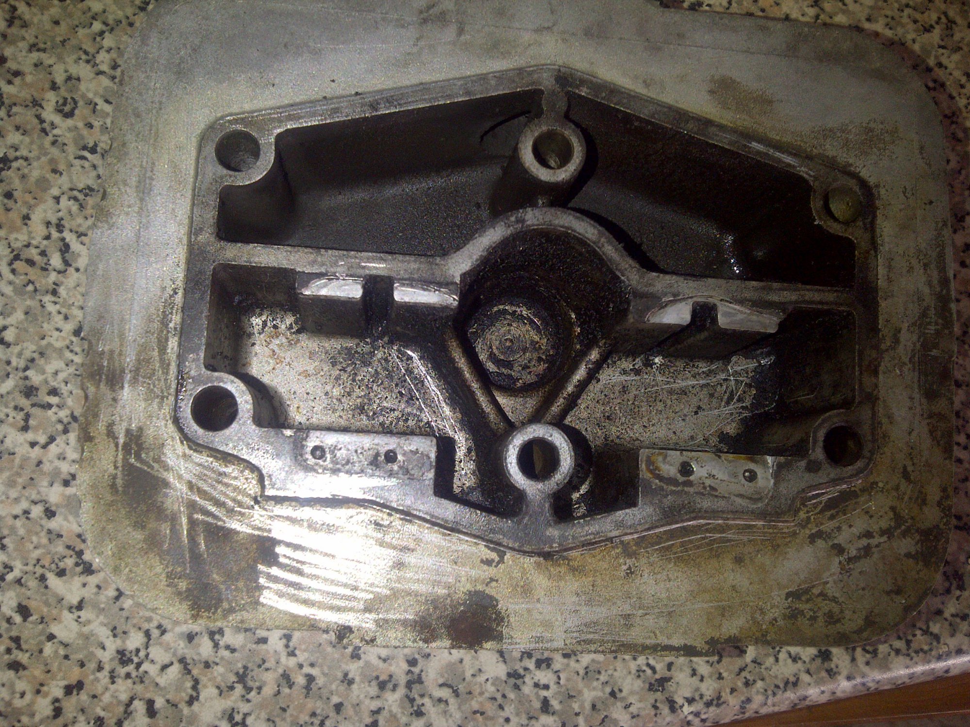

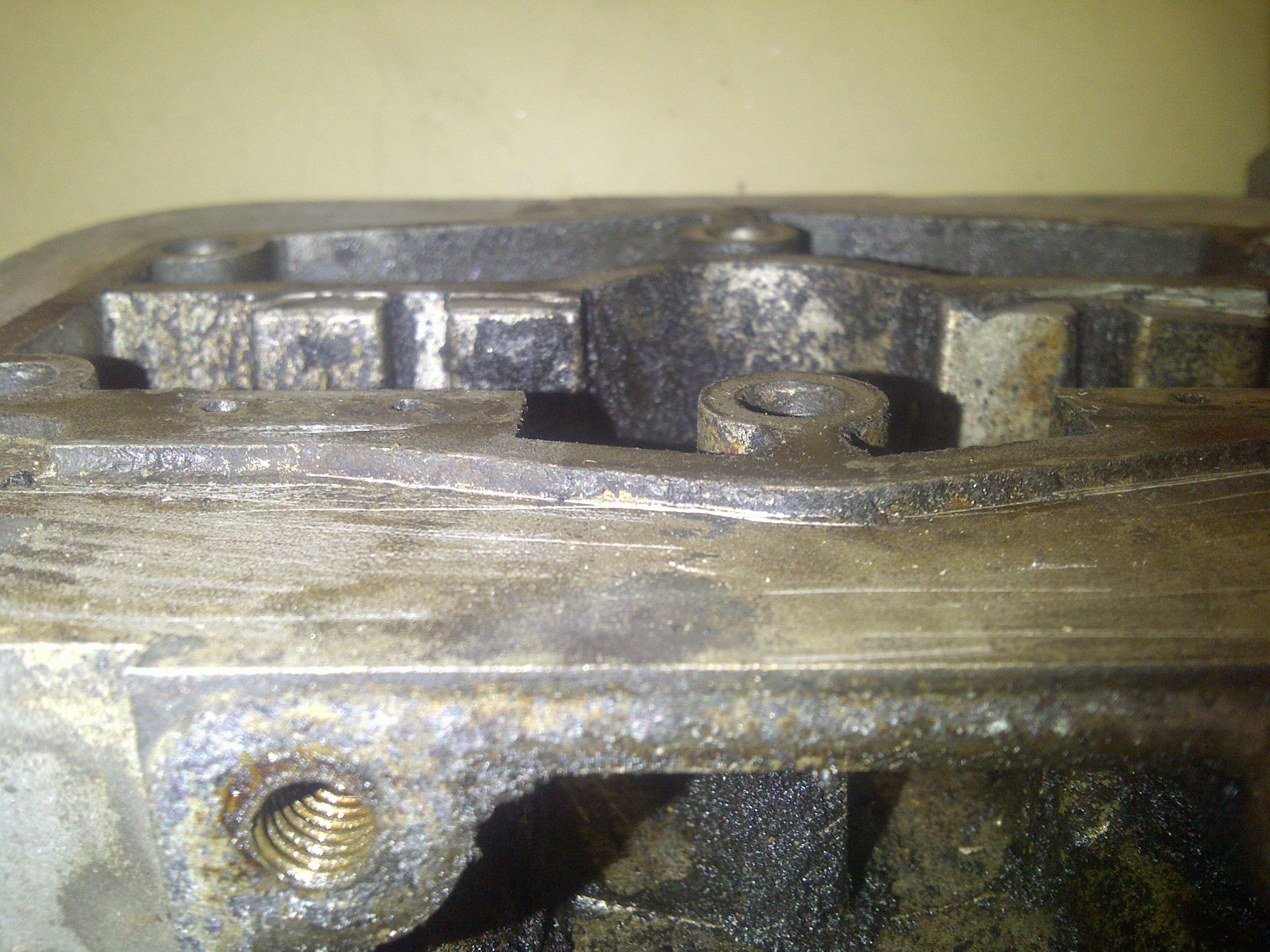

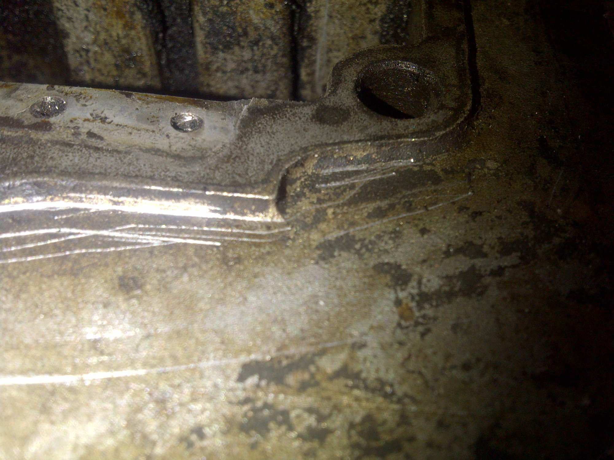

Hi, i would like to ask a question regarding a head for a compressor.
I have a 200 L 3hp, 2.2kw Aircosse compressor that has some wear on the head
where the valves were moving around as the locating pins had worn away.
I can buy a new valve plate, valves and gaskets everything bar the head.
My question is has anyone ever skimmed a head to remove the damaged area
or could it be done? The area where the valve plate sits on the head is raised proud
and if it was machined to remove the damage it would leave it flush with the rest of the head
and the plate would sit on it then and located by the bolts that keep it all together.
What are the opinions on such a caper?
Best Regards
John
