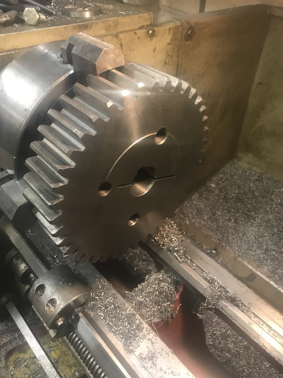

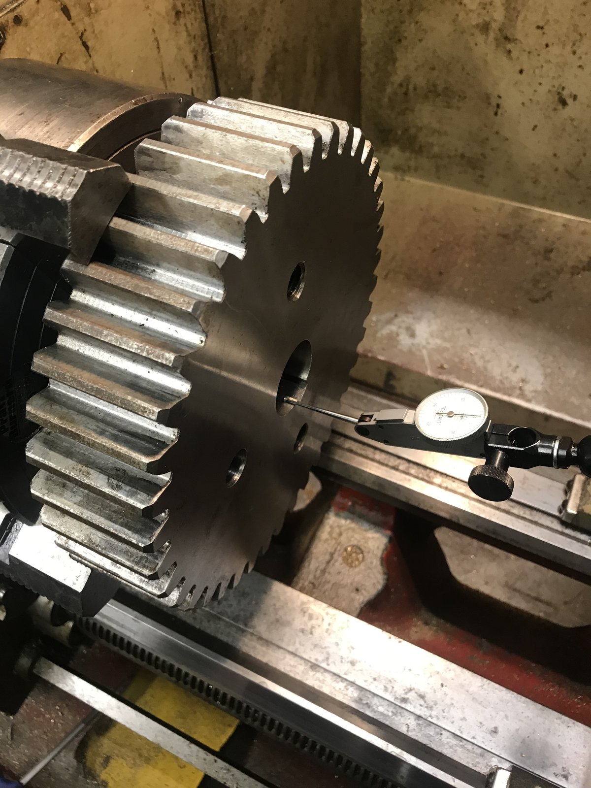

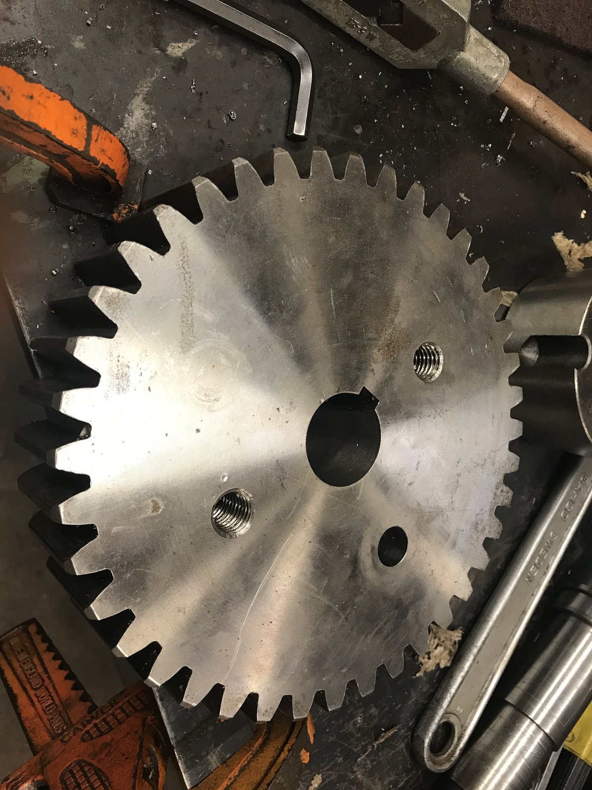

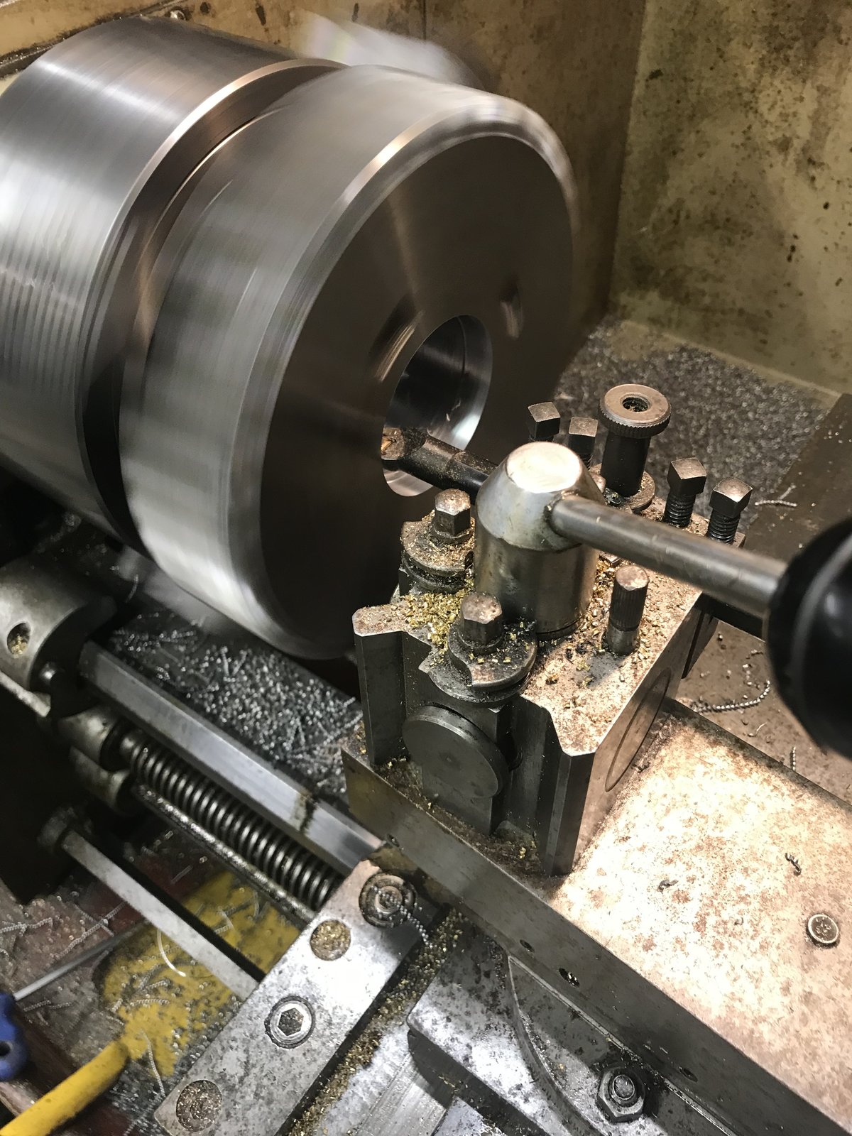

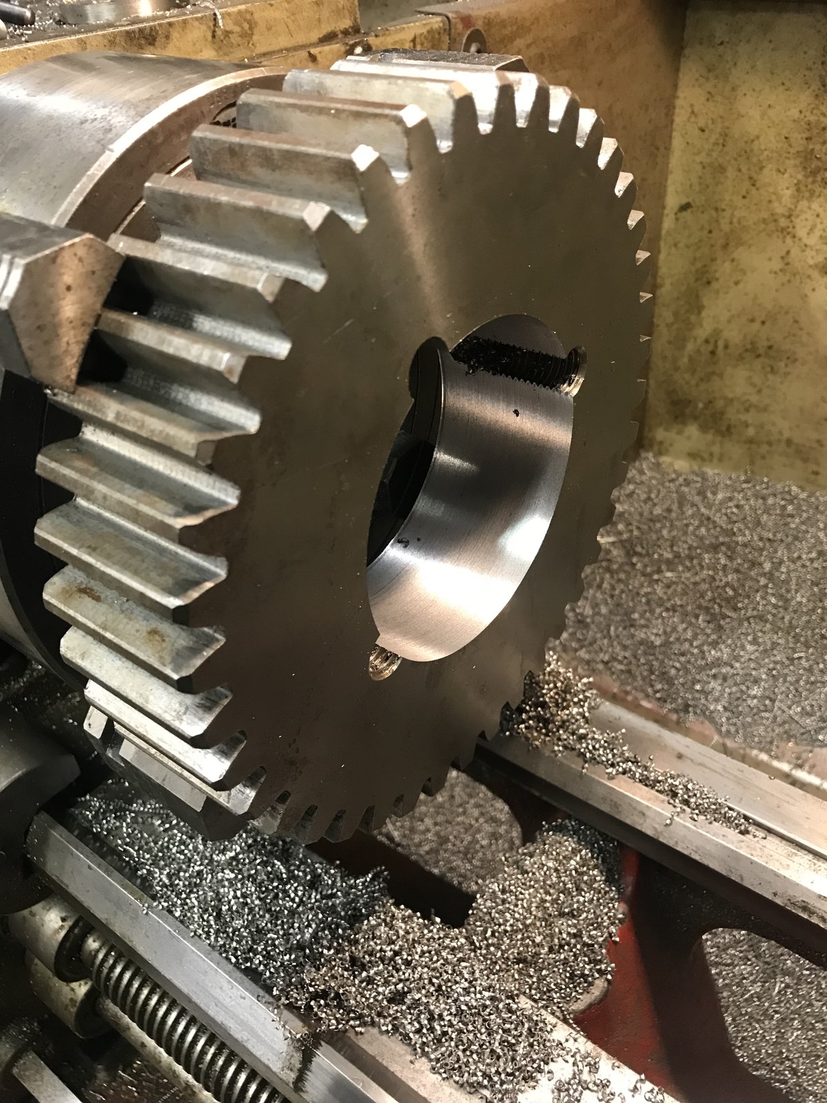

I can’t imagine it being too difficult but has anyone done it before? Is there anything to watch out for?
I would think you need to drill the grub screw holes first.
The late John Stevenson did a write up on this - it may persist on his web site
The web carries echo's:
http://bbs.homeshopmachinist.net/archive/index.php/t-49803.html
Might be easier using a taperlock flange and bolting that to the gear, just thoughts.
