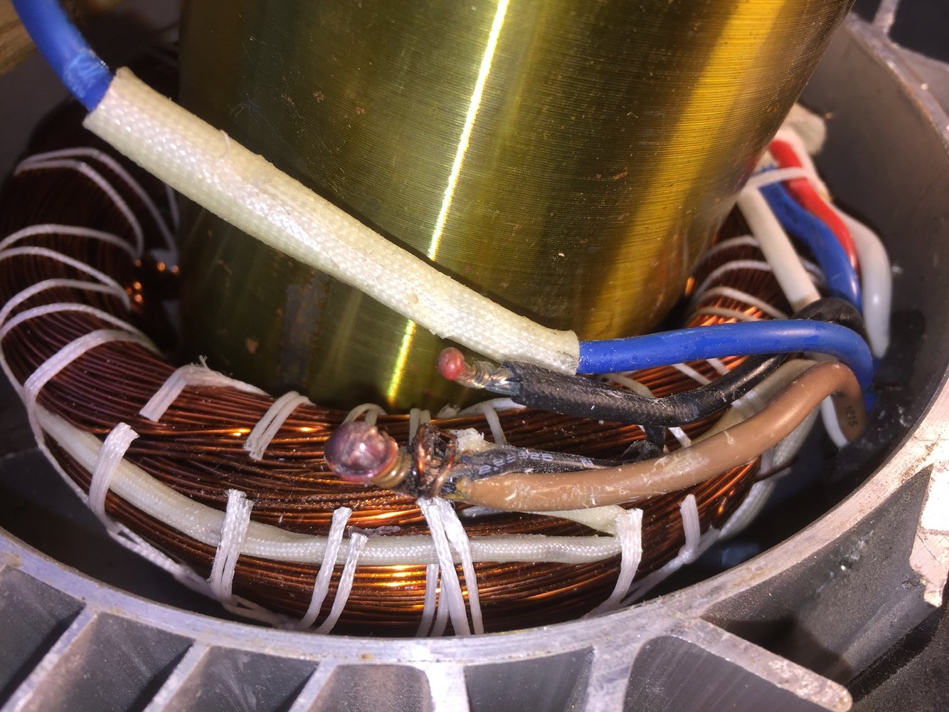

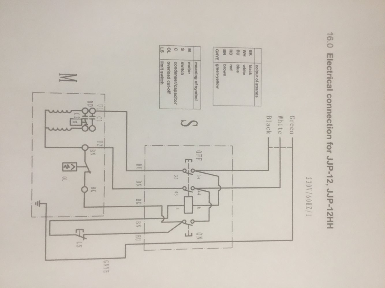

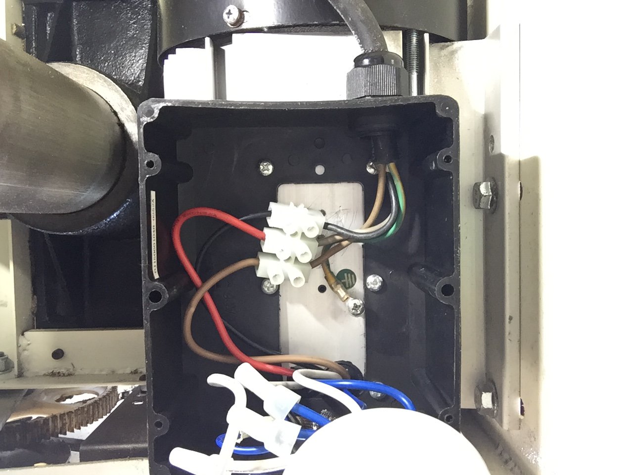

Yes it will be - it's likely the thermal fuse has suffered a material failure rather than the motor suffering a catastrophic thermal event given that it runs when you bridge the black & brown wires. Don't bother digging it out, just mount a replacement with a slightly lower rating on the outside of the windings..is that the fuse in the recess in the wires I mentioned earlier? I don’t think it’s possible to get it out, I tried earlier. If it isn’t possible to change it does that mean the motor shouldn’t be run again?
