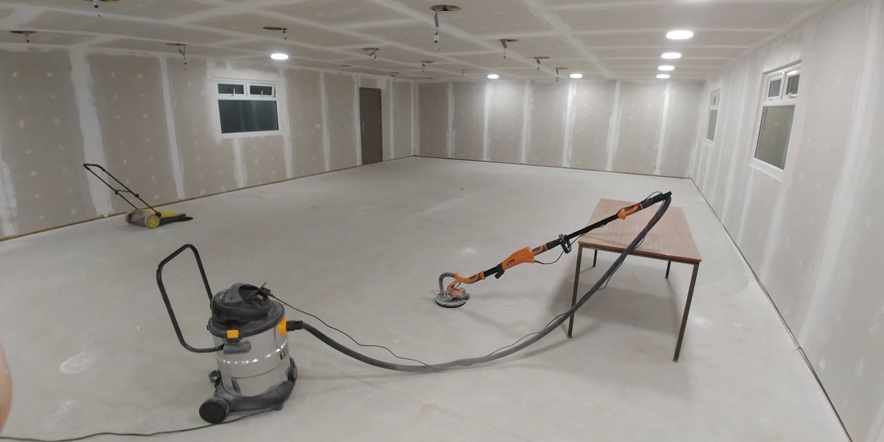

I got one last month but at 5kw it will take more than one to heat the place up even with all the insulation I have put in. I was thinking along the lines of something large and reasonablt quite to quickly warm it up and the little Chinese Diesel heater can keep it up to temperature. Trust me when I say my mrs can be a bit cold blooded. And when shes cold i have one due mate...when it comes it has your name on it iff your not fixed upSometimes I just cant win, I have decided to buy one of those Diesel Infra Red heaters for her training room and er indoors has decided to clean up and binned my vat free voucher that came the other week. Has anyone got one they are not likely to use.
for the size you have unless you have a smaller seating area not a chance warming that size of place
maybe for a sitting area close to the fires but not when training in the wide area
if this is the size of are your trying to heat up
a wood stove and a diesel heater working together would do then swap to diesel heater
you do know that a diesel heater can provide hot water as well
Think id be looking at a boiler and rads

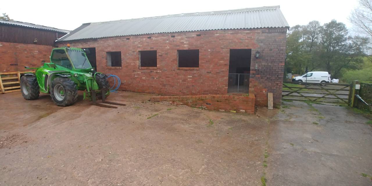

its in a field

According to research I have done I will need between 6 and 8 KW of heat to warm this building up with the level of insulation installed.
Plan A (cheapest)
5KW Chinese Diesel heater 20KW Diesel Infra Red heater for burst heating. cost £450 if it doesn't work can be used in my Machine Shed (next project after I finish this one).
Plan B
Run underground pipes from existing under utilised central heating system (20meters) and install radiators. Down side is that I want to use the building the boiler is in for holiday lets next year and don't want the boiler (in kitchen) running all the time. £1K
Plan C
New Oil boiler and radiators £2.5K+
Wood fires/stoves require user interaction. Not gonna happen......

Thanks CJ that really good of you but after today's revelation I dont think I am gonna need it. It appears I am moving on to plan B.
