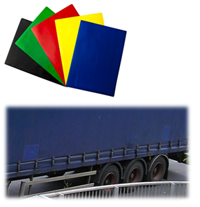

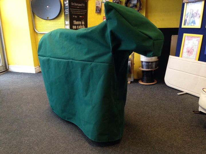

Yes,tautliner type material,just to fit when the diggers parked.
Most transport companies struggle to get rid of torn curtains, you could make your own cover using an offcut off a curtainsider and bond the corners with the repair strips/kits.
Go for the roll option 220cm x22cm and cut it in half lengthways, should easily get four corners out of that.
