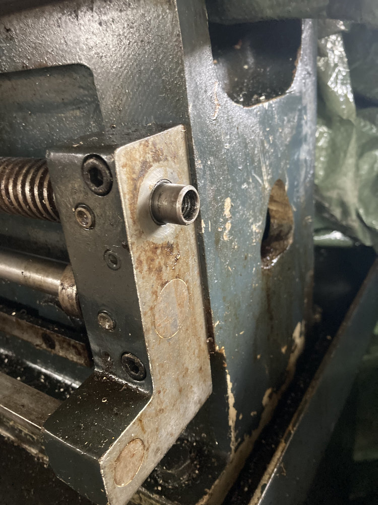

...couldn’t see this particular assembly in the manual though?
I think it is page 37 (38 in pdf) diagram 306, middle right of page when it is its in correct orientation.
£245 for a new one is pretty good tbh - have they reviewed their pricing?.
I got mine about 10 years ago now and was struggling to find anything.
I wonder if they do new nuts for the topslide and cross slides at reasonable cost?
Lovely thanks, whereabouts do I order these parts from please?D001H2-087 EACH £8.12
Iss. 2 COVER
This item is equivalent to 306013
D122H2-001 EACH £27.00
Iss. 2 LOCKSCREW
This item is equivalent to 306014
Are the two main parts then you just need a thrust bearing, think it is a 51102 but best check, about a fiver. The handle you make, on a lathe![]()
