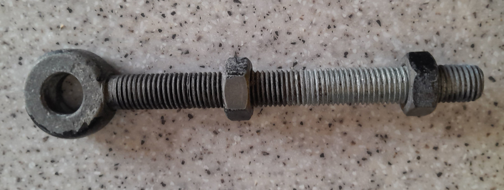

This is the actual item I have, I just want 2 in stainless steel. The hole is 16mm and the tread is M16x2Accu have M16 x 150 eye bolts in A4:

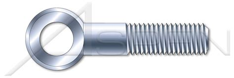

Proper gate eye bolts (which DIN 444 are not, nor is your example picture) are sized by the pin diameter (see https://www.dciron.co.uk/collections/adjustable-eye-bolts). On DIN 444 items, the hole diameter is the same as the thread diameter (so here it is is 16mm). That means the pin on which the eye swings must be 16mm.
It was the ACCU ones that were expensive and with a large lead-time too - I think that I shall be making someThey are likely not made as a commercial product. Supply and demand in a capitalist economy.
The closest you will get are the DIN444 ones and they are partially threaded. That may or may not be vital to your use. It would be difficult to convert one of them to fully-threaded (as the threads are likely rolled so the unthreaded part would be undersize).
Find someone who would weld a length of M16 stainless allthread onto the side on an M16 hex. nut* and drill out the threads in the nut.
