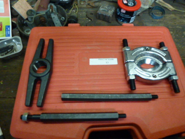

I've just bought a cheap bearing puller kit & while the construction is quite good the nuts that secure the bars onto the yoke are a loose fit on the thread. I would like to either make or buy better nuts but I measure the major diameter at 11.8mm & the pitch at 2mm which would indicate an M12x2 thread, which doesn't exist!
Is there an imperial thread that is the same dimensions?
