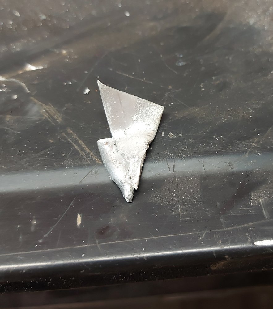

Hello everyone. I've had some joints to make in 0.8mm and 1.2mm sheet aluminium. I've tried common aluminium brazing rods, they work on thick 3mm aluminium, but not on thin sheet as the temperature just destroys the material.

) however utter failure trying to fill holes in flat sheet without distortion. I'm sure there must be a method for thin / flat sheets but I gave up looking and simply made new alloy panels !
