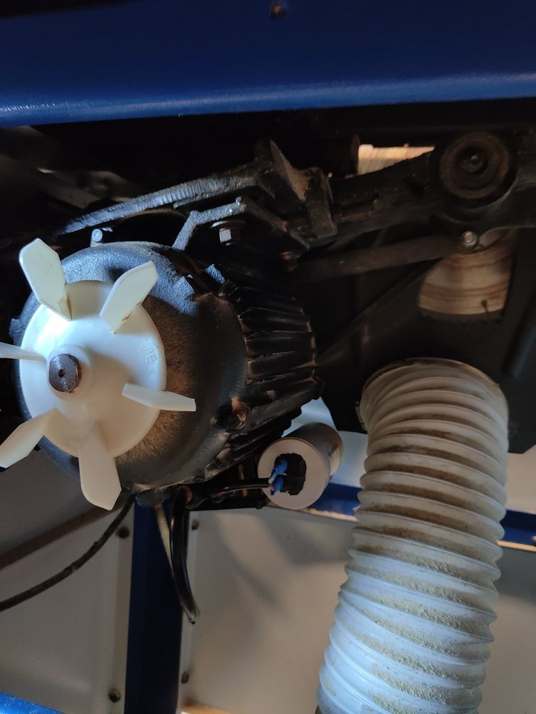

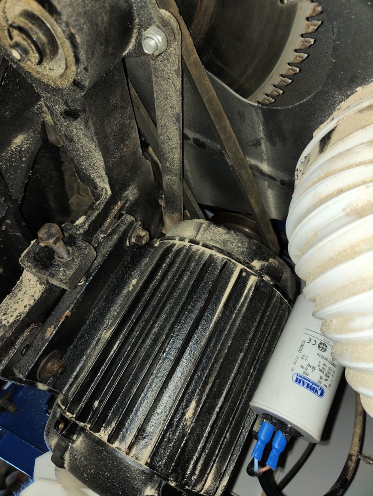

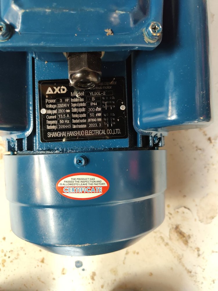

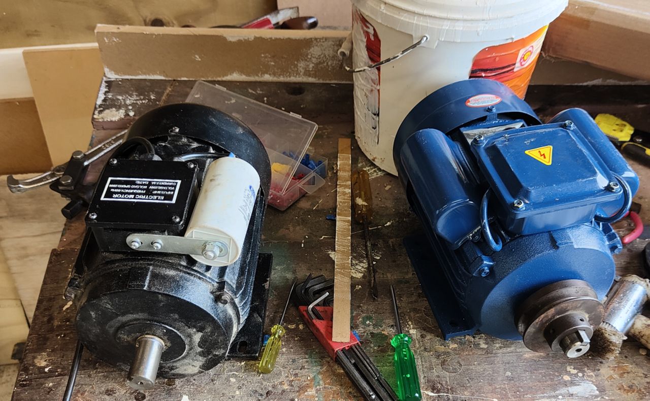

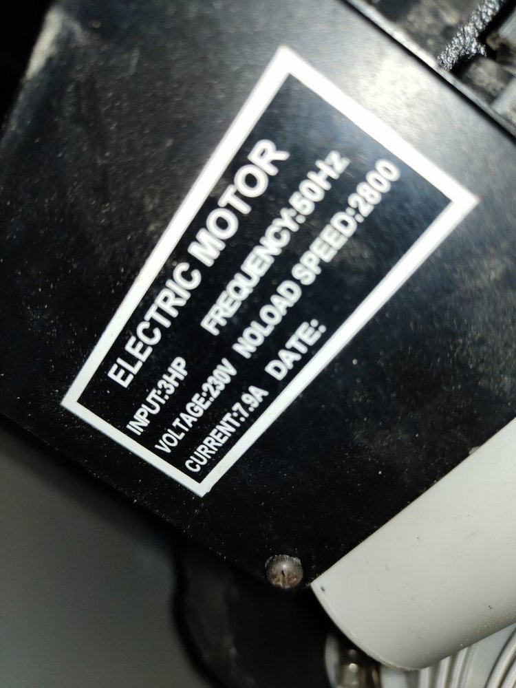

I recently bought a new to me, 2021 vintage saw bench with a 3hp 1ph motor. 8t had a known fault that it would not always spin up when you turned it on. If given a flick it would go. If had been running it would start ok. Leave it for a few hours or the next day, it would not start. It is like it has really low start torque.
I thought it might be the 35mf capacitor so replaced that but no difference.
Would a larger capacitor hepp? Any other ideas? There doesn't seem to be any mechanical issues and everything moves and sounds ok.
I could replace the motor but I'm sure it a simple problem
