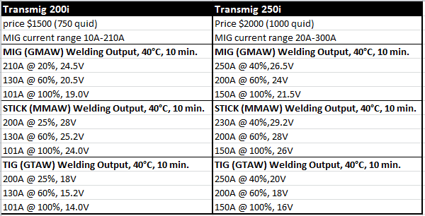

It is for workshop use, general building and repair of things like trailers, light tractor implements, commercial mowing equipment etc, as well as hobby use - possibly a bit of stainless and ali in my future, but I'm not there yet. I'm on single phase (240v) but will be getting a 30A circuit wired to the workshop. The Transmig 250i allows for a 25A supply cable upgrade to get the following specs:
My questions are:
1. What sort of stuff can I do with 10A that I can't do with 20A?
2. What sort of stuff can I do with 250-300A that I can't do with 210A?
3. What sort of stuff can I do with stick that I can't do with mig on the same machine?

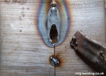

Bonus question: am I the only one who sees something else in this image?!
My questions are:
