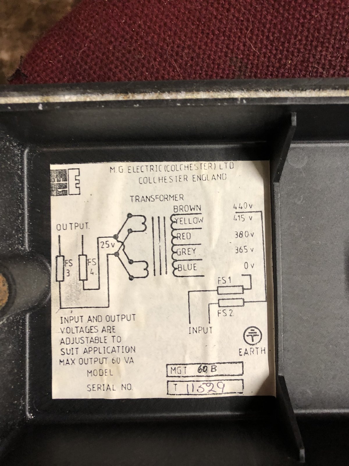

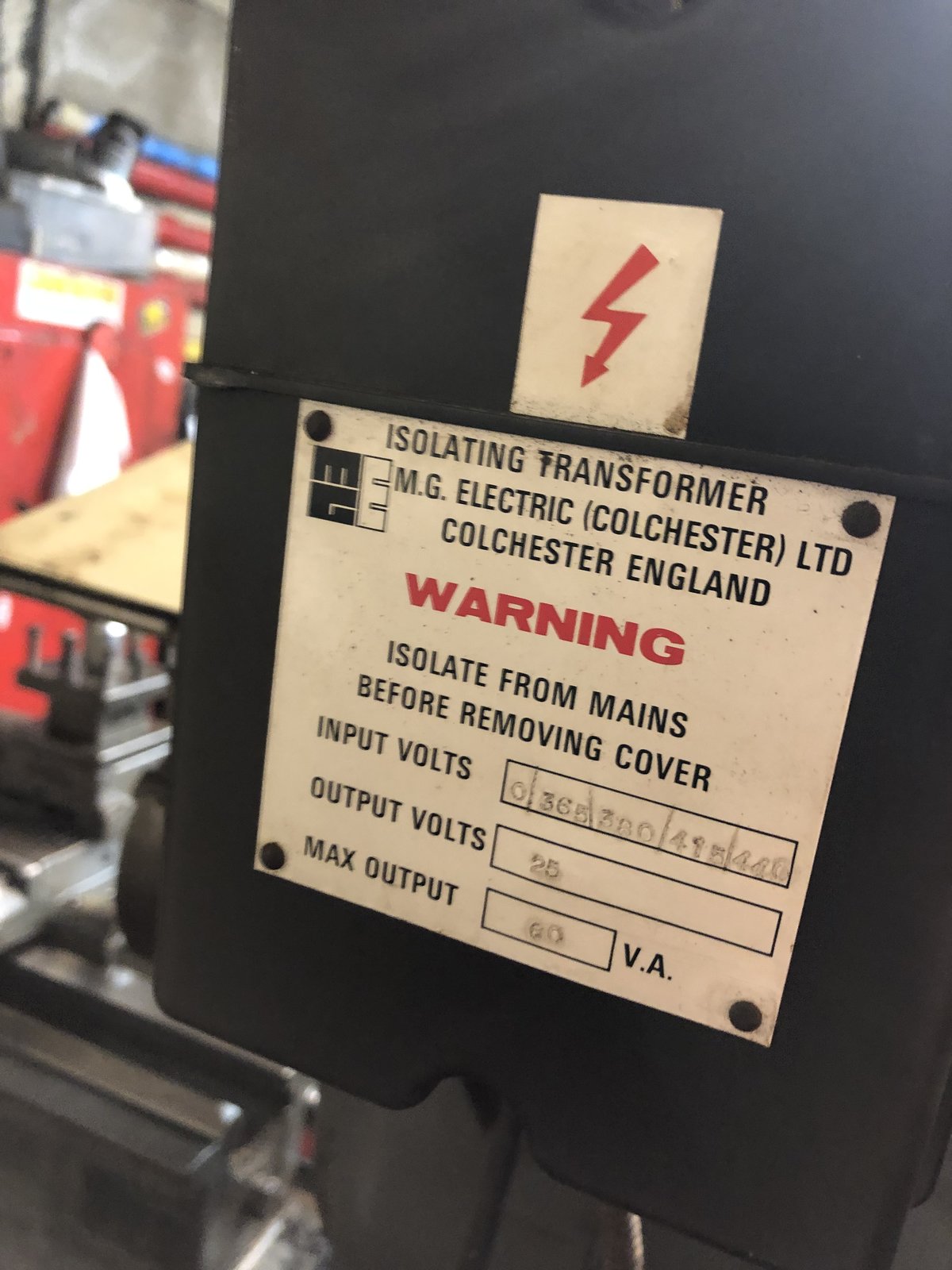

Hadn’t considered that actually but in the end I found a flexi head 12v machine light I had from a while back, fitted the bulb holder into the lovolite shade and used the 12v transformerOr wire it to 230V and fit a 12V bulb?.
