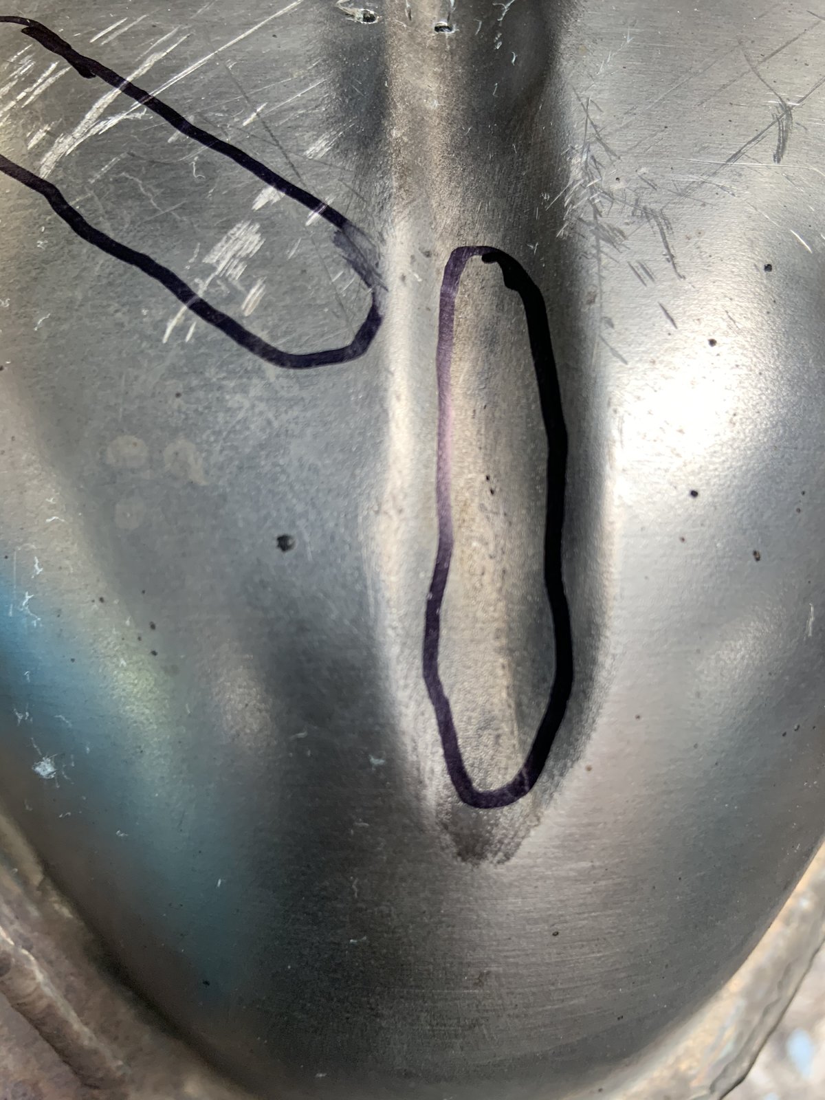

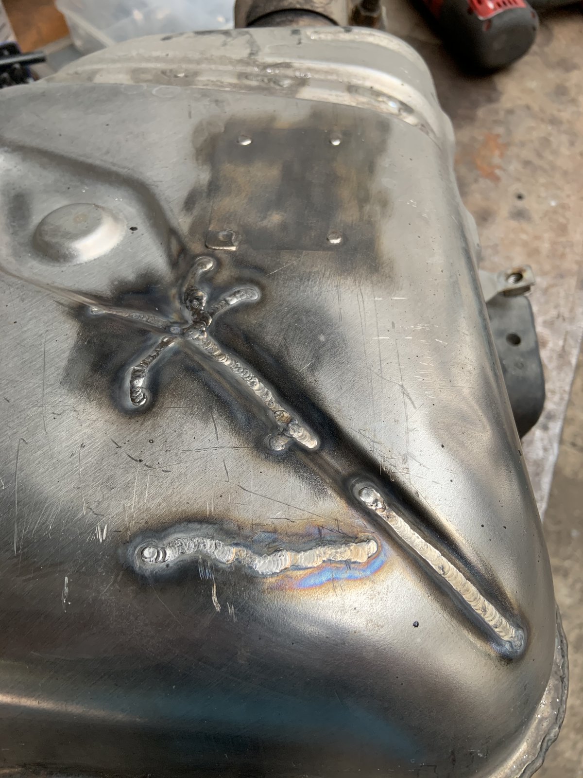

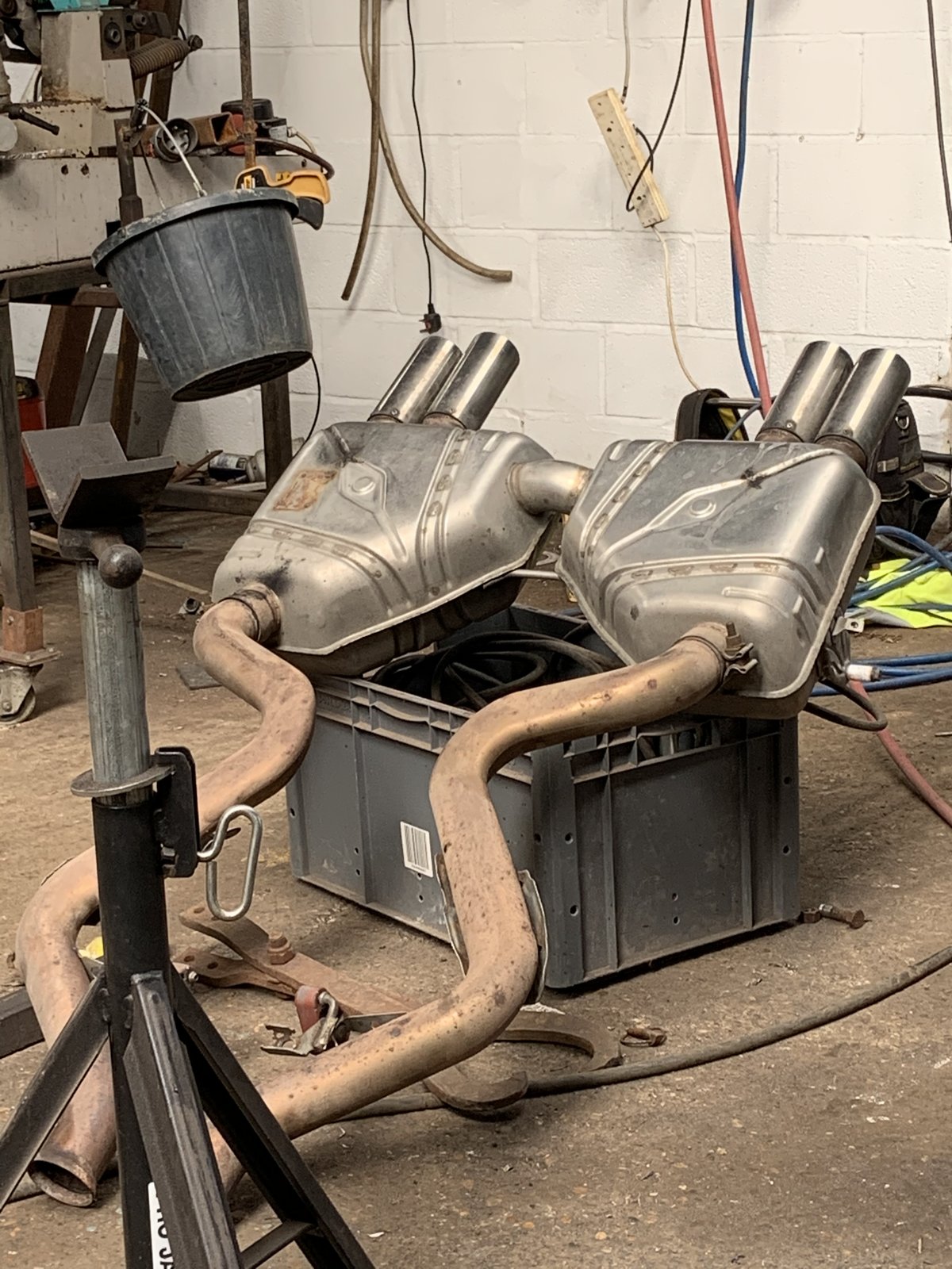

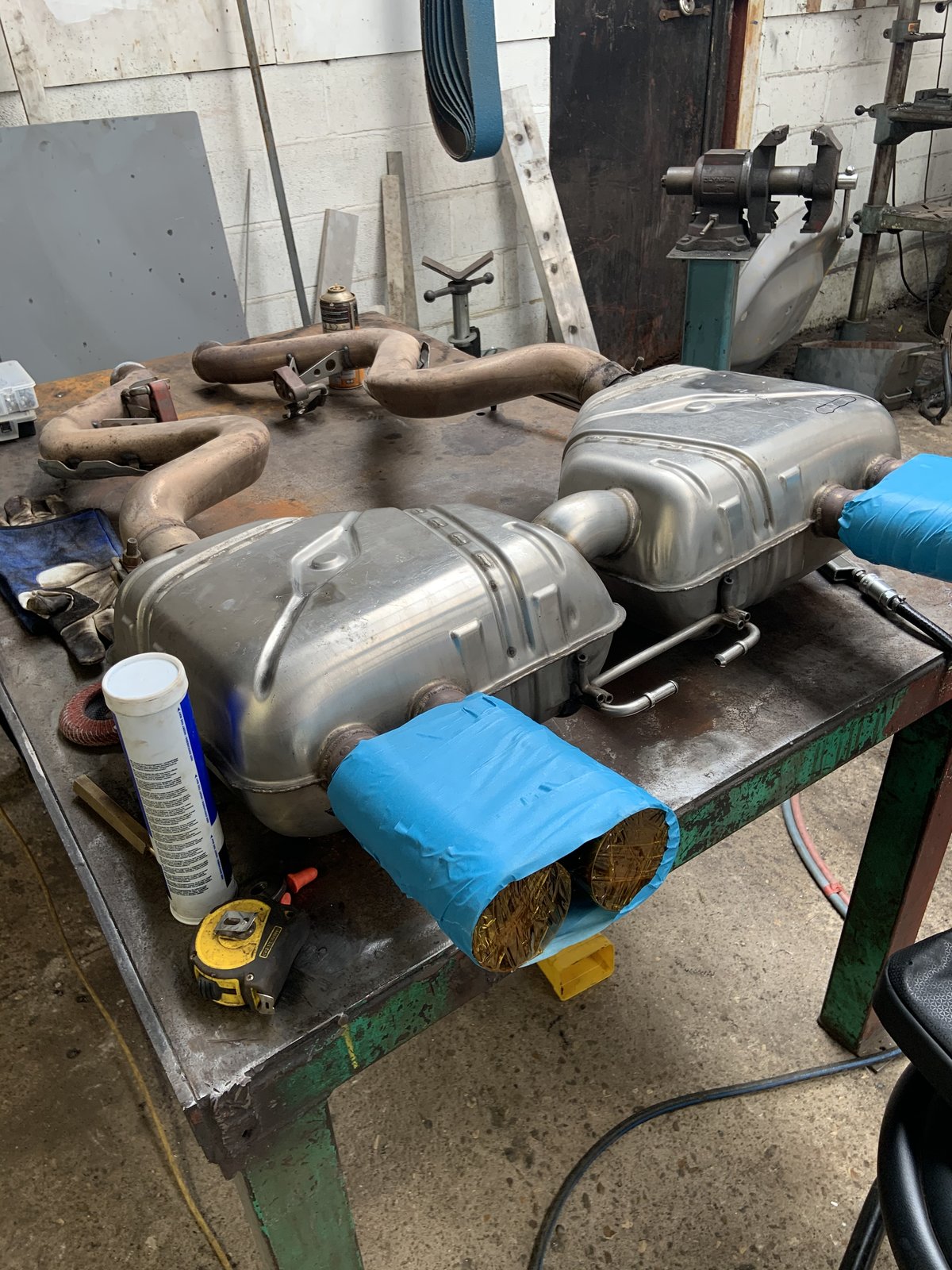

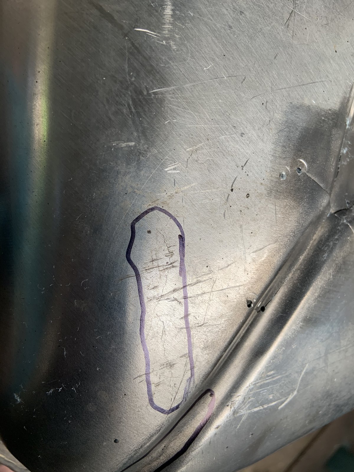

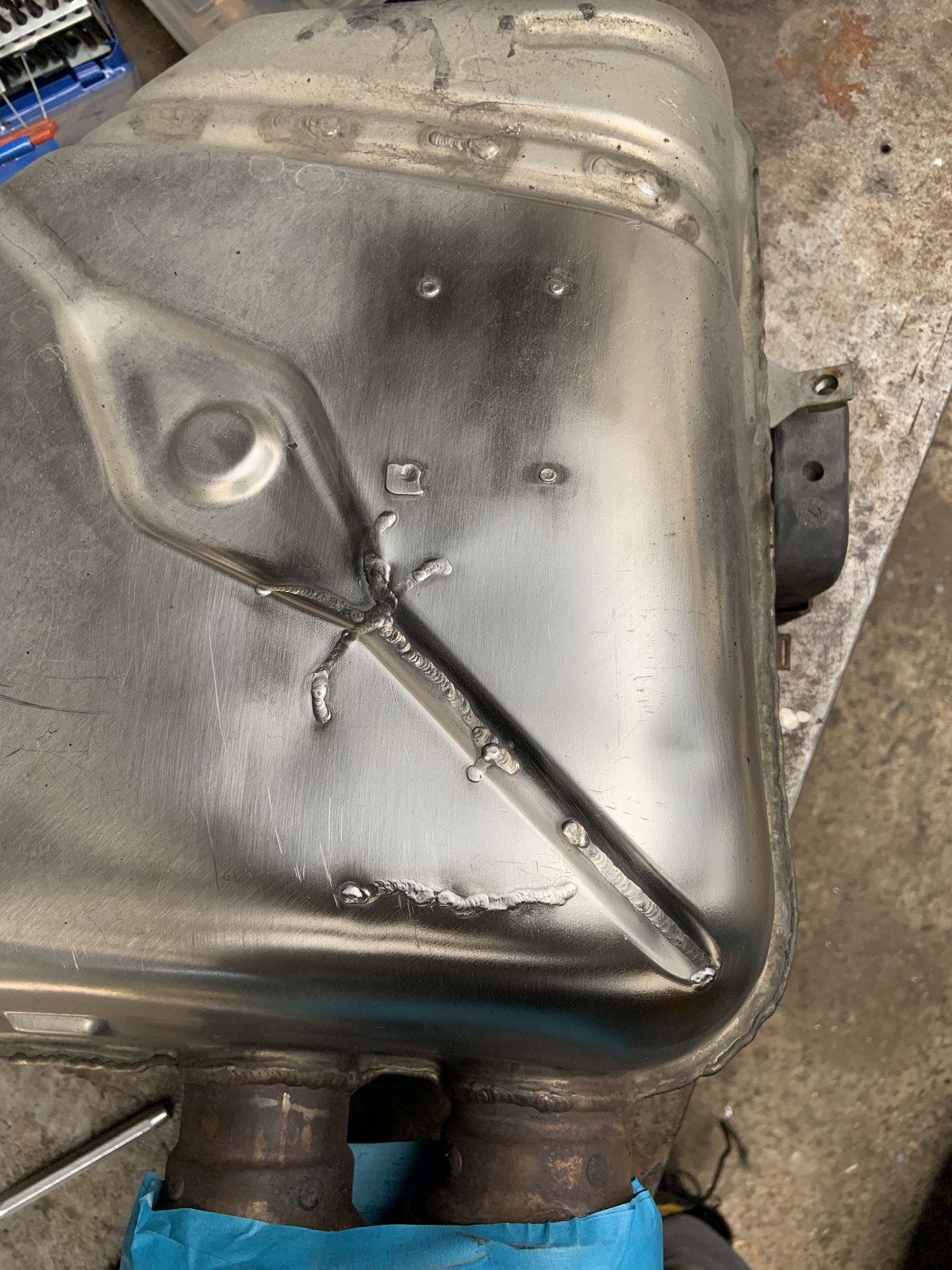

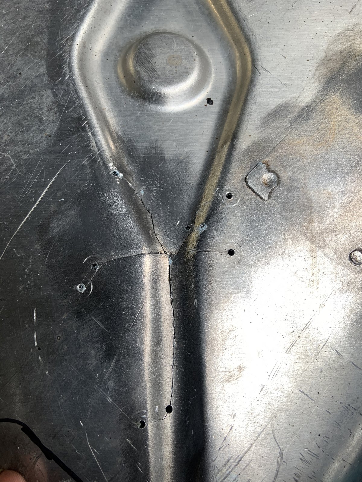

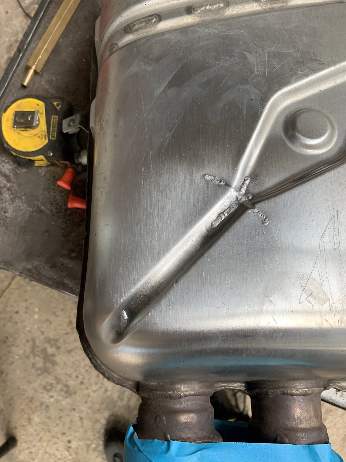

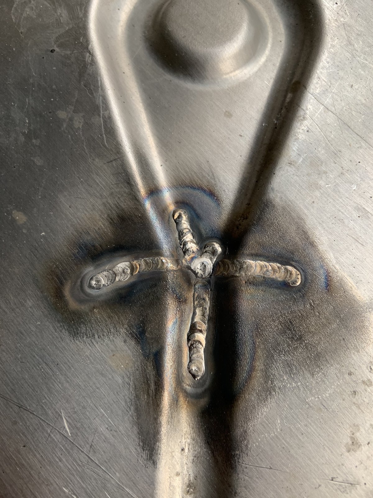

All done. Welded pretty good considering the only cleaning was stainless brush and acetone.

Good luck, inconel isn't the easiest to work with
Just out of interest how long did a job like that take ?All done. Welded pretty good considering the only cleaning was stainless brush and acetone.

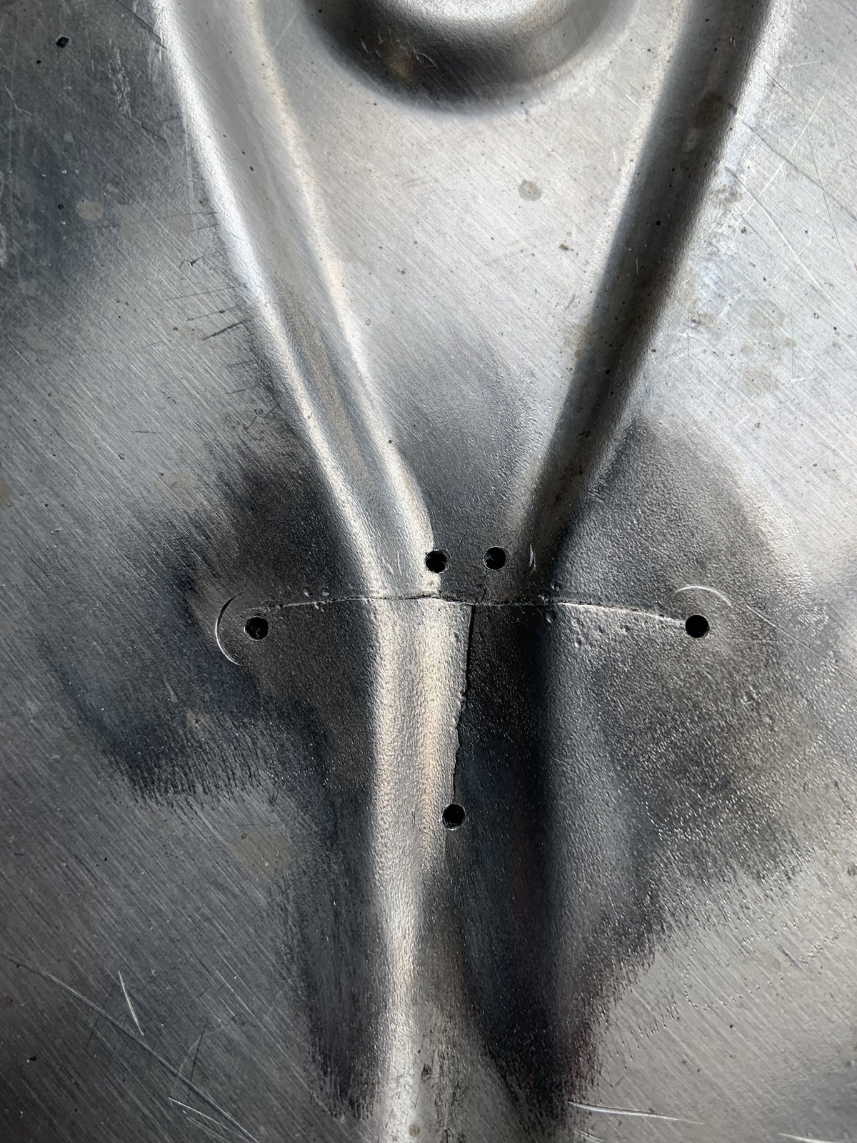

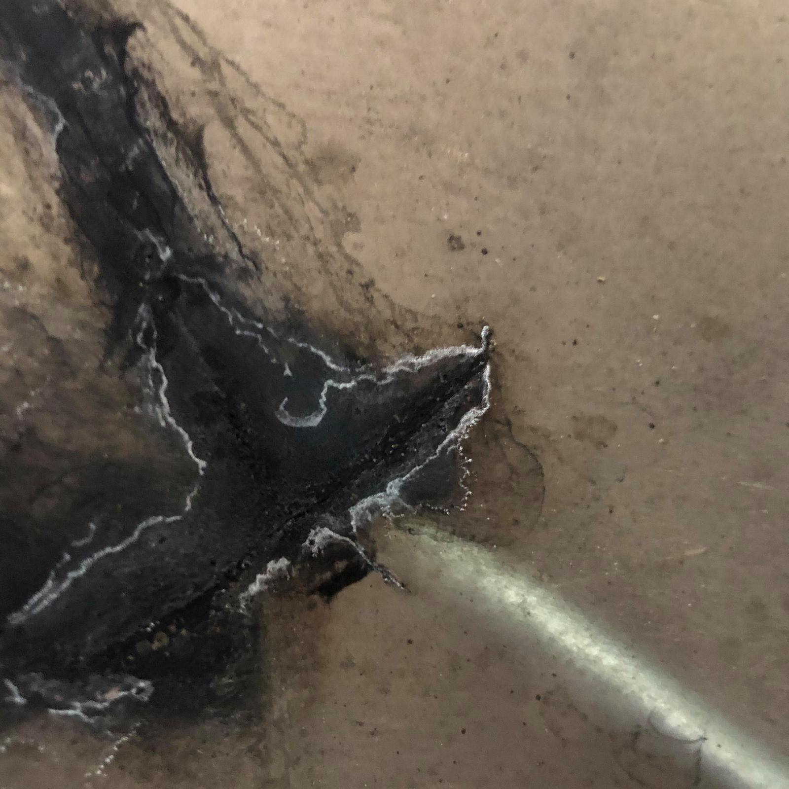

Including drilling the ends of the cracks, purging for a good 45 minutes turning the part, Welding and buffing with the burnisher about 2.5 hours.Just out of interest how long did a job like that take ?
Simple question - how can you tell its inconel. And what filler rods do you use?
