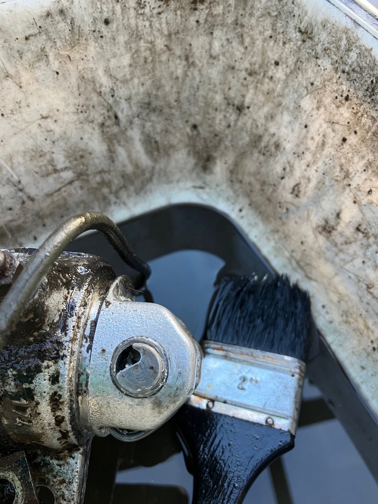

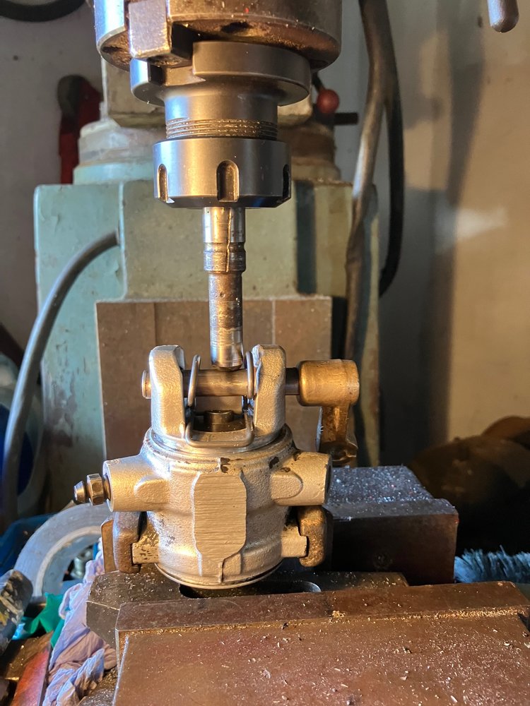

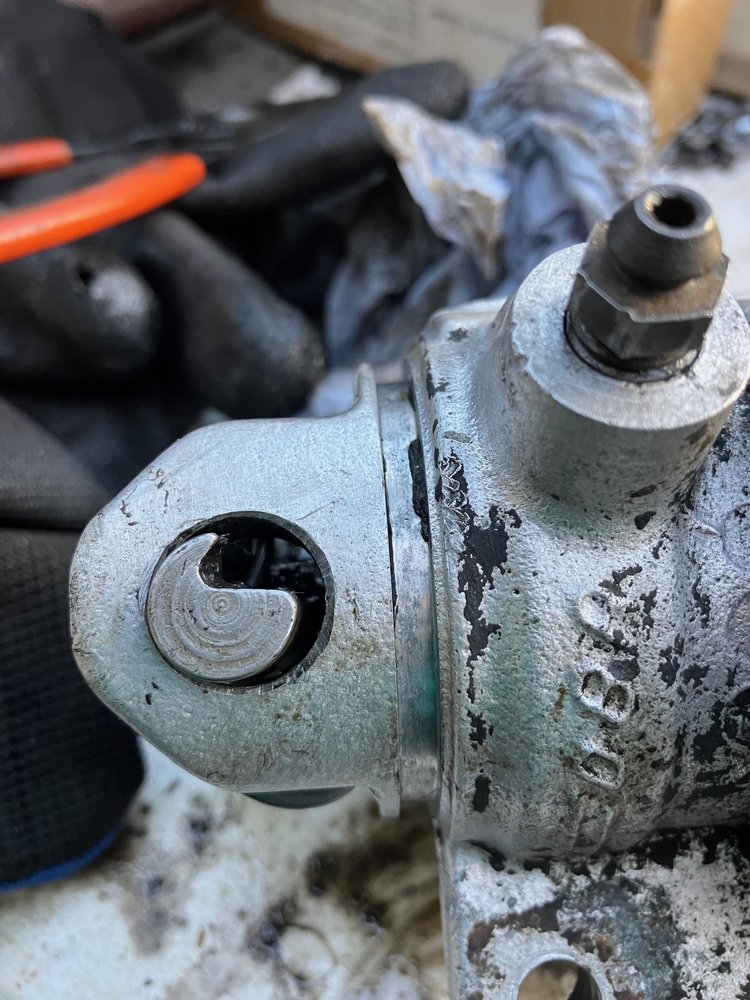

Job creep on this one. A simple service of the rear brakes turns into a job. Got the callipers off and on the bench to service them. No 1 both flexible hoses had collapsed order new. Inspect the callipers and found a bush missing how on earth this has disappeared I have no idea. Interesting job all the same never been inside one of these with H/brake operating the foot brake piston. So strip down turn up a bush and press in, ream all fine then to put it all back together there is a bellville spring which was to thought to compress by hand. is could not get the h/brake actuating rod back in. walk away and think about a solution I came up with mounting it in my miller to compress the spring it all worked well result all fitted back on the car and works fine happy bunny.
