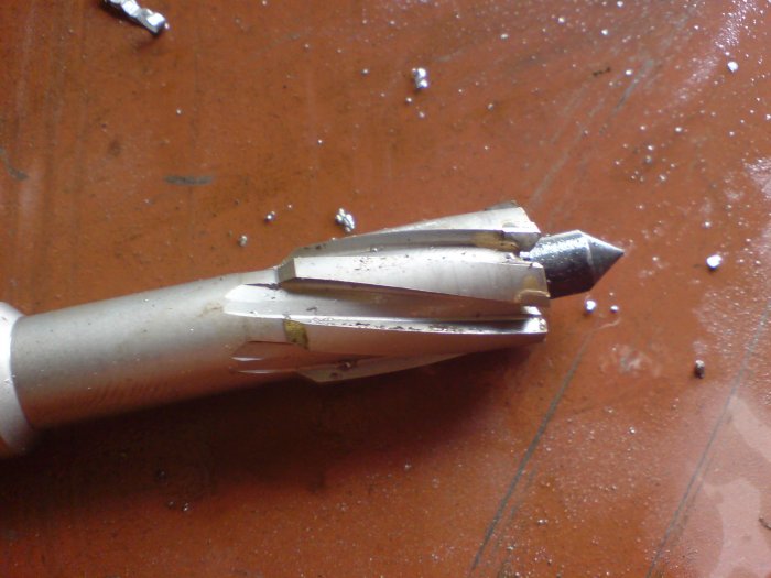

Hi Chaps, I have to drill lots (about 30 per week) of 32mm holes in 2.5mm-3mm mild box, I use a 'Faithful' 32mm hole saw and cutting fluid-it works ok but is a bit hard work getting through. Any body know any really good holesaws for steel-is it worth looking into getting an adapter for my drill to take those mag drill rotabroach bits?? I also drill loads of 10mm holes with a good quality bosch drill bit and same question applies?? Also I use a rexon pillar drill, about 700w i think, it's reasonably heavy duty but do you think something bigger might make this task much easier??
Many thnaks in advance, Neil
