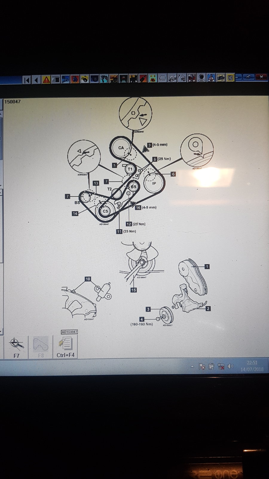

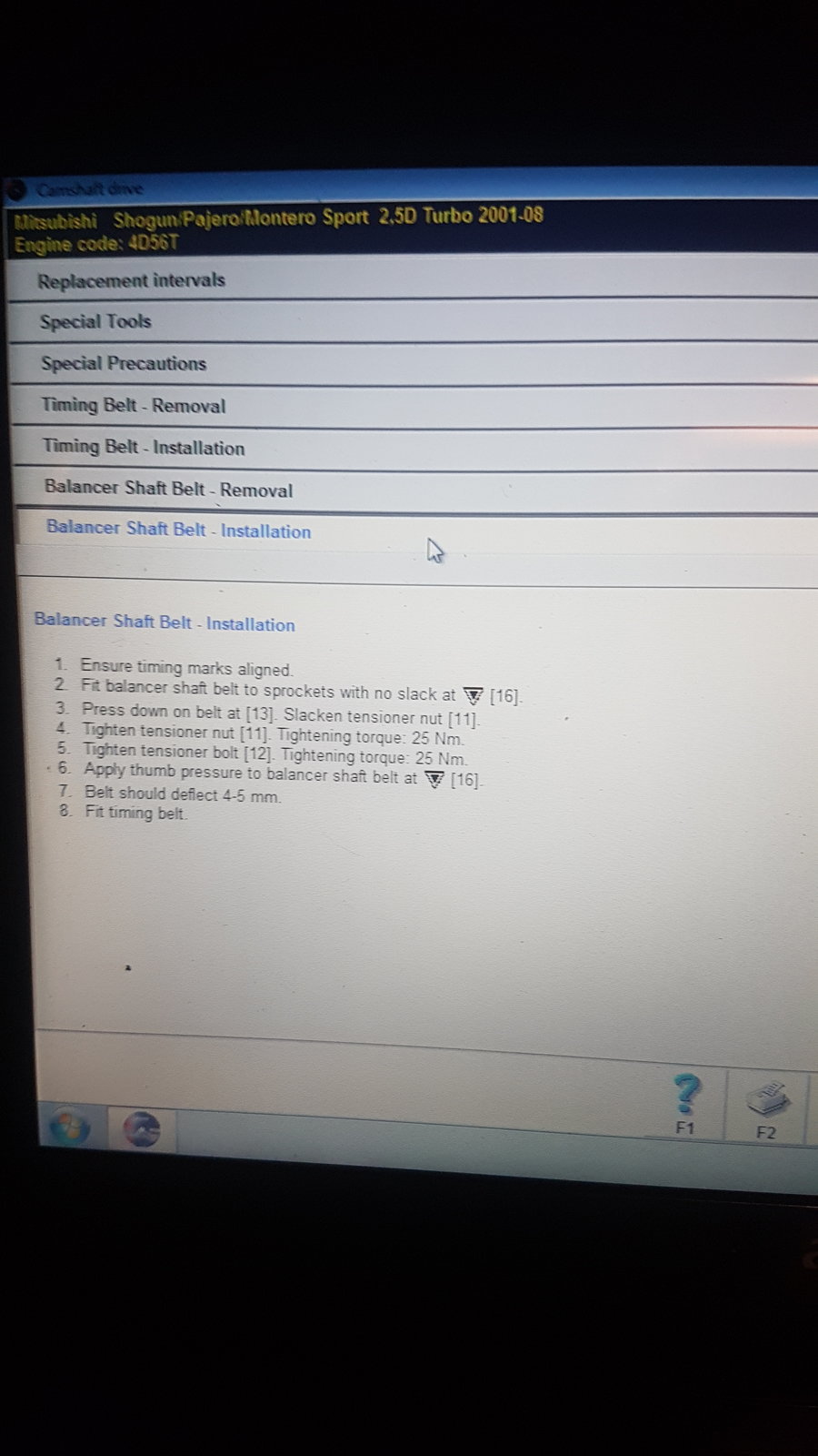

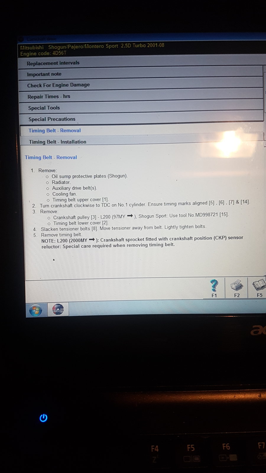

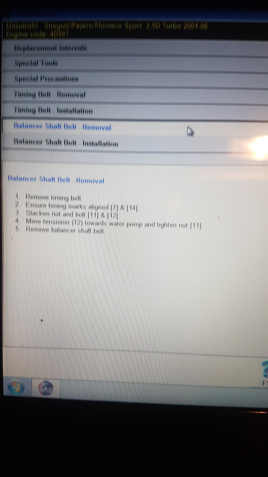

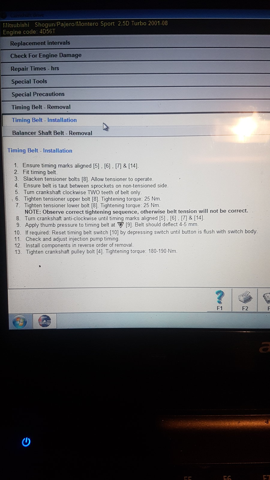

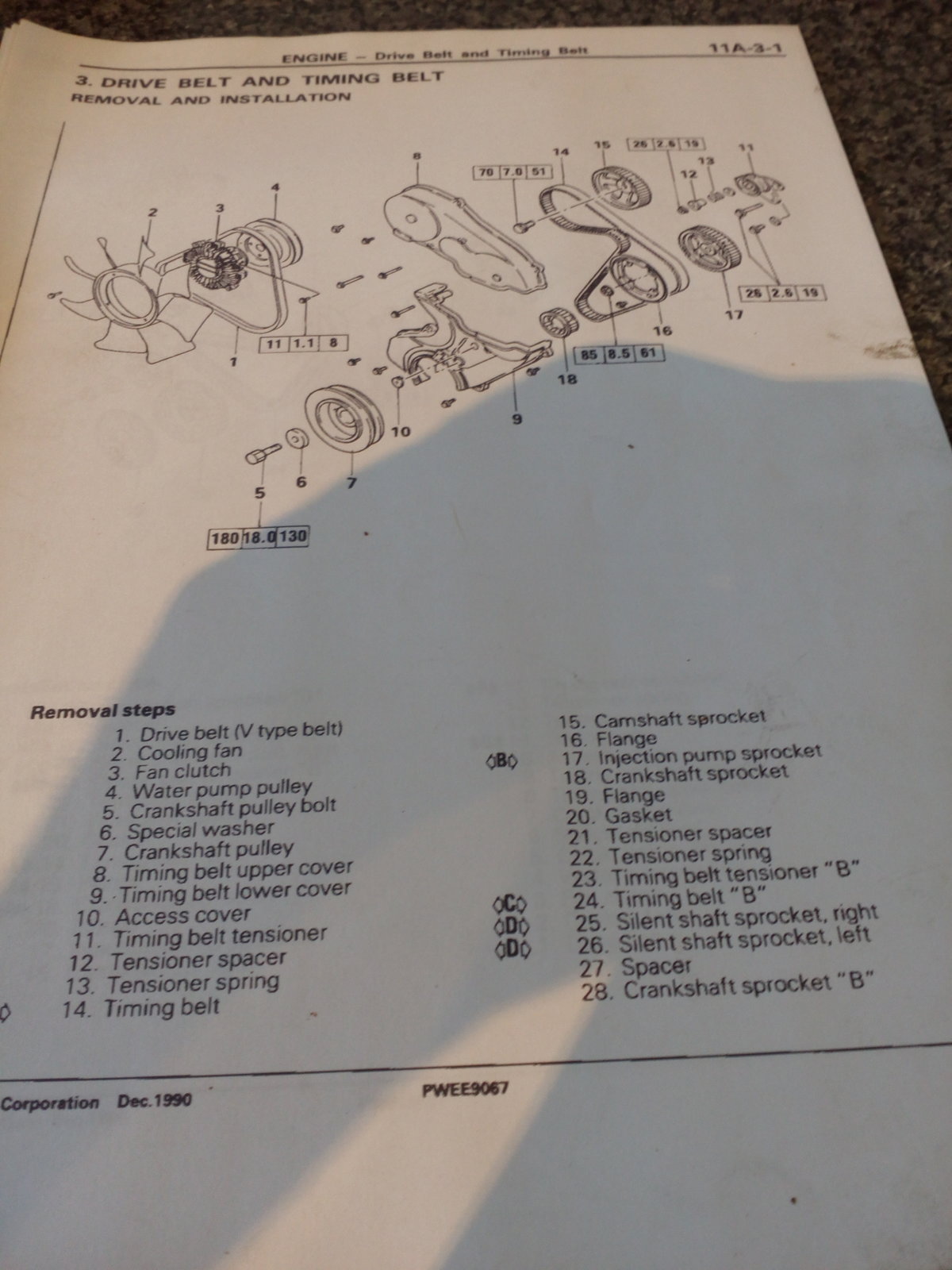

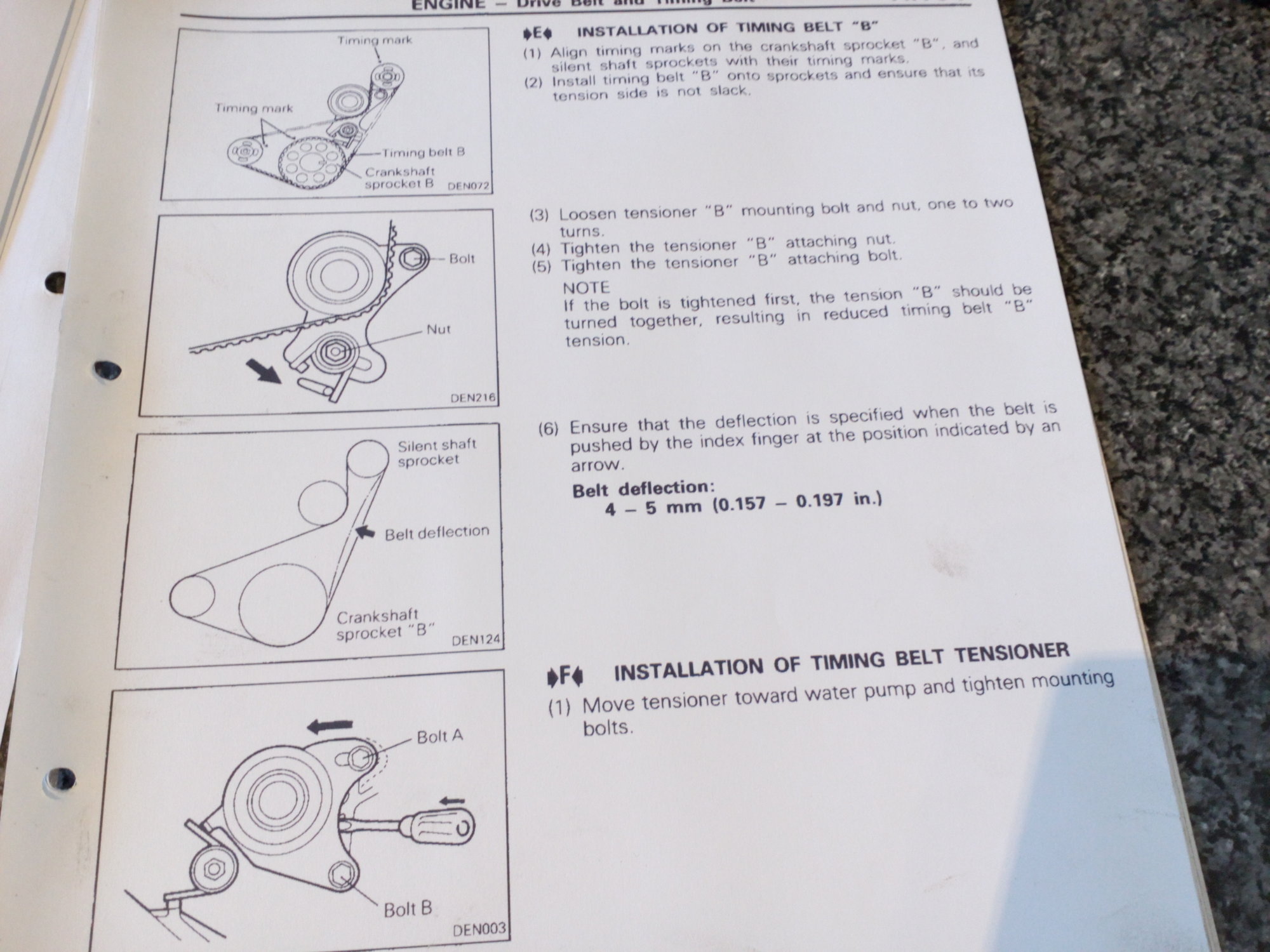

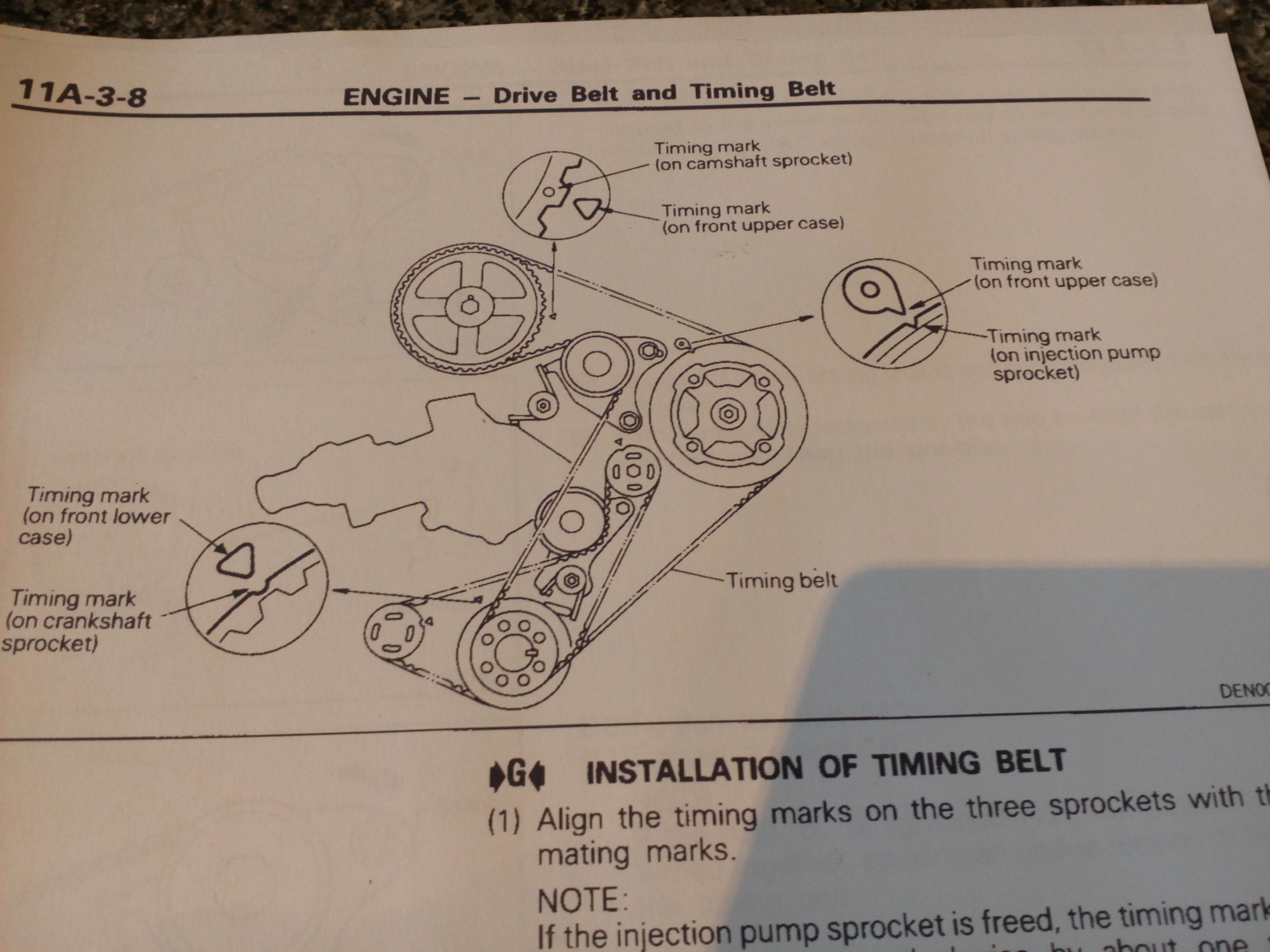

Sorry to drag this one up again, but there were some knowledgable replies above.
Having had a bit of spare time to have a look at this again, I got it running this morning, but it runs like a bag of spanners, so I can only assume I’ve got the injection pump out of alignment some how.. Is it possible to be 180 degrees out on the 4D56?
@Ian James @anto44 @8ob
no but if you had the pump off you will need to adjust the pre lift on it
