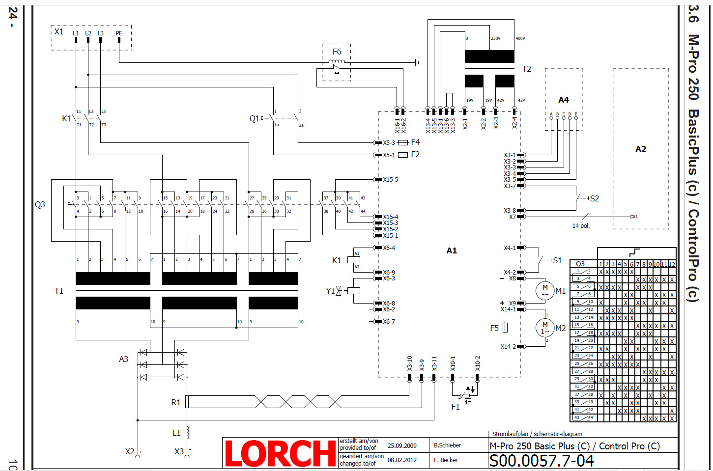

I have a Lorch M-Pro 250 semi-automatic machine (3-phase, transformer) in repair, which has a range switch 1--12. Unfortunately, ranges 1-4 do not work at all - it looks like a broken range selector. (I think it does not connect on these ranges, Ranges 5--12 work properly )
Does anyone have a wiring diagram for this machine?
