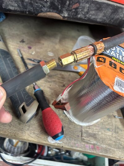

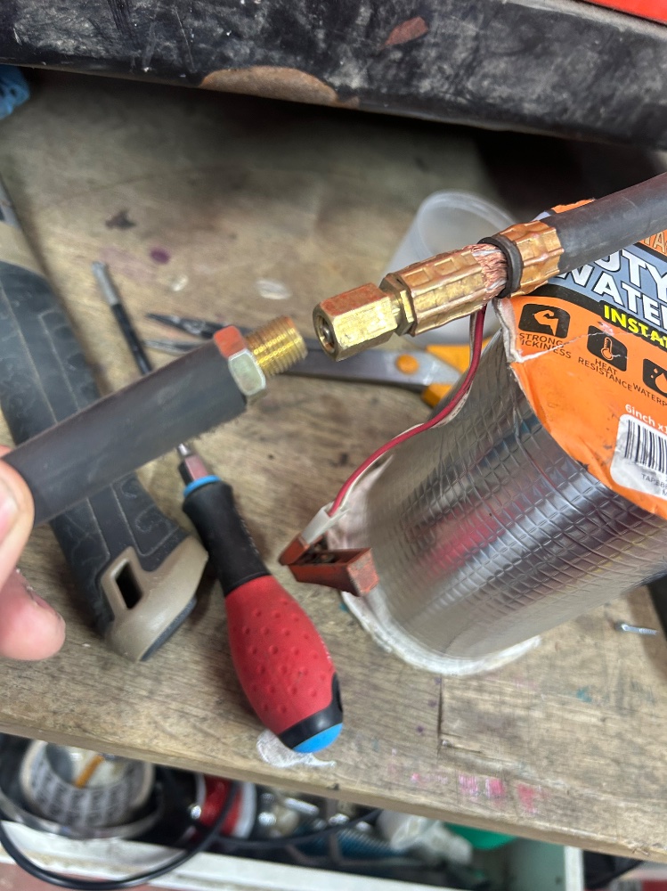

Post a photo of your torch and the swan neck with it removed, it's probably a standard euro torch neck.Found the problem but sill looking for a swan neck

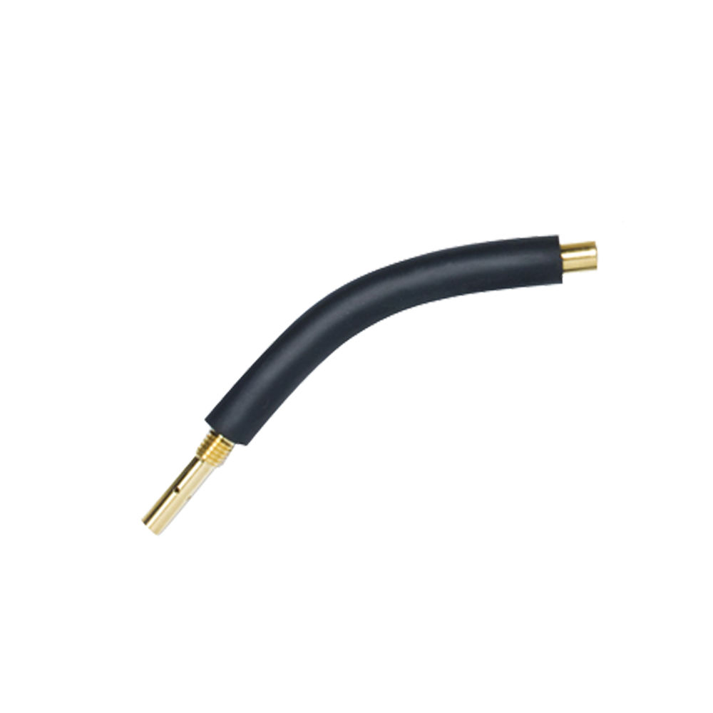

Is the swan neck in the photo a 10mm thread?I haven’t got the old one the nut is really small
Thank you it looks like the mb14Is the swan neck in the photo a 10mm thread?
https://www.ebay.co.uk/itm/162205428886 This shows an MB14 swan neck with a smaller thread than the MB15 which is an M10 x 1.0mm but you will have to check for yourself as I don't know for sure, there are 2 thread pitches available too.
Another option, if you know it's a good welder, would be to fit a Euro socket and buy an MB 15 euro torch.

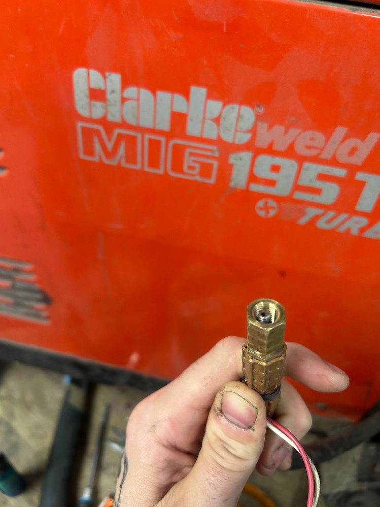

That’s the one I got and it’s to bigClarke do the hobby torch and the Industrial torch on their migs that have the torch directly attached, i.e. not a euro torch.
You have the Industrial torch on a 195TE Turbo.

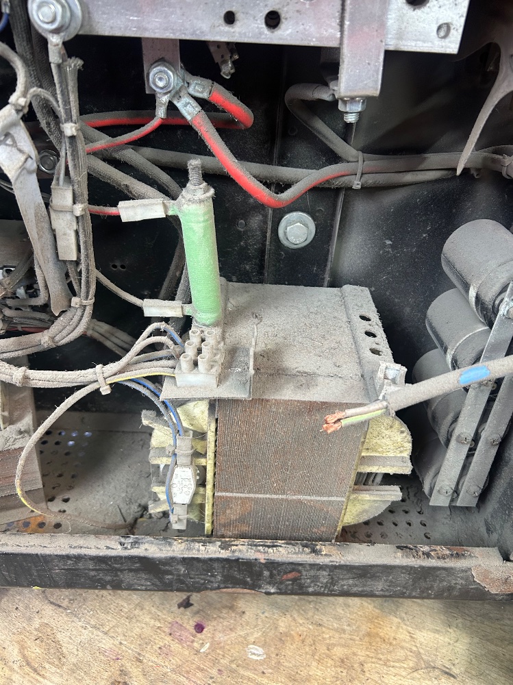

thank you I will have a look tomorrowis the other transformer loose too , on the left in the pic , it looks like its not where the rust stain is either
The mb14 fits perfect thank you again just got to find tips now and gasIs the swan neck in the photo a 10mm thread?
I think bits such as torches are common to several makes & models as they are bought inThe only tips that fit are ones for a sealey but it’s a Clarke welder
