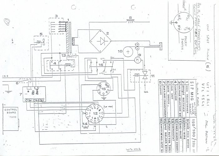

A AB-POLAND New Member Messages 1 Location Poland Feb 26, 2014 #1 Welcome. Looking for a scheme to SIP IDEAL 180 - old model: Thank you in advance!

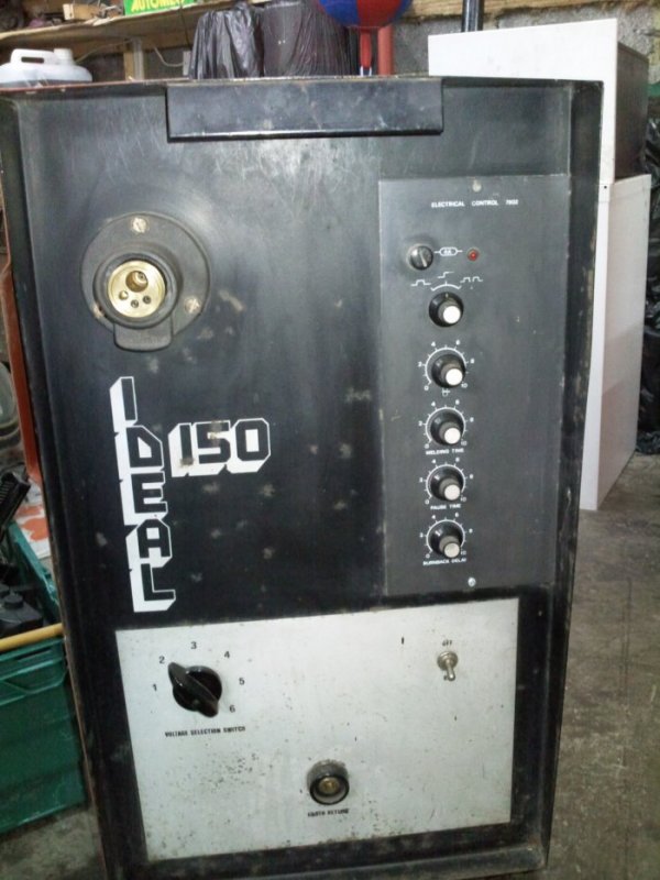

mike 109444 Member Messages 4,835 Mar 19, 2014 #3 This is the 150 but should be much the same Photo sip ideal 150 b.jpg 78.6 KB · Views: 430 150 ideal.jpg 70.4 KB · Views: 445
