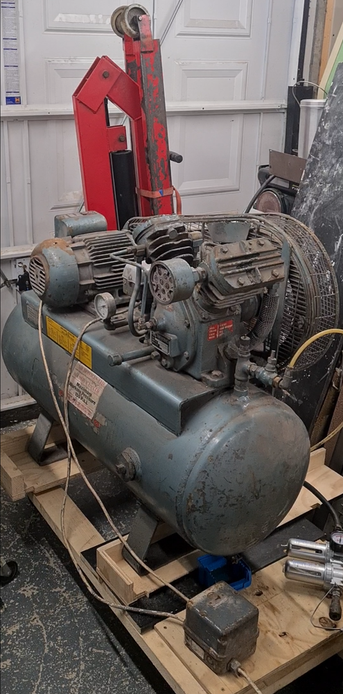

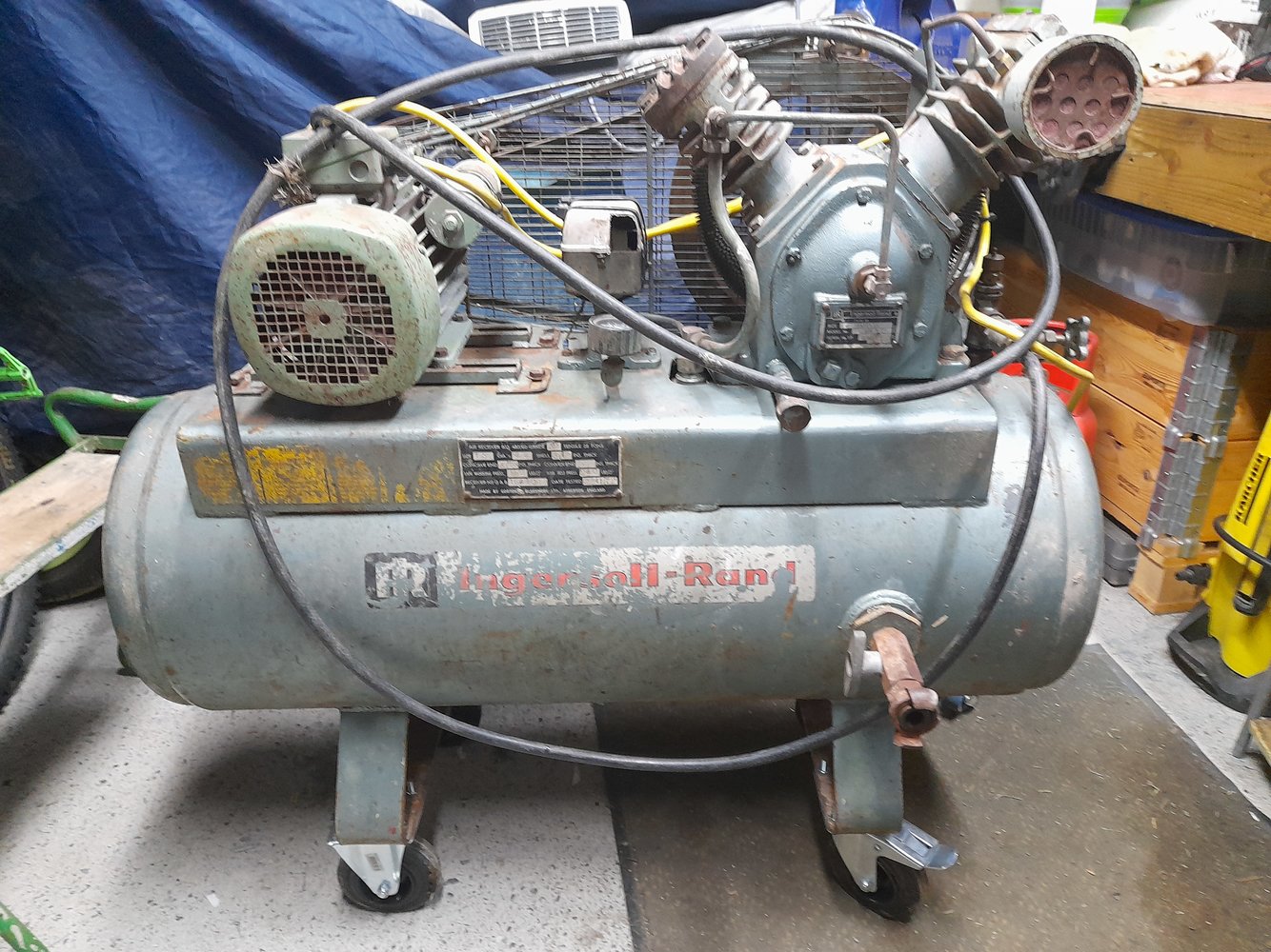

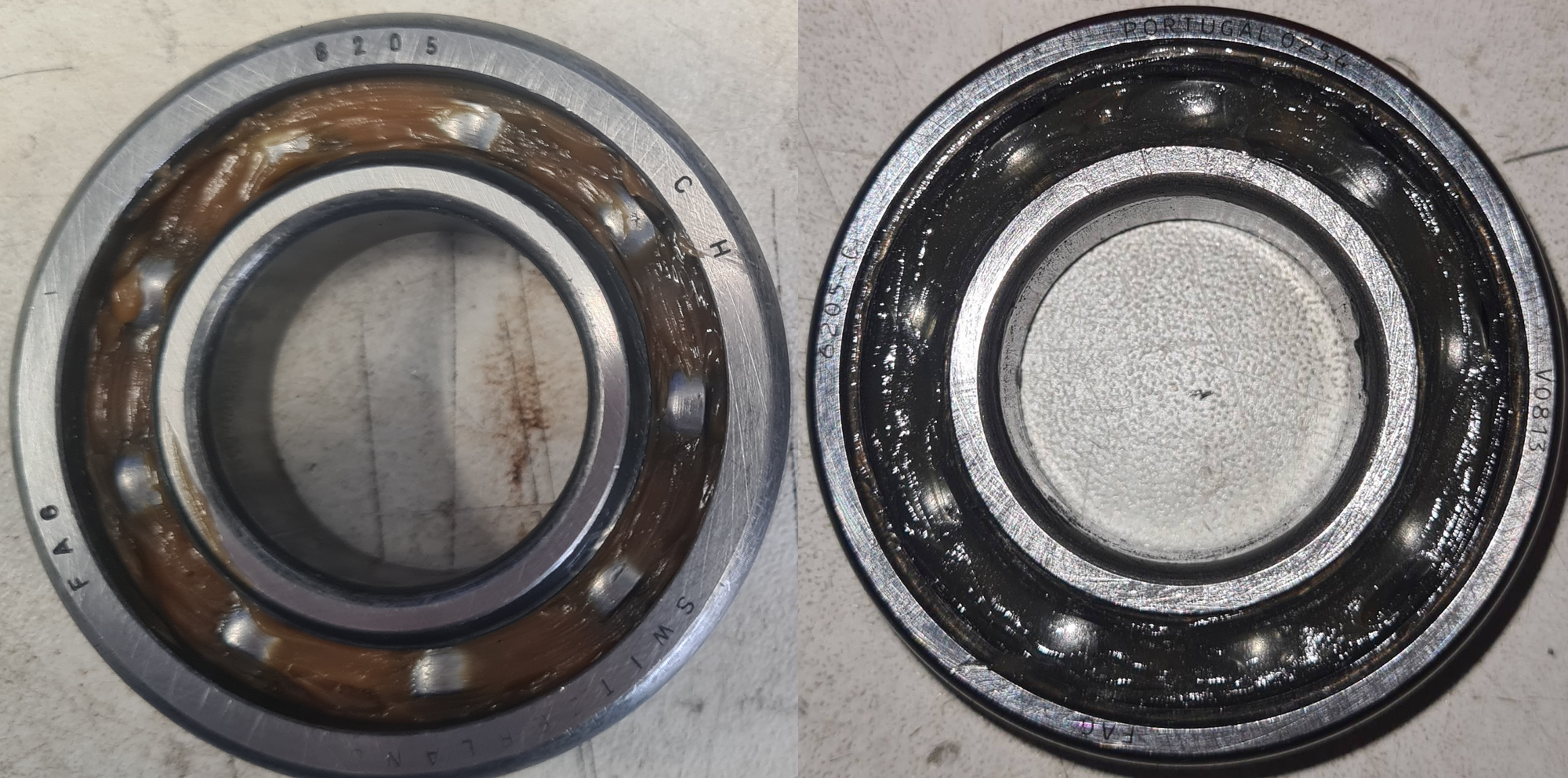

well that was fun.

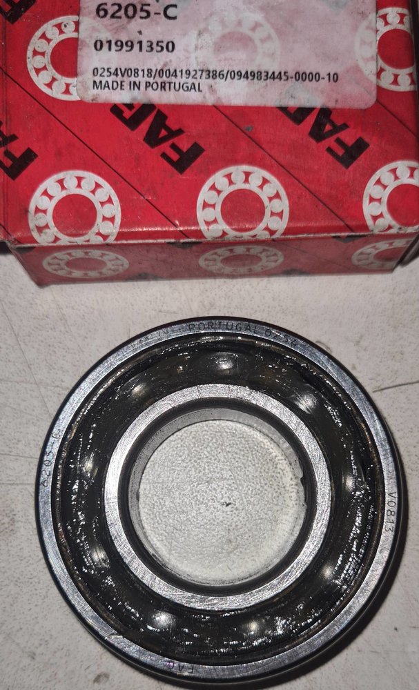

My first time changing bearings in an induction motor, i got 2 x FAG branded bearings from bearing boys, they stated 'German-made FAG brand' which is assumed was where they'd have been made.
i noticed the 6205 bearing had thinner sides to the outer and inner race, and i've just noticed where it was made... portugal... same as the one that failed, which i didn't want.

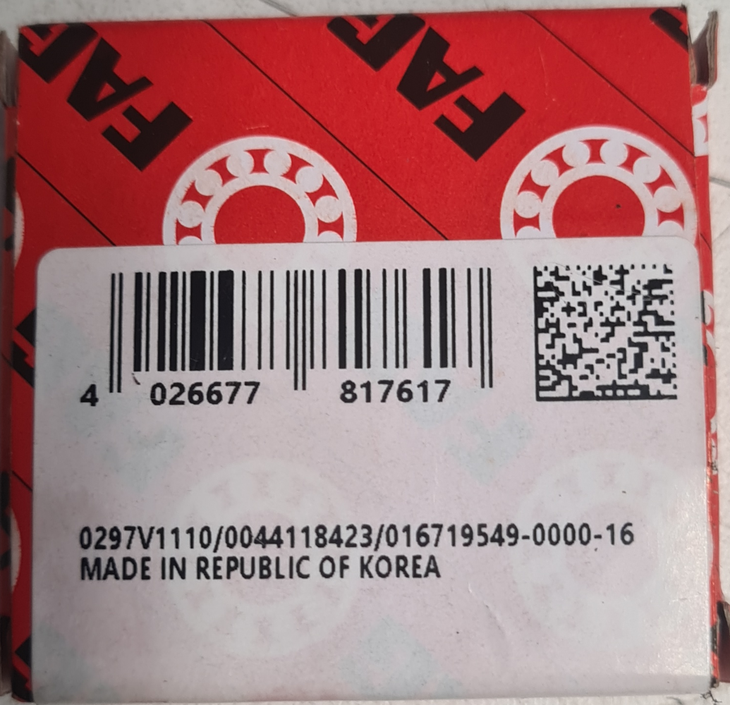

The 6203 looked the same as the one i took off (i will have to dig in the bin for the box tomorrow to see if this was a portugal made one too)
So i fitted the bearings, re-assembled the motor, and ran it up,
It ran quiet-ish for about 20 seconds then started making a noise as if something was catching, a regular ticking noise.
i took the motor apart and re-assembled it loads of times
I pushed more fresh grease into the bearing races, but not packing loads in the cups that the bearings sit in, as i know over greasing bearings can cause issues.
Each time i'd get about 20 seconds of quiet-ish running, then this noise ... similar to when you put a card in your bike spokes as a kid.
The bearings were seated properly, the 6205 end bell has a rubber washer in the cup the bearing sits in, making it impossible to overload it i think.
i put the rotor in the lathe and is was running true, nothing was showing as rubbing, no muck caught in the stator slots etc.
I finally figured out the noise was from a bearing by placing the end bells on the bearings each in turn whilst holding the bare rotor, and when i spun the drive side end bell i figured it was the 6205 bearing making the noise.
So i pulled it off the shaft and put the original back on (the 'made in Switzerland' one) re-assembled the motor and it's running quietly.
