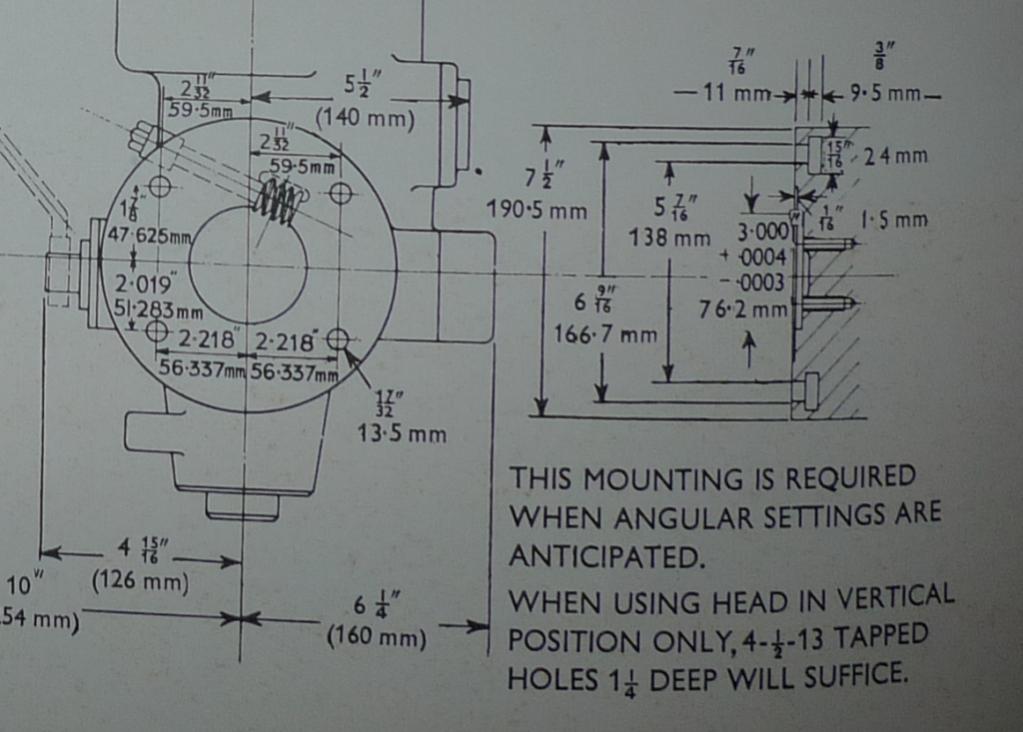

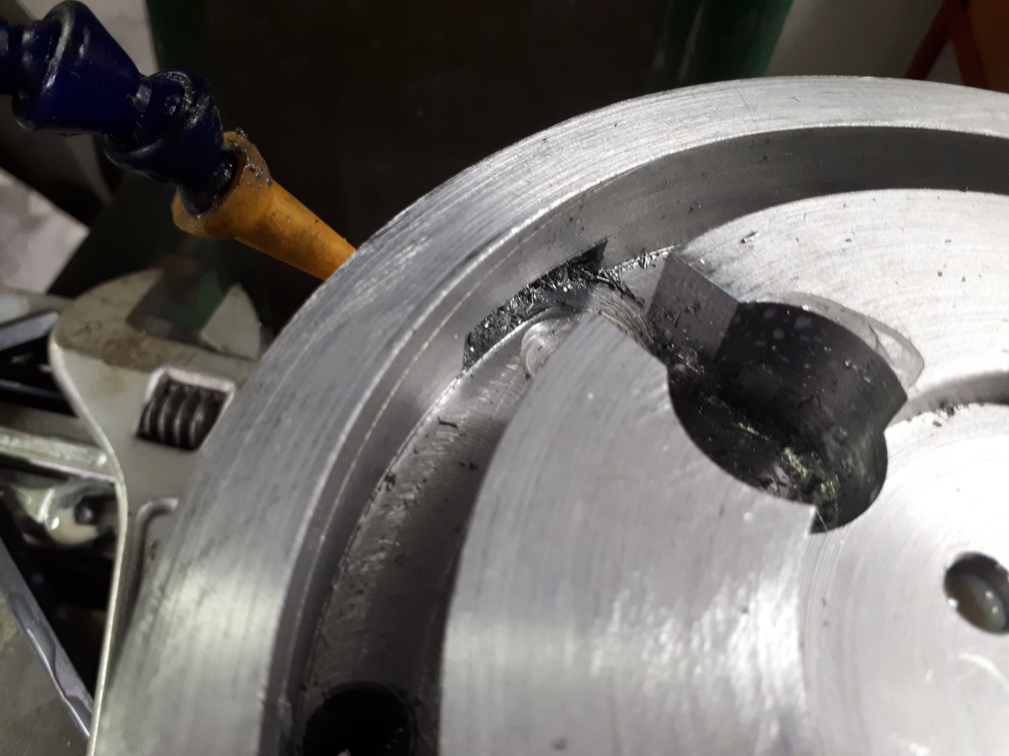

I am making up an adaptor to mount a Bridgeport milling head to my Tom Senior (pics below). Its nearly finished apart from the circular recess for the tee-nuts. I was going to use a woodruff key cutter to do this, tried it tonight and its a disaster.
Looks like i'll have to do it on the lathe, probably should have done that in the first place, but i did not have a tool to do it. Would anyone have a tool i could beg, borrow or buy to do this ? Doing my damnest to get this project done and dusted.
p.s. the cut i am attempting to make is the 15/16" or 24mm cut on the top of the drawing on the right hand side.
