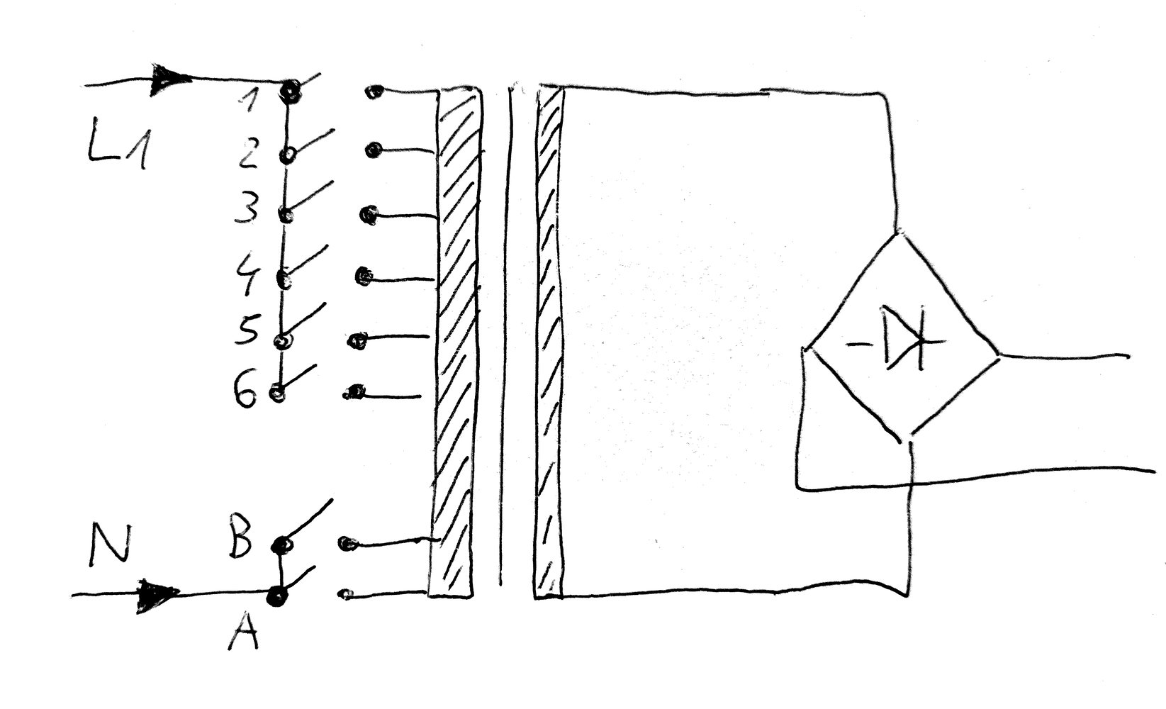

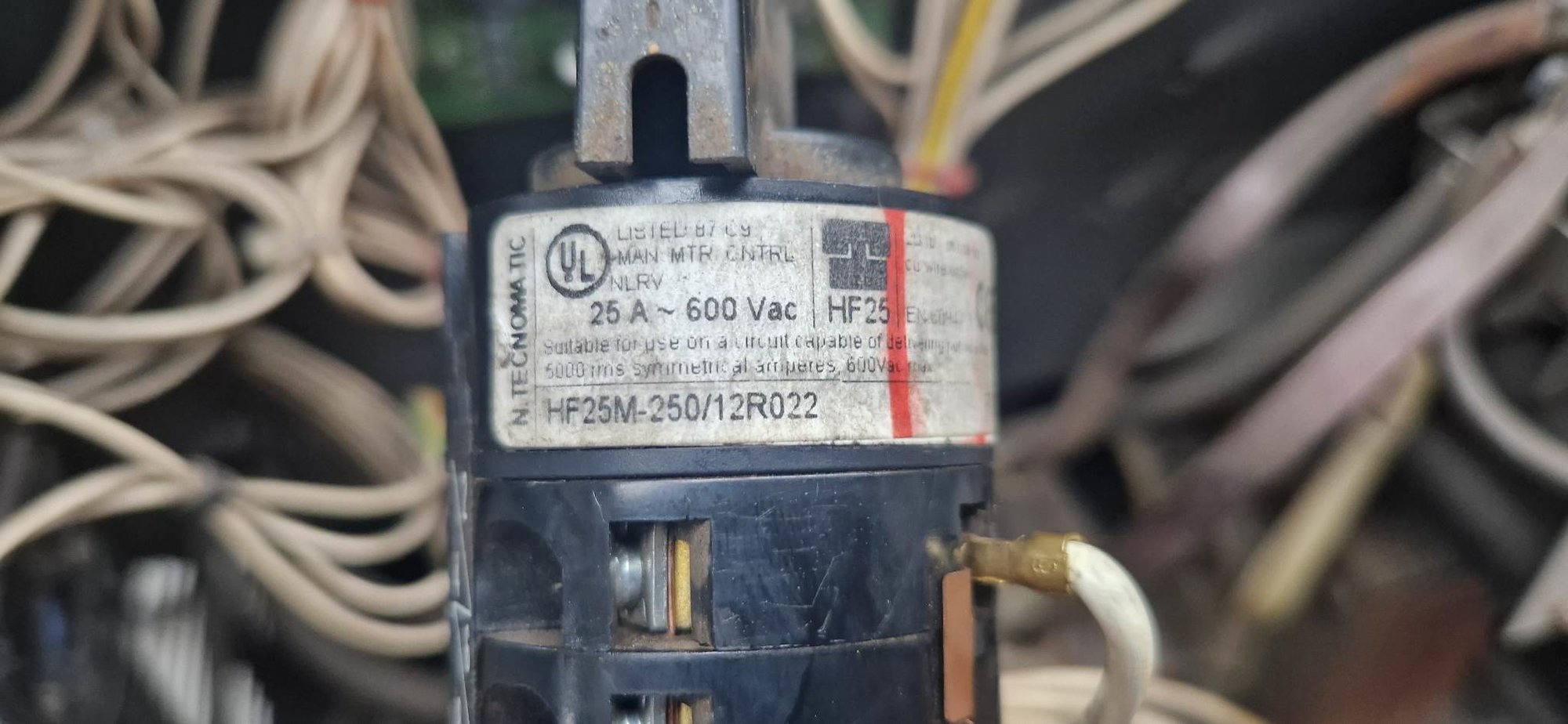

I have a migmag Butters AMT 271 to repair, a damaged range switch, I want to choose a new one.

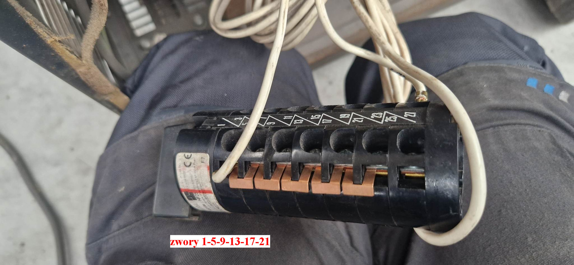

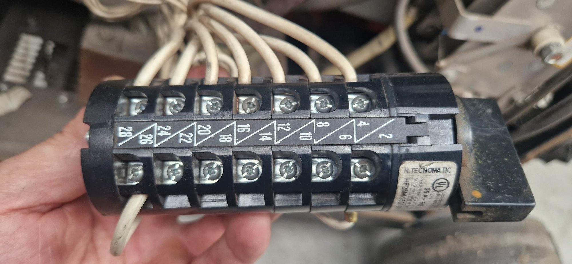

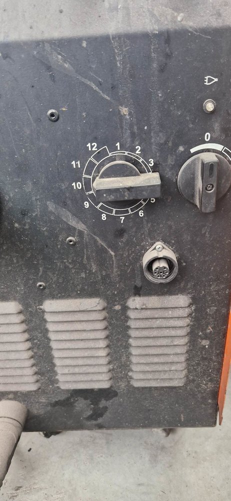

Butters has 12 ranges and from what you can see from the switch, there are only 8 wires (the migomat is still at my friend's, I have photos) it could be connected in this way:
(simplified scheme of course)
range 1 -- 1+A
range 2 -- 1+B
range 3 -- 2+A
range 4 -- 2+B
range 12 -- 6+B
Am I right? Or maybe someone has a wiring diagram for such or similar AMT migomat ( or switch)?
