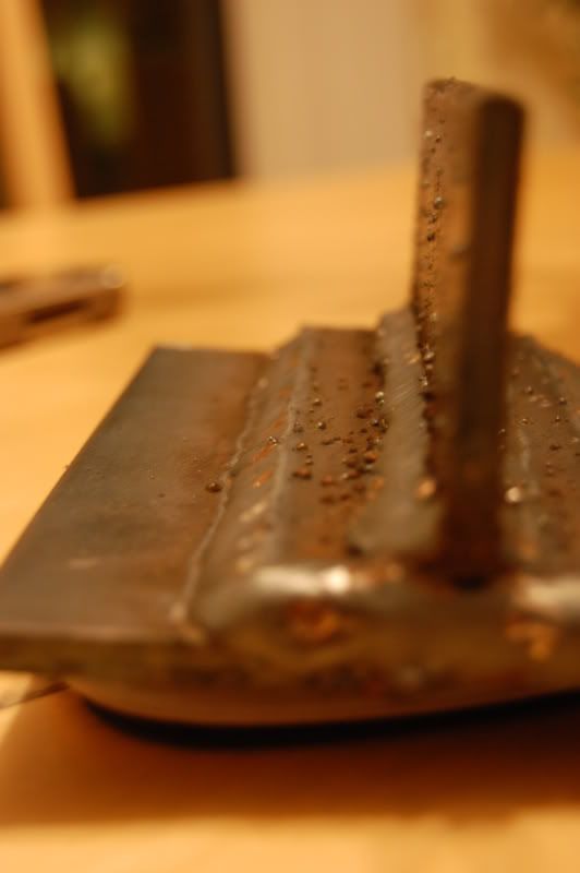

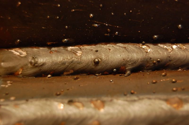

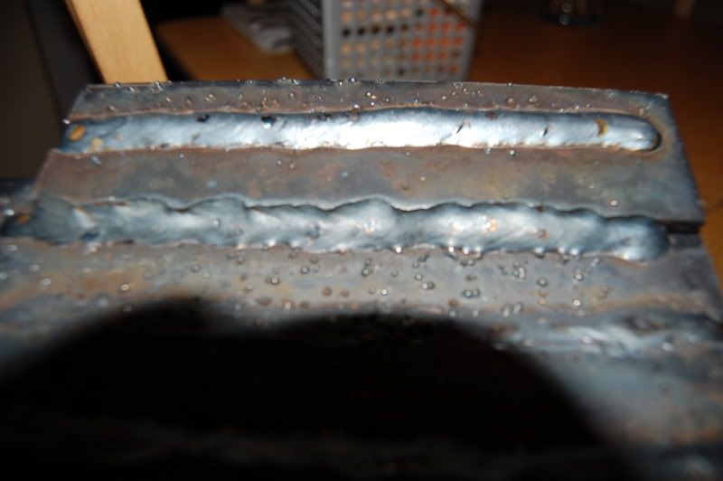

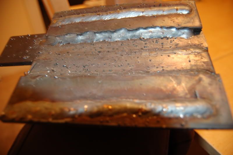

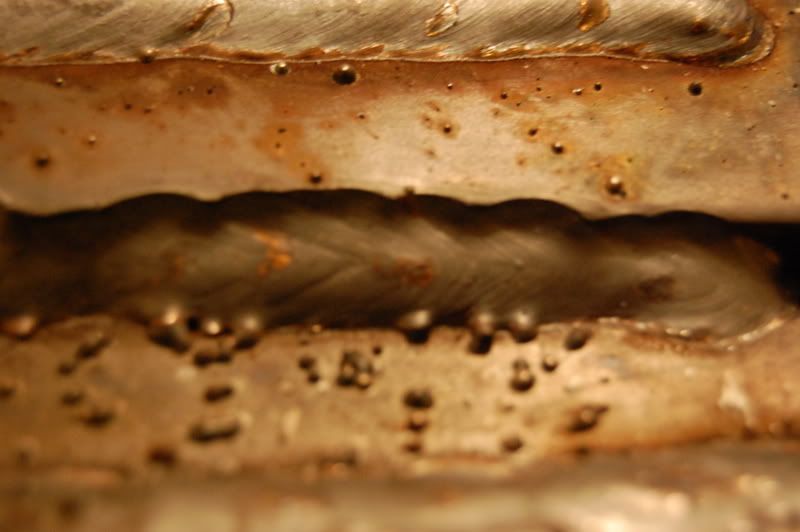

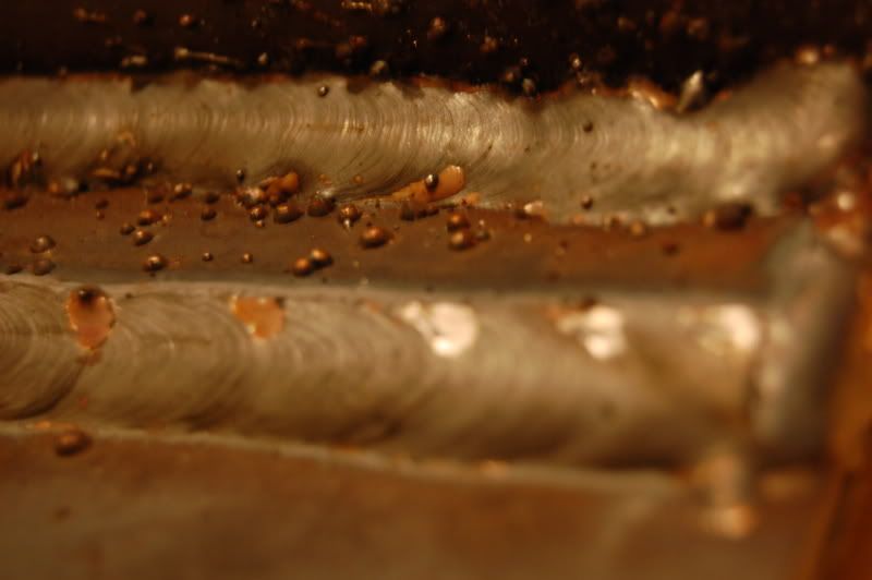

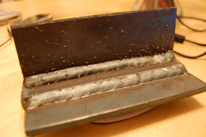

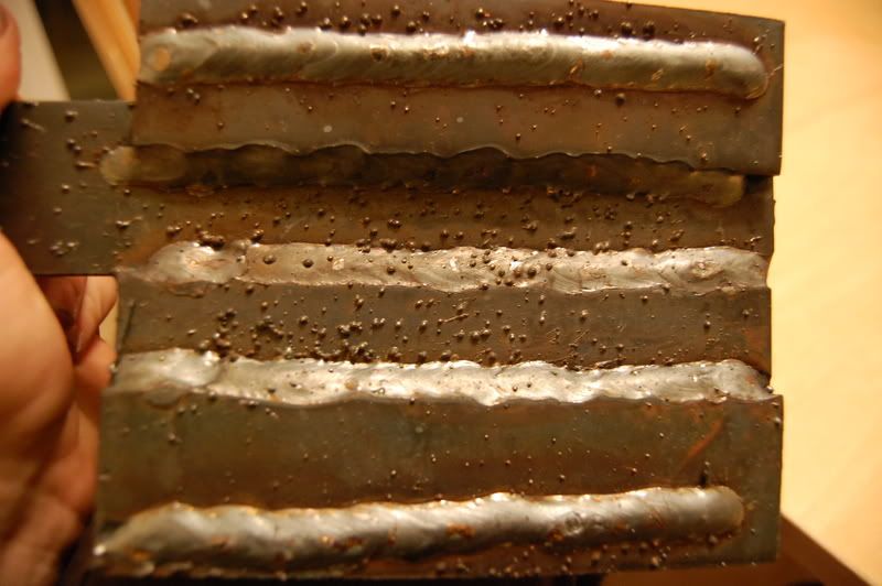

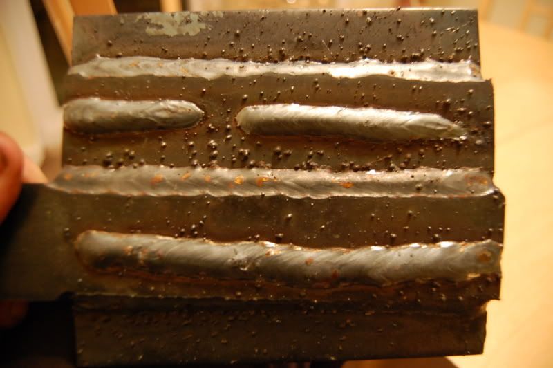

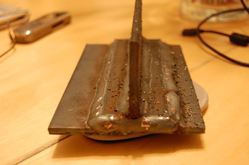

I'd try dropping the volts a bit. Looks like you're heading into globular transfer - it's that nasty region between dip transfer and spray-arc where you get spatter all over the place. If the machine was set for you, then someone doesn't know what they're doing (if i'm right). Take the machine down one or two volts, and adjust the wire feed to suit.
Also, if you're a bit wobbly, us both hands on the torch.
Looking good though.
