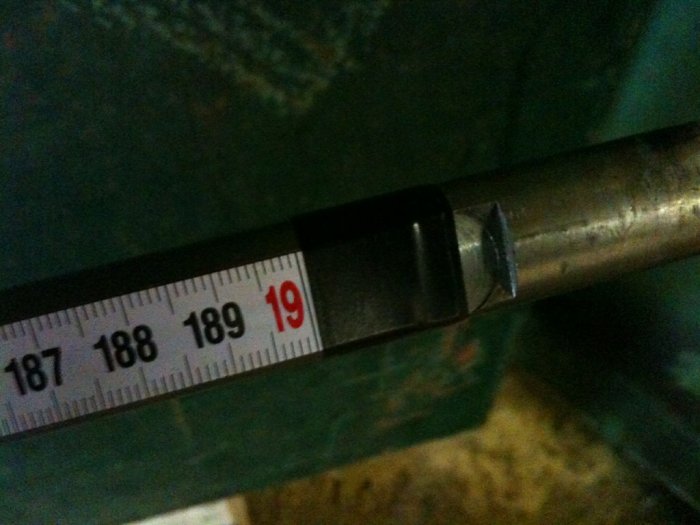

Evenin' all. Would love to pick your collective brains on the best way to go about making a flat along the length of a round bar. I have an 18mm bright bar of 1.5-2m in length and I require a flat of 12.5mm width along the length of it. A back-of-fag-packet calculation (which I now can't find) says I need to remove just over or under (can't remember which!) 2.5mm from the bar. For a shorter piece I'd stick it in the mill and take a slice off but obviously with a piece this long I won't be able to do it in one go this way. So has anyone got any bright ideas as to either how I'd do it some other way (without the mill) or how I can do it section at a time on the mill without the bar turning when I move it along. Hope that makes sense? It does to me! Cheers chaps.
I think if I clamp it straight to the bed rather than putting it in the vice I should be OK. It doesn't need to be super accurate as it's only to be a measuring stick/end stop for the cold saw. Just accurate enough that I won't be annoyed to see a wavy edge along it's length!
