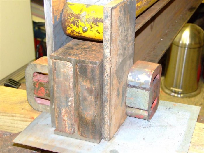

Making steady progress on my splitter project; despite my 9" grinder burning-out after only a couple of hours use (Lidl rubbish!

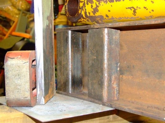

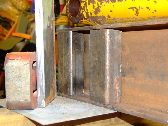

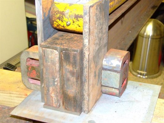

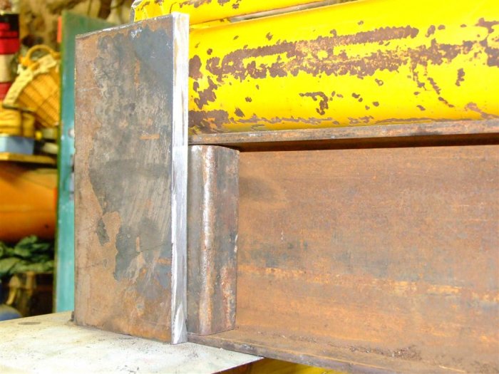

I`ve cut the parts for the fixed end of the hydraulic-ram: 4 x rectangle box sections cut and fitted to reinforce the web of the 'I' beam and two 15mm. thick plates (as yet to have the 44mm. holes bored for the ram mounting pin) to weld to the sides of them and where the 15 mm plates meet the caps of the I beam.....I hope the pictures explain better than that paragraph!
Questions: I want to weld the rectangle tubes first; where they contact the I beam web and caps, and then weld the plates on the outside of the whole.....I`m thinking about reducing distortions; I plan to tack-first and then weld in runs.....is there any particular (best) weld order/direction to minimise distortions: would it be better to balance the sides a weld-run at a time on each side?
Which size rods would be favourite (I have that BIG old 200 A 90/60 OCV Quasi-arc): I have 2.5 mm. and 3.2 mm. in 7018`s and 1.5 mm., 2.5 mm. and 3.2 mm. in 6013`s.
Do you think I`ve made the 'fit' of the rectangular tubes too tight (they are a light 'tap' fit); would they be better with a bevel ground on them all`round for better penetration?
Sorry to ask so many Q`s; bit of a beginner-girl with this 'heavy stuff'.
