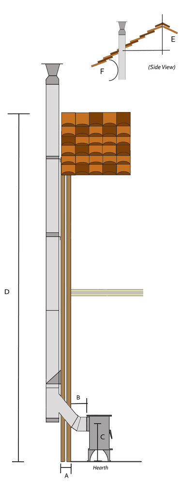

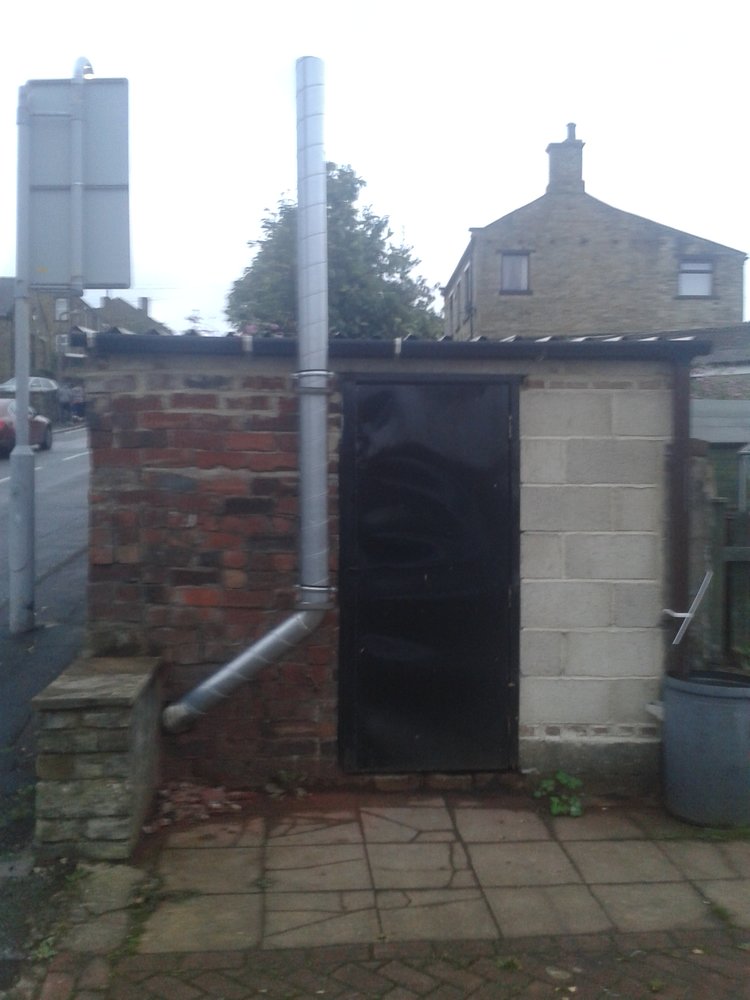

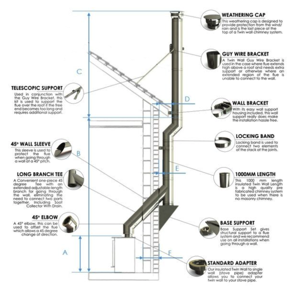

What's the best way to pass a rear (horizontal) exit 6" log burner flue through a cavity wall and out? Does it need a 45 degree bend then diagonally out through the wall and another 45 to put it upright to run up the outside wall? Best to use twin wall through the cavity? Can it be run horizontally through the wall and then connected to a 90 bend that goes straight up? The wall is probably about a foot from inside through the cavity to outside.
This is in a home workshop not the house.
