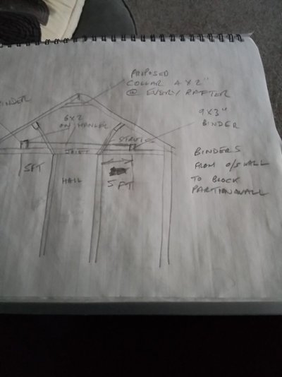

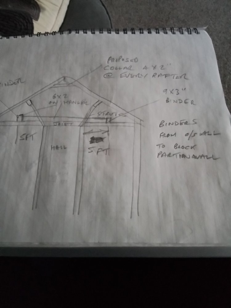

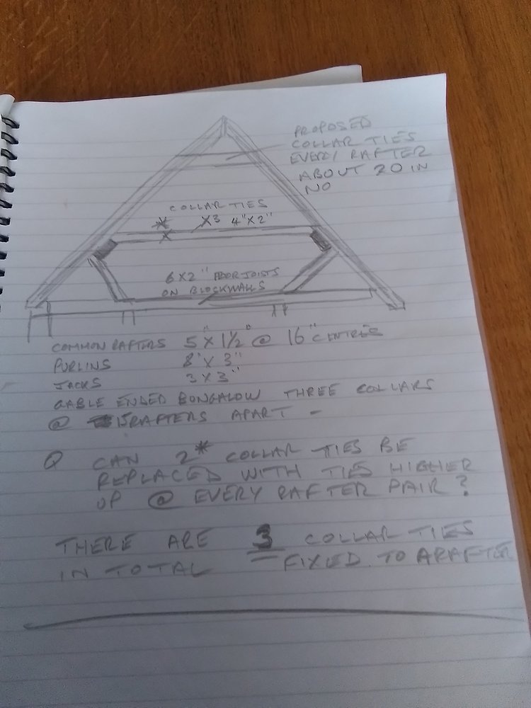

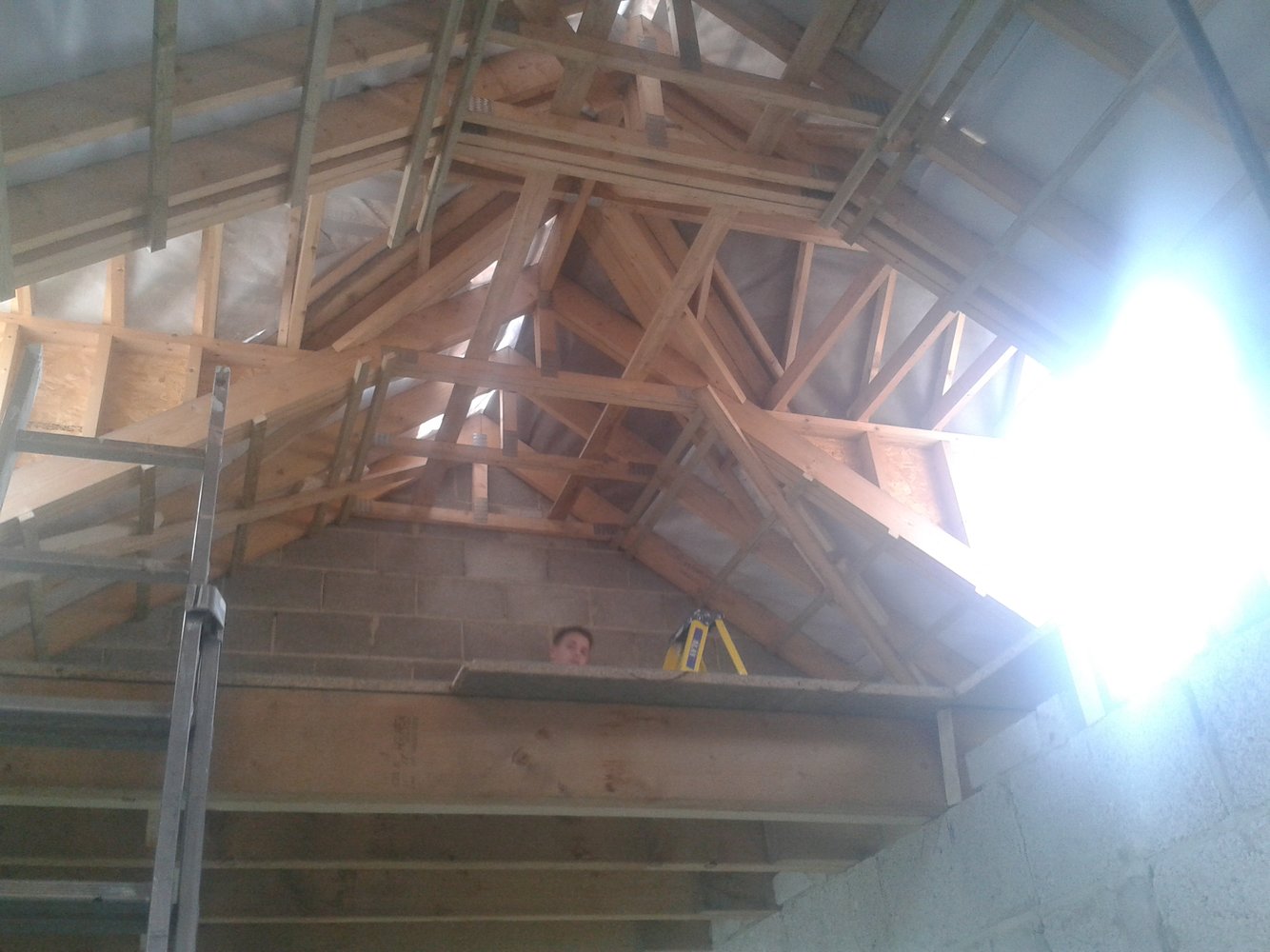

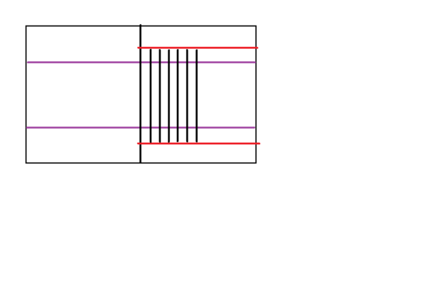

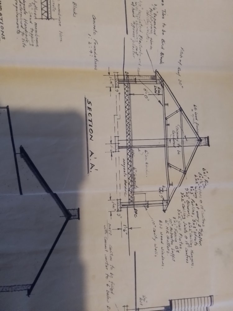

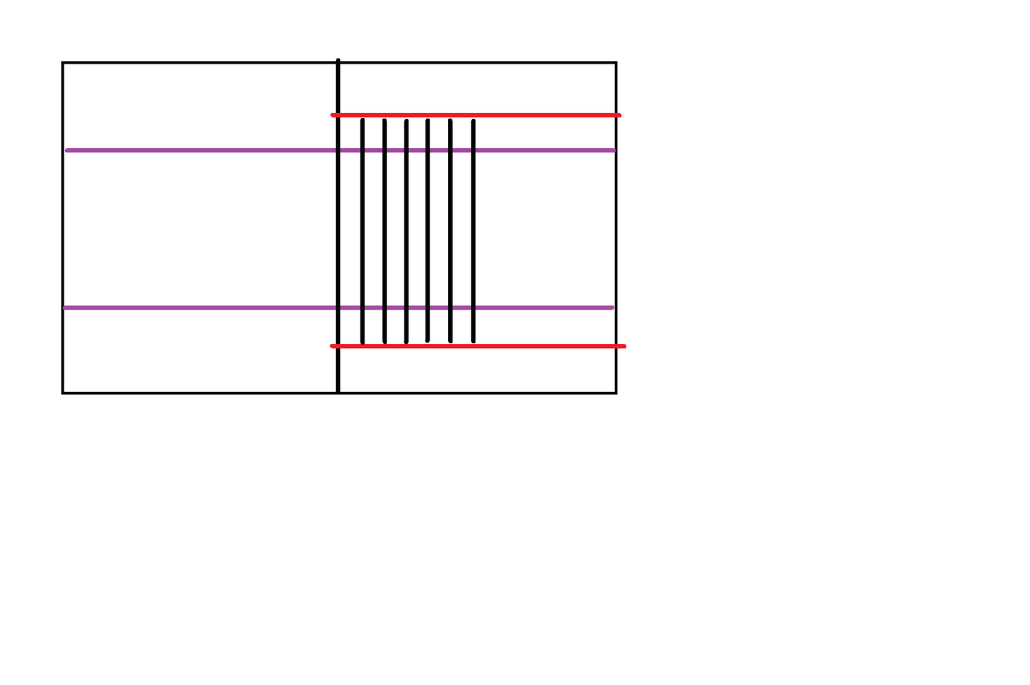

Hello again , bought a bungalow , it has a floored loft ,the floor is substantial and is hoisted with 6x2 timbers at 16 inch centres across the hallway walls , no more than 6ft clear span , I'm happy with that , however there was a poorly constructed room in the loft for a train set, to make space 2 of 3 collar ties were removed, these ran from purlin to purlin nailed only to a common rafter, thepurlins are 8x3 any the bungalow is about 36 ft long , no movement of the roof line can be seen internally or externally, I have replaced one tie and soon to replace the other , I have also put 6 collar ties at 7ft high , the rafters are 5x1.5 ins at 16 inch centres , if I were to put in a 4x2 tie at every rafter over the area the originals were , some 20 plus collars would that be sufficient to enable the long collar ties to be removed ? , my sketch sort of shows it , in summary 20 shorter and higher collar ties to replace 2 longer lower ones ,
Cheers
