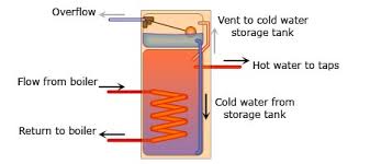

I'm in the process of fitting a wood burner with back boiler and a vented thermal store in the barn, it will need a 4 gallon expansion tank and my question is will a Polytank from Screwfix suffice or does it need to be GRP type tank to cope with the possible 100°C temperatures.
