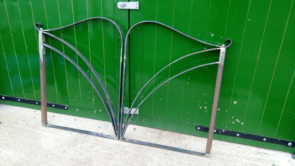

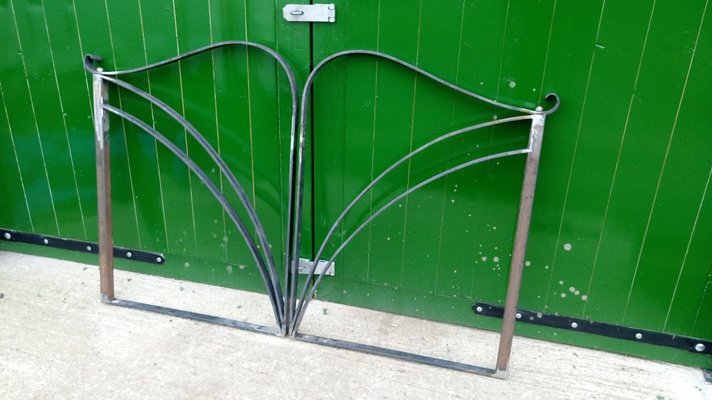

I'm making a pair of small garden gates that will go side by side, here's the outer frame and bracing bars of one of them. Vertical bars and ornate leafy scrolls to infill. Hinges will be fixed to the 40mm box section.

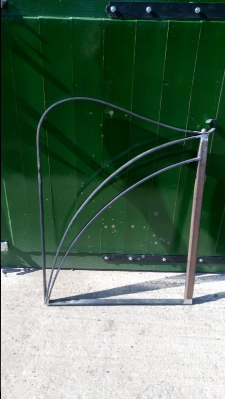

That blob on top of the scroll on the 40mm box is a M16 bolt I mutilated to make look like a rivet. I capped the 40mm box with a piece of 8mm plate that I pre drilled a 16mm hole in, and welded a M16 nut welded to the underside, so the bolt/rivet screws down into the top of the 40mm box.
As there was still a smidge of movement in the top bar/scroll I ran a very discreet line of weld under where the scroll rolls up, completely locking it in place to the 40mm box. I want to be sure that bolt has no way of ever wriggleing free, (even though I know it won't left as is, and getting zinc flame sprayed will probably glue it in position anyway, but I'm a worryer...), I don't want to tack weld the bolt head to the scroll.
I've never used Loctite, is it any good? I expect any gunk product will need air to make it set, so I guess I'll have to drill a hole or two in the 40mm box, then plug weld to fill & grind back smoothe?
Thanks in advance.
