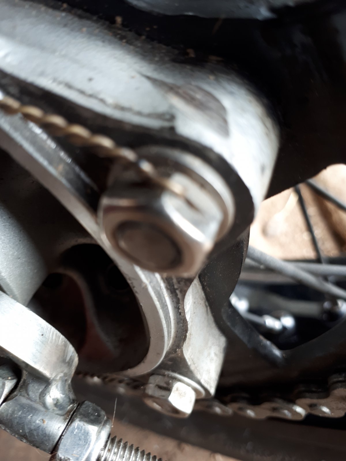

for all you fans that like to see lockwired nuts its a common practice for aero and motor racing applications ,i had a wee spark of genius
you know how difficult it is to drill through the hex of a nut with 1mm drill and after much broken drills and swearing you get there even with a jig (joke)
well take a hacksaw and cut into the peak of the hex say 2x the diam of wire used deep fuse a tack to bridge the top of said cut ,re file hex bingo it couldnt be simpler i ve been using this on 316 ss nuts of all sizes and it does not shrink them or weaken them ,would be cautious on high tensile carbon stuff as it might affect heat treatment but for sump plugs etc it will be no problem as they are usualy made of mild steel
