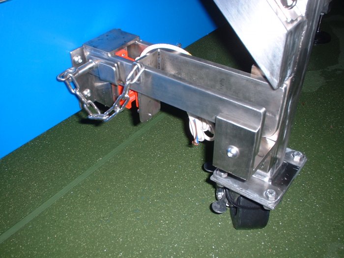

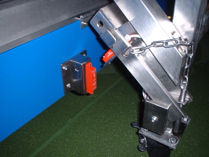

Yesterdays little job,

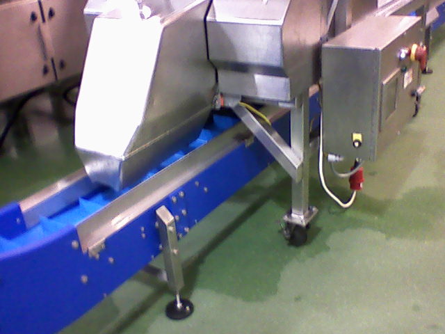

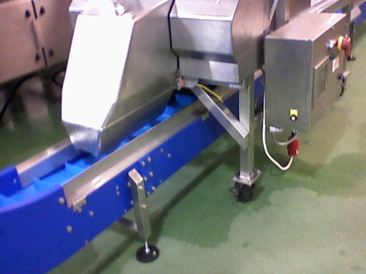

This is a Dicer sitting over the top of a conveyor, when its running it likes to wander about, and the product from the chute can be lost on the floor, also the position is quite critical to other machines feeding it.

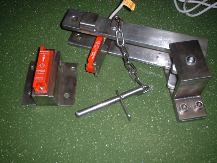

So Design and make a bracket that can be used without tools, and will incorporate an electrical interlock, so if things aren't in the right position the machinery wont run,
The dicer is used in 2 locations on the conveyor, simple hook for the chain holds the arm up while its moved.
And this is it in its working position
