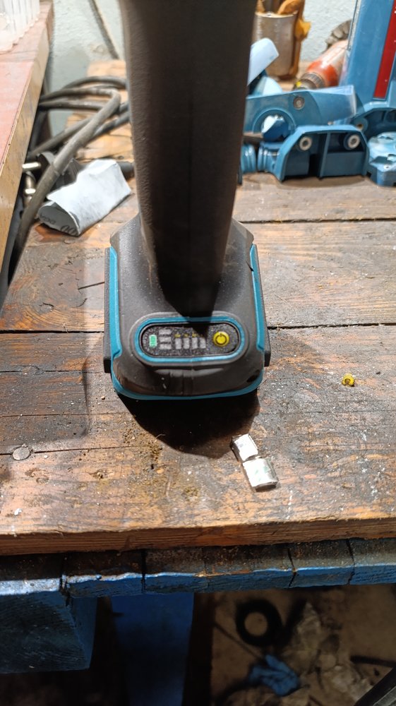

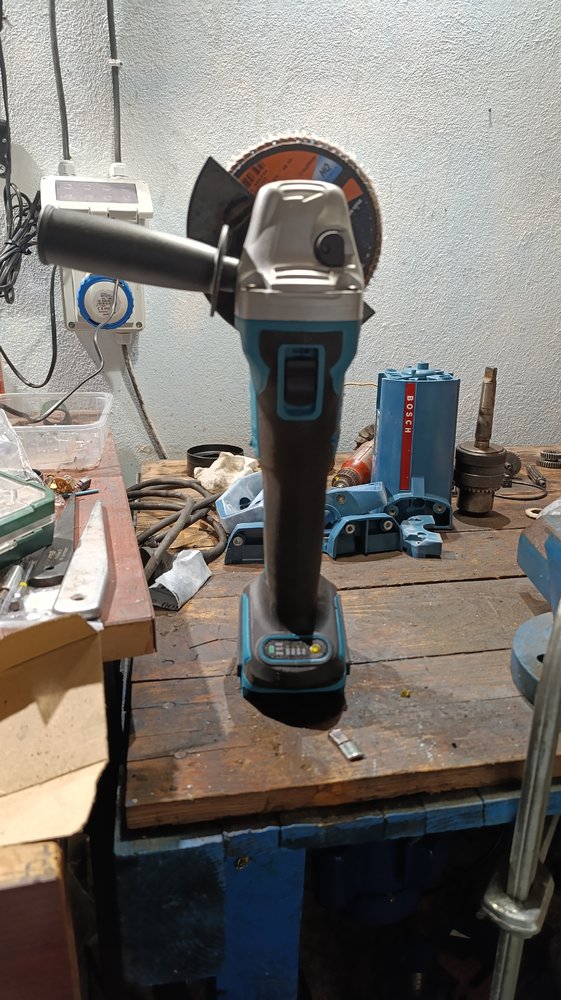

Now the grinder, this one... I have to be honest with you surprised me.
It's small light weight feels like a toy (I'm used to use 1700W 125mm grinders).
It looks very Makita like to the eyes but obviously with no brand on it and the distinctive clone feature of all of them.
So no cooling vent covers and flimsy accessories like handle and guard which is not toolless and very thin but it does its job

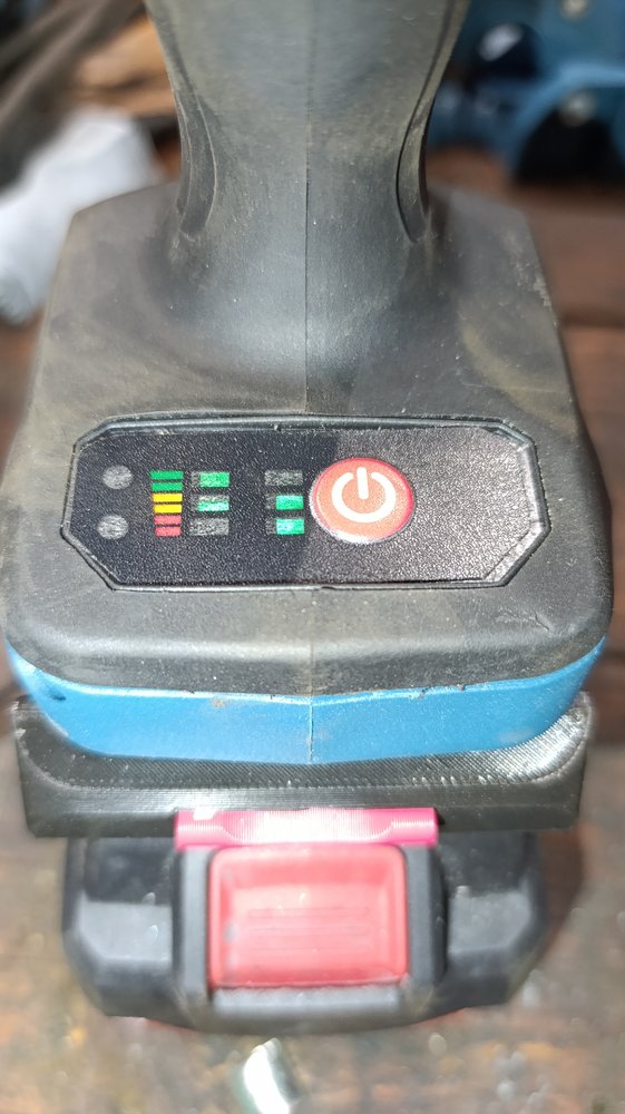

Similar control panel as the impact.
So battery level, and 4 speeds selectable using the yellow button while the grinder is turned on.
Data sticker says
LLD lithium battery angle grinder
125mm 9000 RPM
Max torque 20-30Nm which may be close because it's always a brushless DC motor with a gear reduction (pinion and bevel gear )
I've tested it by modifying a socket for a job.
I didn't stalled it, not even tried, I've just used it normally like a corded one.
It didn't seem to me it was under stress and worked fine both cutting and grinding.
Off course it was a quick job but I felt no noticeable lack of power.
I've put some grease in the gearbox and I'll disassemble it to open up the cooling ports by cutting the excessive plastic burrs from the molding

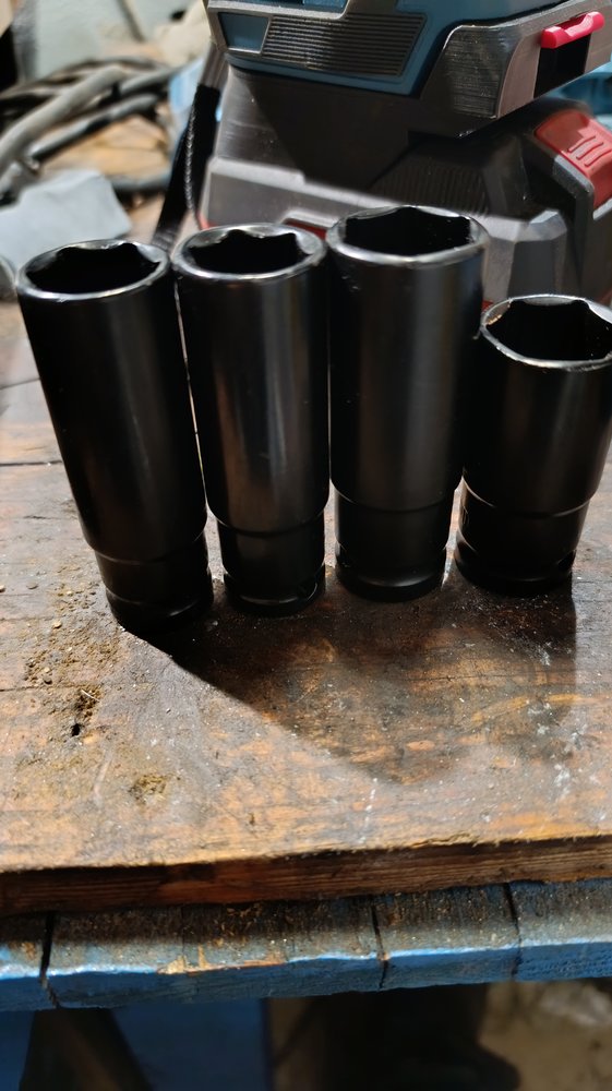

those sockets were included with the set, they feel cheap but they are heavy compared to normal sockets but they still are not comparable to real impact ones
18-19-21-22mm

In the pictures you can see I'm using 4Ah Parkside batteries and an adapter.
Honestly this setup works fine, I'm curious to see if genuine Makita 6Ah batteries would make any difference but I think I might get another adapter and few other Lidl batteries as it's convenient and cost effective for my needs .
