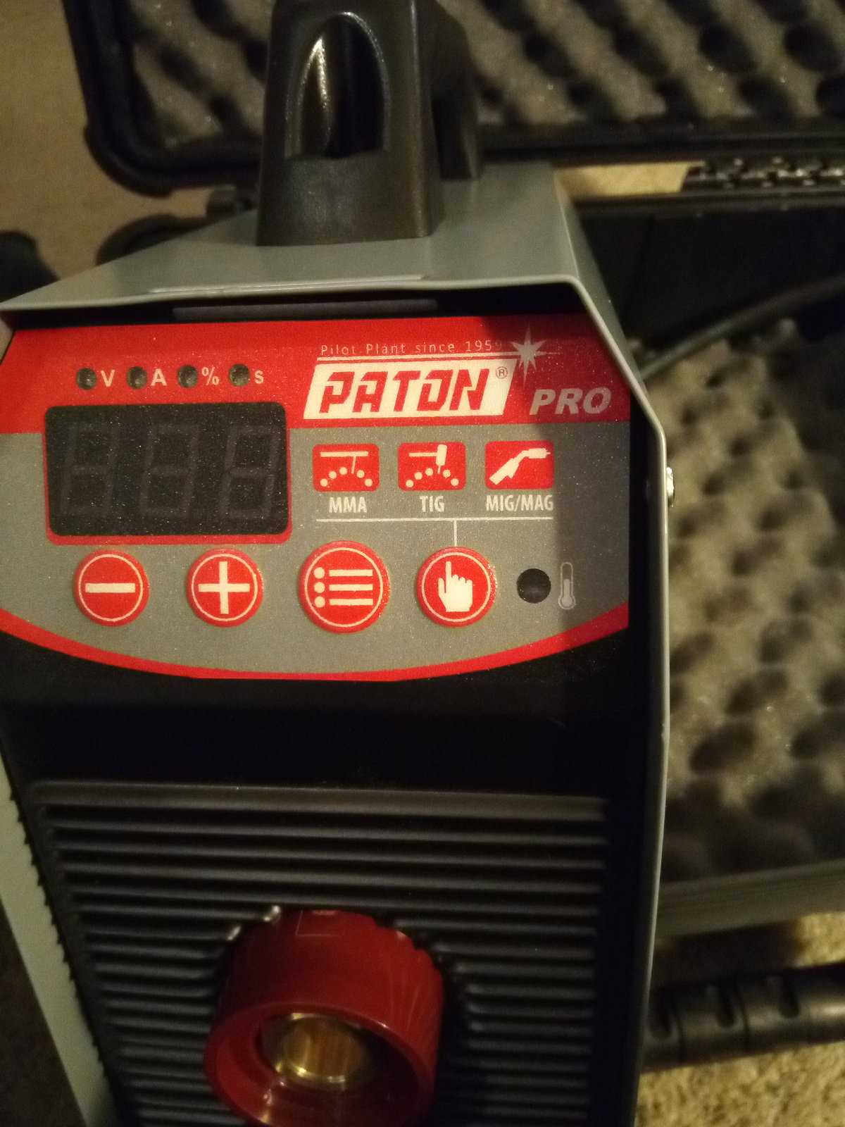

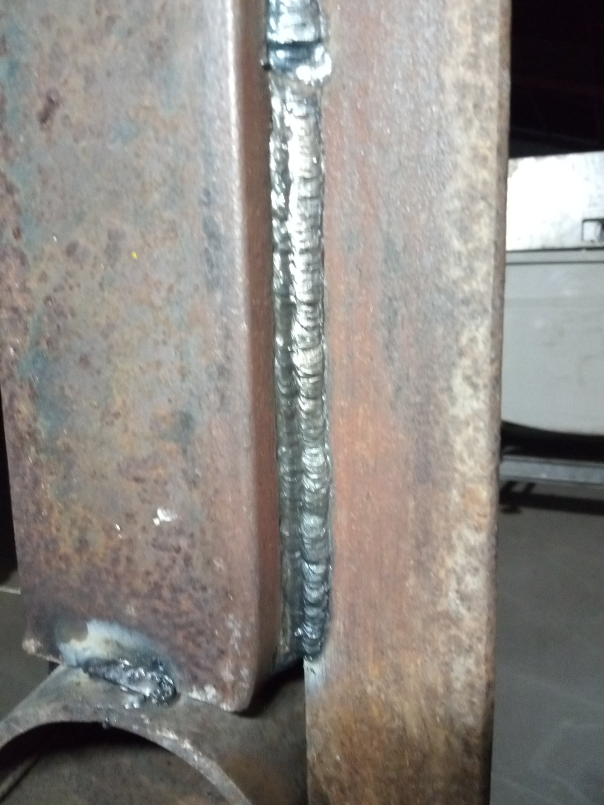

After much thinking and a little demo of a few welders over the few months I recently brought the machine called a Paton its a multi process 250 amp single phase machine here is a little pic of a vertical up practice using 3.2 super 6 damp rods could not be bothered to turn the rod oven on it runs hotter then the ta and no arc force
1st pass in at 113 amps
2nd two passes in at 109 amps
