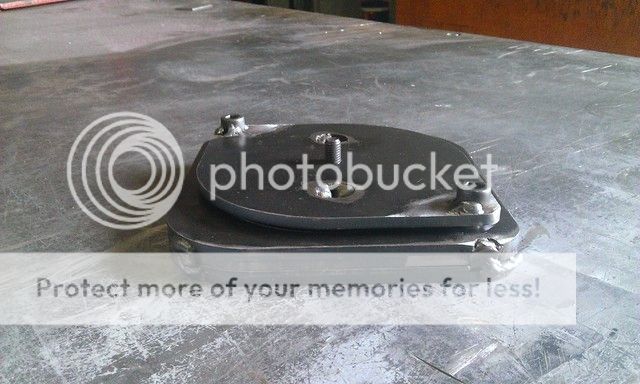

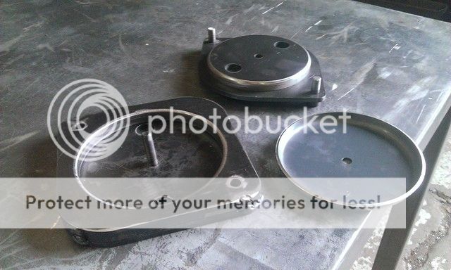

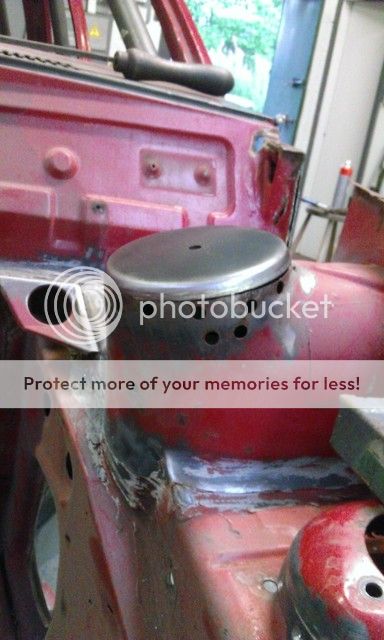

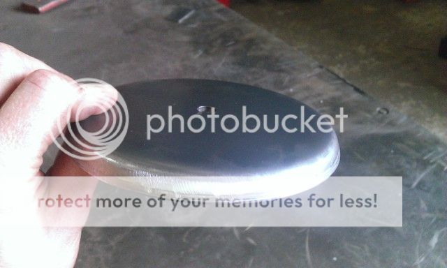

I wanted to have some dome tops to go on my front struts on my project car so fired up the laser at work and cut a couple of bits of 6mm mild and welded them together to make a punch and die. sounds a little easier than it actually was but you get the idea
well happy with the end result
the finished ones will have a bigger hole in the middle for me to fit a alloy top mount
