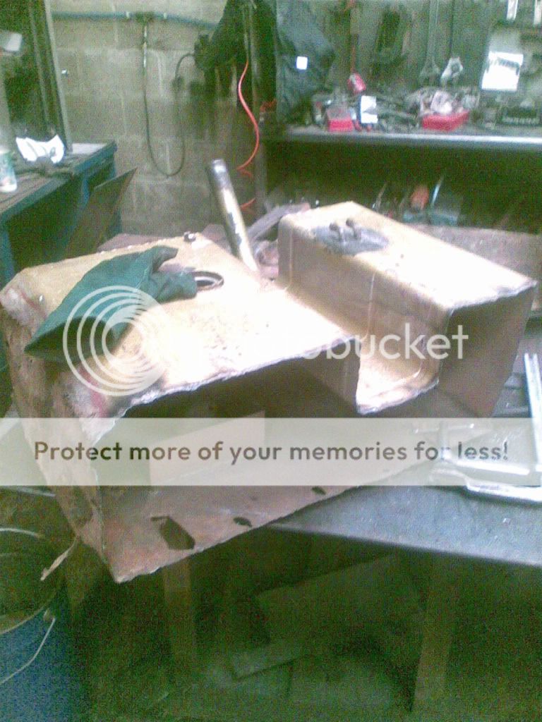

well my lwb fuel tank was well and truly ******ed rotted out between the doubleskin underneath so rather than spend a few hundreds which i cant right now thought id build a new one, heres the pics of so far. and how im doing it, this is bye no means probly the right way but anyway here goes.
start off with old fuel tank, remove under side skid pan, this is the only bit i want

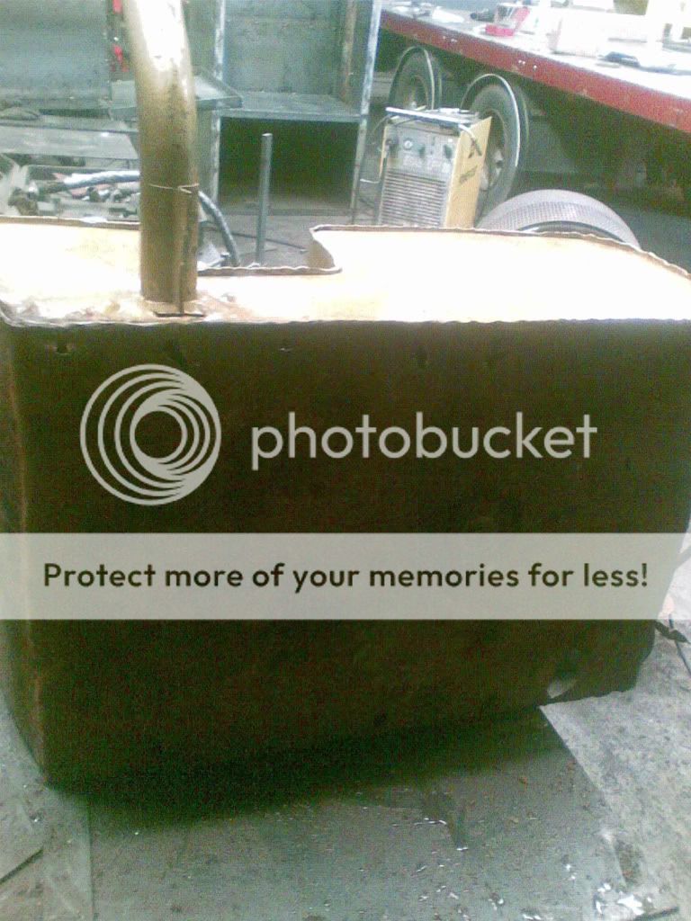

then your left with 2 bits, the tank and the second skin skid pan, heres the ******ed tank.
then plasma cut roughly the side of tank out to make rough template, this also shows the baffle
